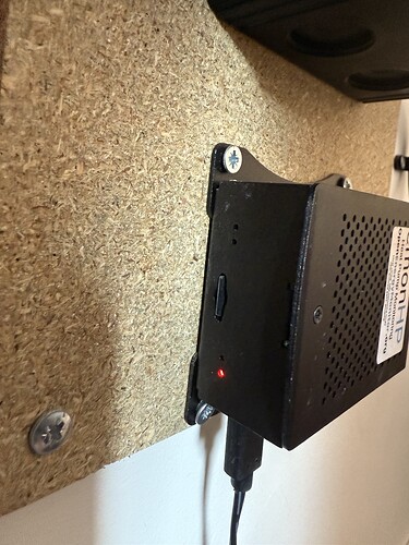

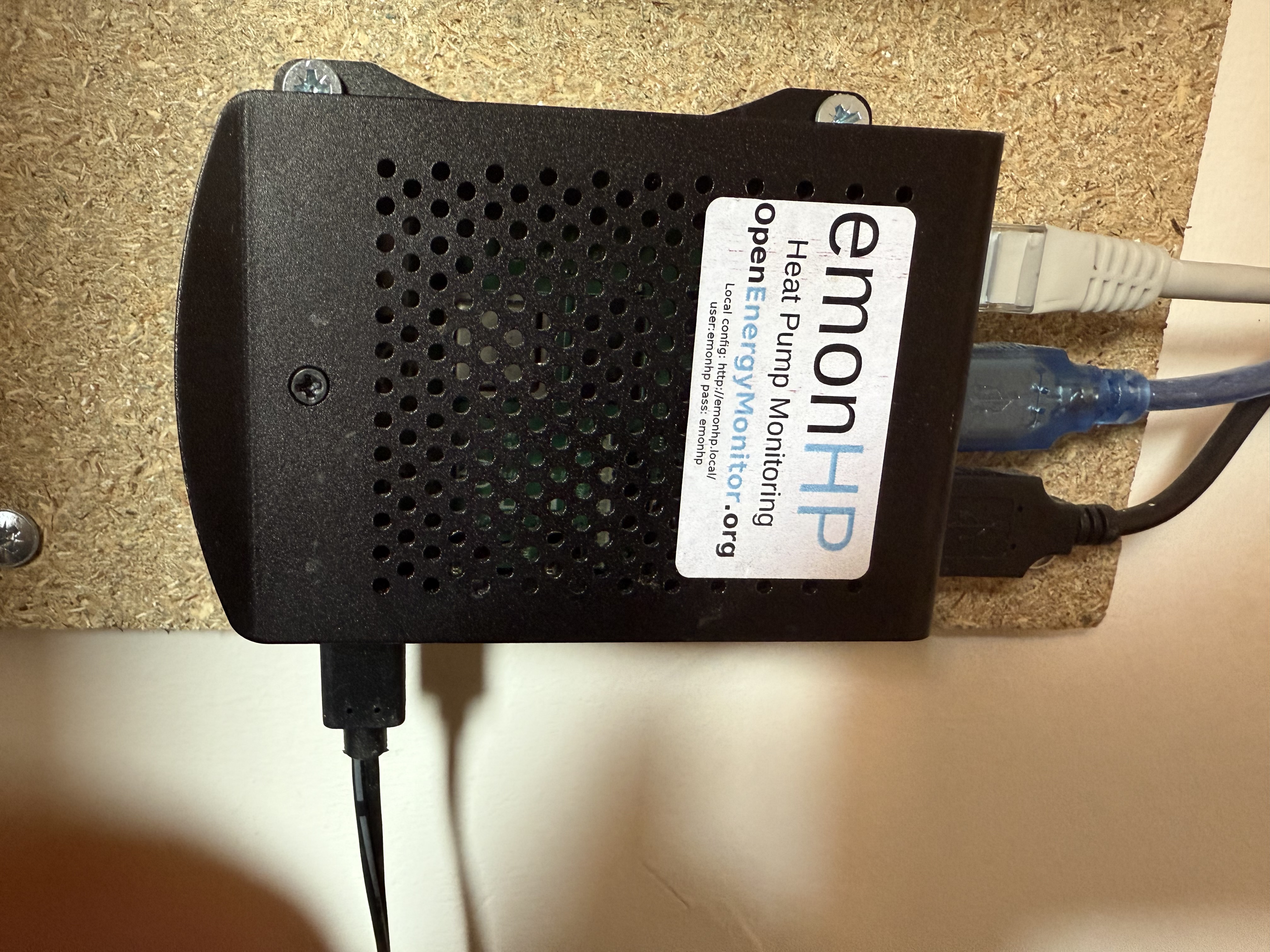

It would have been most helpful if you had said right at the beginning that it was in fact a heat pump monitor.
A heat pump monitor yes with a local IP address in the range of my DHCP allocations
It is easier I find to configure the router to allocate the same address to the pi; I have quite a few static addresses on my network allocated via my Draytek router.
The Heatpump Monitor has a different password to the standard emonPi/emonCMS, because on-line support is included in the purchase price. Your password should be on the printed sheet that came with the Heatpump Monitor.
I gather not every make/model of router allows this.
The IP address is assigned by DHCP via the router, rather than set a static IP it’s best to reserve / pin the assigned IP address. This can be done via the routers web config. Every router should have this function.
Please email the shop to obtain the SSH password for your unit. Although connecting via SSH is not required to do this: [email protected]
