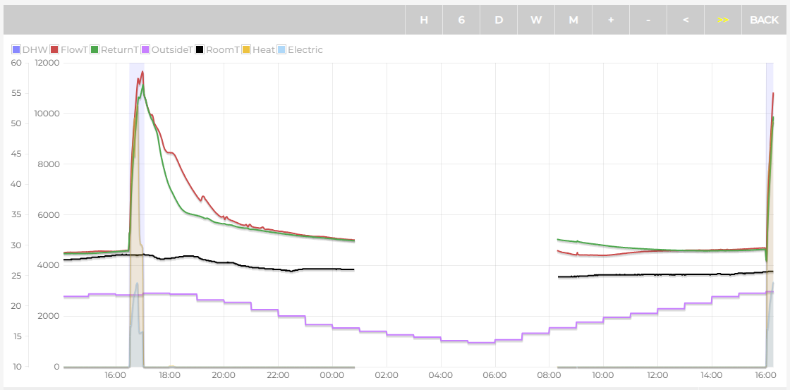

Periodically, my emonHP either hangs or loses contact with the remote site. Here’s a recent example. When I spot this, I power-cycle the emonHP and it picks up. Any ideas?

It is WiFi. Nothing else dropped out including the Grant itself to ecoNet sitting right beside it.
It has happened twice now: between July 5 and July 7 (I wasn’t watching closely enough then) and from about midnight on July 19 (I spotted that the next morning).
Id is 1205.

Ah ok, I’ve had a look at the data. The WiFi signal strength is poor, it’s reporting only -73dBm. This will be the issue, the WiFi is occasionally dropping. I would recommend trying to hard-wire it via Ethernet, or using a power line Ethernet extender to hard-wire without having to run a cable:
