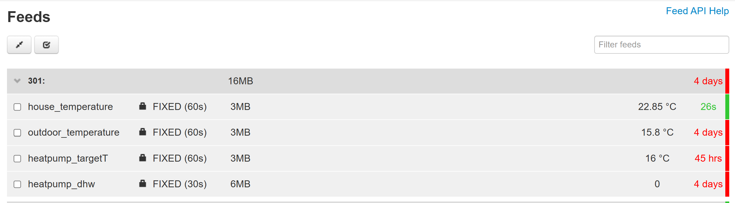

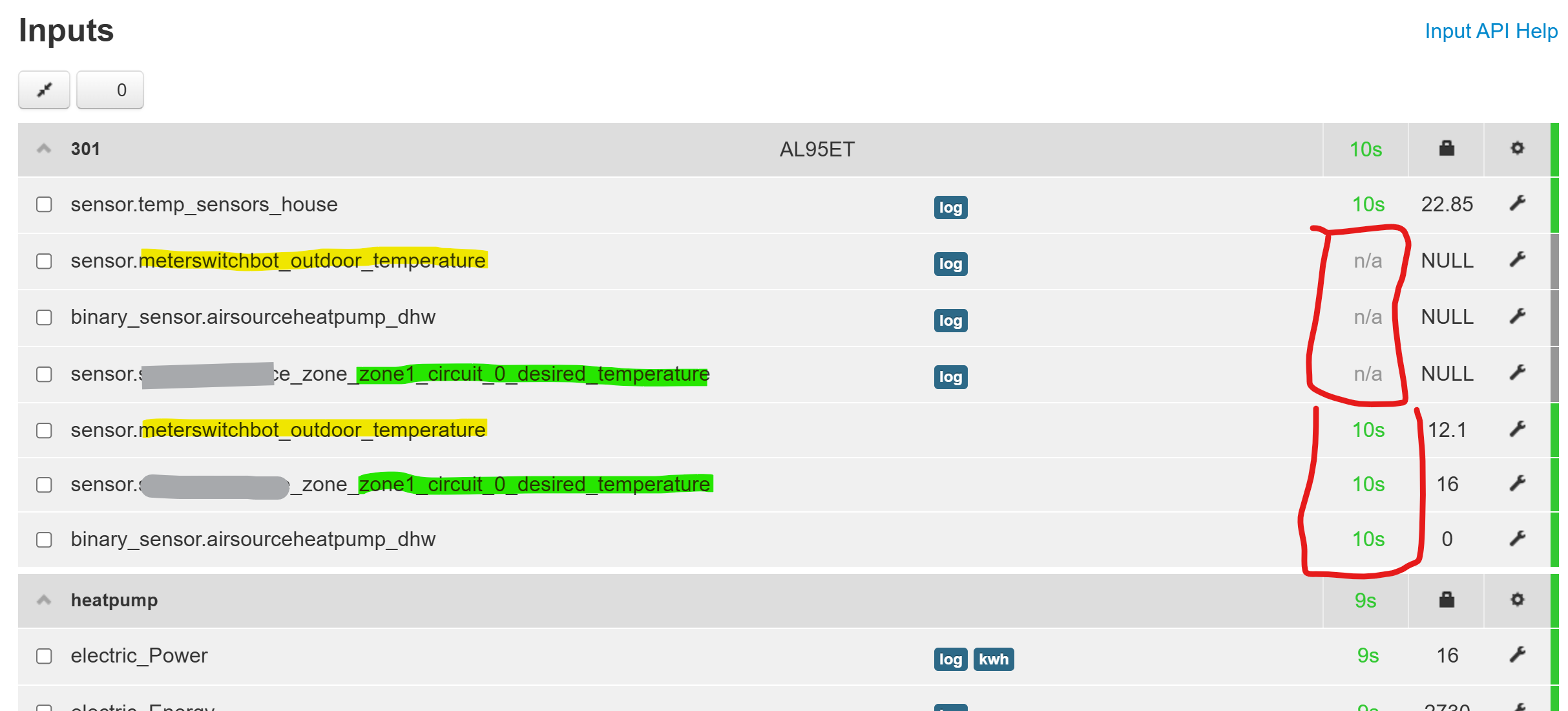

No idea what’s happened here and grateful of any ideas on how to fix it.
I think it is the consequence of a recent HA update.
The bottom three inputs are new. The top one has not been duplicated and is still mapped through to the feed fine.
I think I have sorted it. Clicked on the spanner icon for the three that did not have the log icon and used the ‘add to process’ dialog to associate them with the existing feeds. Then I deleted the original three that became ‘n/a’. Here’s hoping I haven’t lost any data.
… go nowhere. The value just sits there until another comes in and updates it, but until you log the data to a feed, nothing at all happens, it is not used anywhere. If you add process steps, then these are executed, but unless there is at least one “Log to feed” or an implied “Log to feed” where you have a step which writes to a feed, e.g. “Power to kWh”, the data is never used or saved.
So unfortunately, your screenshot shows no data has been received recently by the upper 3 inputs, so from the time the data was more than 10 s old on those inputs until you added logging on the 3 lower inputs, all the data has been lost.
I did not make any changes to my Emoncms History YAML configuration and the three new inputs appear to have identical names to the original three. I wonder what changed in HA to cause my local Emoncms to create new inputs?
I can’t answer that one, sorry.
The new names must have looked different to the machine even though they appear the same to us. (Or possibly more accurately, by the time the name makes it to the Inputs page, it’s presented the same.)

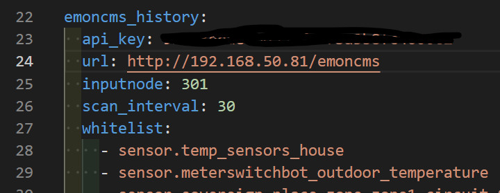

In the HA configuration for the integration, I am just specifying the following URL:
Emoncms History - Home Assistant
I have had a quick nose at the GitHub repo but cannot spot where it may be appending the /input/post API path you mention. Maybe the code owner @alexandrecuer can confirm?
