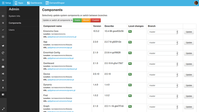

Switching to the Emoncms master branch
To test the above you need to be on the master branch of each associated emoncms module. It is now possible to switch branches using the new emoncms component manager accessible from the emoncms admin page.
Navigate to Setup > Admin > Expand the Updates section > Click on Components:
To switch all branches to master click on the master button at the top of the components manager:
If you do not wish to be a tester of new features make sure that all components are on their stable branches :slight_smile:

Thanks @zag could you screenshot what you see for Emoncms core on the components page? It should be v10.5.3 with no local changes, does that map up to what you see? The error suggests it’s running slightly older code… I wonder if the update did not complete correctly?
Yep, I’m seeing 10.5.3 with no changes
Other than App, everything else shows as no local changes and master.
David
[edit] I remembered the last suggestion and . . . refreshed the page. It’s showing fine now.
