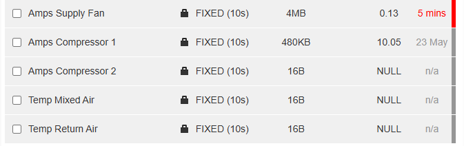

Here are the feeds in sync on the Local emonPi2
And here is what is showing in emonCMS.org. This has been active for the past 45 minutes without any change.
The one feed that did a partial update looks like it only updated two months of data and then stopped. None of the other feeds have any data in emoncms.org

O dear, Can you check the emoncms_sync service log for this system:

I am seeing a lot of timeout errors
