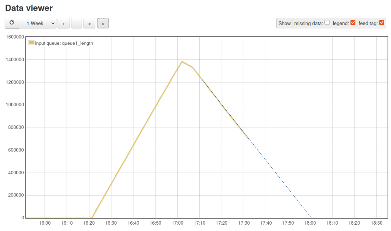

Data posted from devices will be stored in temporary queues to avoid data loss. You may notice the last updated time increase but there’s no need to check your device, the data will still be being received by the server, it will just be that queue processing has been paused.

Queues are working through slowly now, looks like about 46 mins until everything catches up:
The input processing queue is now back to normal.

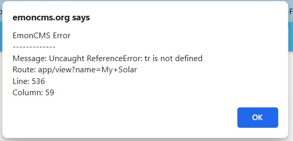

@TrystanLea Trystan - Following the update I’m getting an error when I try and load the solar app - screen shot below. When I close the error box, the app still doesn’t load - it just shows the rotating loading symbol.
Jez
Thanks @Jez is the error still present for you now? I’ve set it to force a browser cache reload on related javascript.
@TrystanLea- Yes, Solar App now working OK - great stuff :+1:
