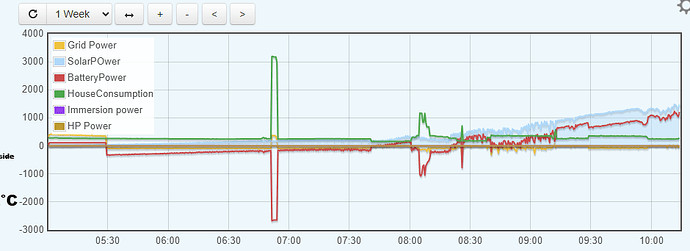

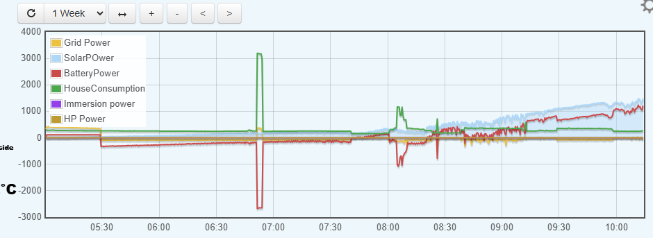

I’ve just checked my feeds and am seeing the gap between 06:30 and 08:45.
Interesting…
All feeds now showing green and data is up to date with no obvious gaps:
