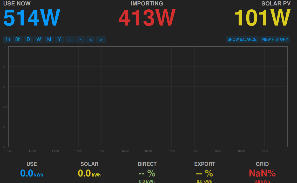

Hello, My local emoncms graphs on ‘My Solar’ have stopped showing the recent history, since 17th August. The graph starts again whenever I log in. The ‘Use now’, Importing’ and ‘Solar PV’ values show above where the graph should be and are updating fine every few seconds as normal. Also, the Emoncms.org remote logging works fine!
I’ve checked the spare disk capacity in /home/pi/data and there’s loads of space. Ditto /dev/root.
I’ve taken a couple of screenshots in case they’d be useful but can’t see how to upload them.
Am I doing something wrong? I have not updated anything as far as I know, nor have there been power cuts (anyway I have a ups). Thanks for any help - this is a great forum.emonpi%20disk%20space

Thanks, I’ve added the screenshots

@trnjones do you see your apikey in the URL for the mysolar app? When I test here the requests made behind the scenes all appear to be working fine when I logout and the dashboard updates with new data including the graph, I will keep digging to see if I can work it out.
No, the URL for local logging is just http://192.168.1.9/emoncms/app/view. Thank you! Where in the file system is the file which stores the local data? I wonder if that’s stopped retaining stuff?
Try clicking on the admin link, if it asks you to log in again do so then look at the data again. I am pretty sure that it is because the website logs you out and stops updating the charts.
You can view the raw data to see if it continued to be collected.
I am logged in and remembered on my computer. There is a ‘logout’ button above the graph on the right. I logged out and in again, but no change. The raw data is being collected fine, and shows on the attached screenshot - you can see where I have just logged in again it has started to show the graph. But when I close the window and reopen it, there is no graph again. It starts from when I go on the site. Maybe it is logging me out. How do I stop that?
Hi @trnjones, what version is this? It looks quite an old one. Is there a reason not to update?
It is pretty tricky to debug old installations as what you are seeing may have been fixed in more recent releases.

Just go into ‘admin’ and click on Update.
On the actual emoncms unit’s little screen, or where? When I log in to the webpage I don’t get an ‘admin - update’
Then
Sorry, ‘Full Update’.
After a lot of ferreting around, learned that I had to logout then login again in order to see the ‘Admin’ menu item! Thanks,
