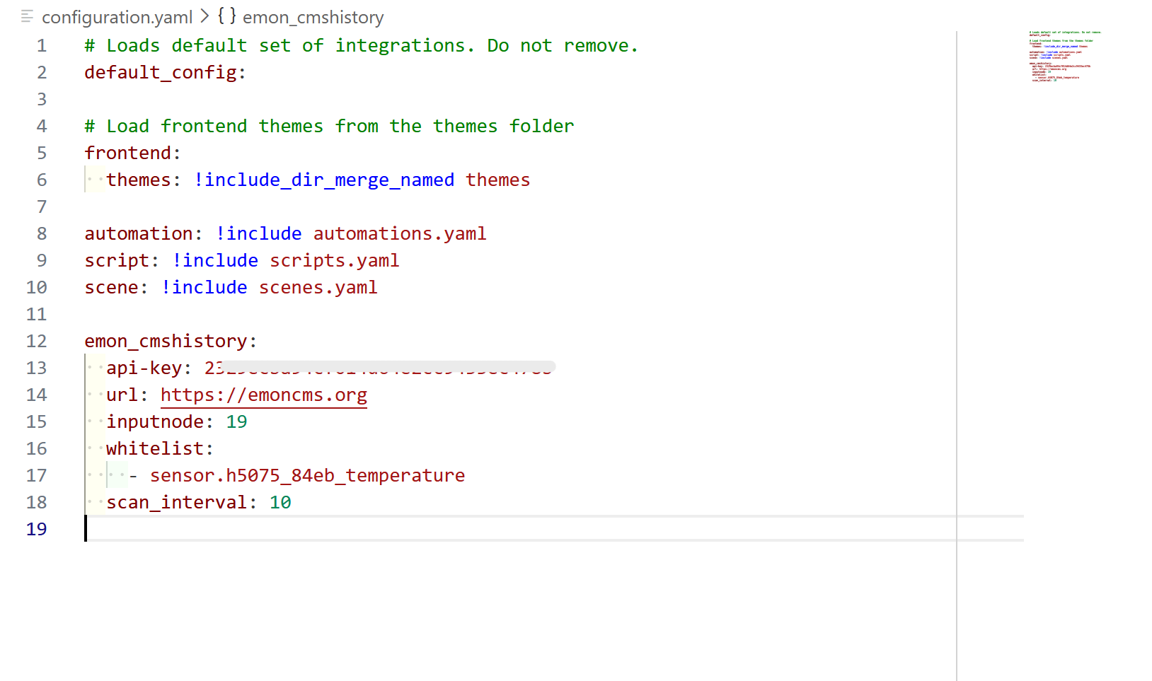

I have been trying everything to make this work. Nothing is showing up on Emon CMS. I have tried different settings, including changing the inputnode, always restarting but drawing a blank. I can make the Emoncms HA integration in the opposite direction work fine. Attached is a copy of my configuration.yaml. Can anyone see what I am doing wrong.
Thanks in anticipation of your help.

you have emon_cmshistory instead of emoncms_history
api-key instead of api_key - is this the R/W key?
I’m assuming you really do want to send the data to emoncms.org?
Thank you Brian
As always a font of knowledge and sharp eyes. Bloody typos! Yes I wanted this reporting into emoncms. Now have room temperature in the Heat Pump app.
