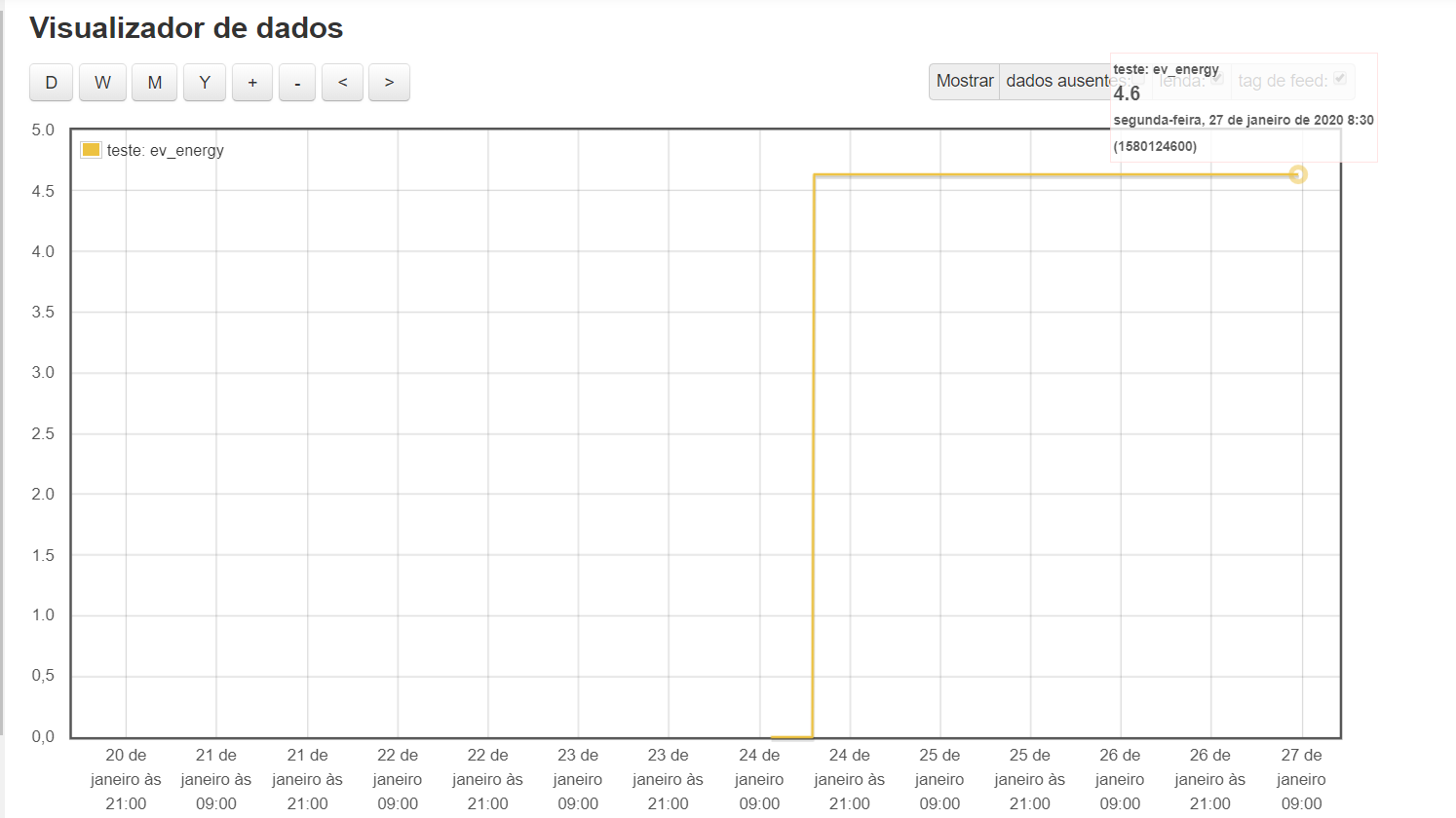

On January 15th I turned on my equipment at emoncms but I didn’t put load, I turned on again on January 24th but on this date I put load.
Why does the graph indicate energy from the 16th to the 24th?
The same would have to be set to zero because I didn’t activate the charge!
Below is the picture with the data.
When no data is received, the graph connects the known points with a straight line.
If you tick the “Missing data” (“dados ausentes”) box, the line will disappear.
because emoncms generates graphical measurements of current and not energy?
follows an image below.
It is the graphing package that is part of emonCMS that links the points between readings. It makes no difference what the quantity represented is.
On your graph, I suspect there is a point where energy=0 at 16:00 on 24 January, and soon after, a point where energy=4.6 If you hover your mouse over the line, every point on the graph will appear as a circle as the mouse passes over it - like at 09:00 on 27 Jan.

In this graphic, “ev_energy” data is supposed to be present, not ev_current .
when I type the code “$GU” in Openevse the data for “ev_energy” is presented in the normal way, the doubt is related to the emoncms is not showing this data.

@Geinian_Gomes there may be an issue here with ev_energy input. My system is showing a very high reading while @glyn.hudson’s is working correctly. We are looking into it.
In the mean time, try attaching a power_to_kwh process to ‘ev_power’ this seems to be giving better results on my system.
