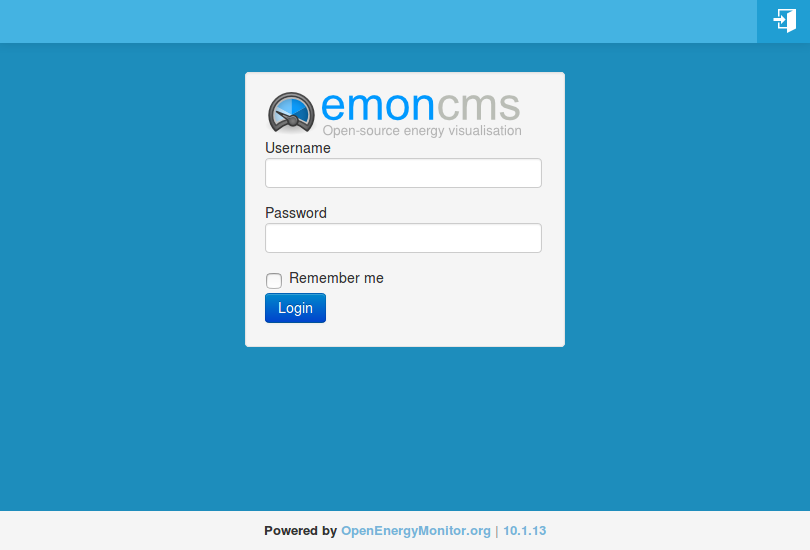

I’ve updated parts of the emoncms-docker today, it now uses the new settings.ini file and the directory structure is closer to what we are using on the EmonScripts build script. It’s still a work in progress, while it is functional from the HTTP API standpoint, the emoncms services such as emoncms_mqtt, feedwriter & service-runner are not yet running for the full emoncms capability.
You will need to build it from the docker file in the repository here:
GitHub - emoncms/emoncms-docker: Emoncms docker container(s)
rather than pull in the prebuilt image.
@glyn.hudson will be updating the pre build docker image soon and @emrys is going to look into the emoncms services.
Steps to try it are:
git clone https://github.com/emoncms/emoncms-docker
cd emoncms-docker
docker-compose build
docker-compose up
Then navigate to:
http://localhost:8080/
The result should provide a login screen that looks like this (but with a register button present):
Check that the version is 10.1.13 to indicate that its running the latest.
@glyn.hudson’s updated the docker image on docker hub Docker Hub
