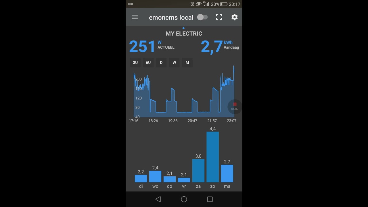

i have some of the same problems. The font for the current values is just too big on my phone as well (ascend p7 running android 5.1) not sure what’s it’s resolution nor what the dpi is.
Also after opening my app just now all the pages i had created in the previous version are gone somehow. I can make screenshots if needed.
Might the problems come from dpi and resolution used on phones ? as not all phones have the same resolution nor dpi i guess but i have no clue how the dpi stuff works on android i know on windows this can produce such effects but changing dpi scales the app controls and fonts perhaps something similar is happening here ?

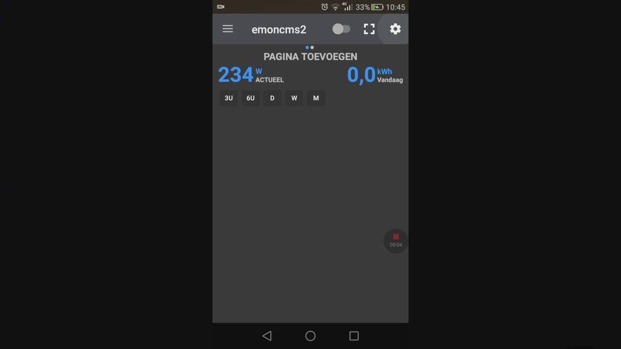

I also had a second account set up for testing against emoncms.org when selecting that using the drop down menu all i get is an empty page
it seems to me that it sometimes displays correctly and sometimes not, it seems to mess up switching between the multiple accounts using the drop menu to switch accounts.
I created a video using game screen recorder (that recorded my desktop on android). I keep trying a few things, readd some settings even whipe the app data as i figured i would have to recreate everything again eventually.
Could the losing the settings be related to the custom currency setting ? perhaps if it is / was missing (as it did not exist in a previous version) it could not load the pages again ?
here’s the youtube video i only started the app a second time after 2.0.6 update. if you take the time looking throught the whole 7 minutes of me messing about you’ll notice that sometimes it does display correctly like after i added the account again it displayed correctly initially but after adding a second account it messed up again.

The font sizes are set in “sp”
sp
Scale-independent Pixels - this is like the dp unit, but it is also scaled by the user’s font size preference. It is recommended you use this unit when specifying font sizes, so they will be adjusted for both the screen density and user’s preference.
However it seems like it is not working correctly across all devices. It is possible to set different dimensions for different screen sizes, so I’ll try this to get a bigger output on tablets, and revert the font size on phones.

@tamsin has committed a change to make the font smaller on phones and larger on tablets. Looks great to me. However, I could never recreate the text overflowing issues on my Nexus devices

here’s a follow up video of font sizes. the android settings haven an impact on it (which is normal) it shows during account switching 0.00KWH while it does not show that when data is availbile (my point is the KWH should not be there as there is a smaller kwh displayed besides the value above “today” text it’s displayed twice). shows a force close when adding a second account after first deleting it.
