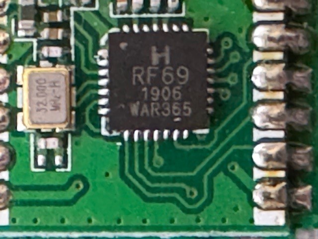

I had posted this earlier as “can’t open serial port”, but I have since confirmed that I can connect to the serial port by plugging in a zigbee dongle just to test. The log file shows a successful connection.
However, I cannot connect to the RFM59 module. Suspecting that the module might be defective, I swapped the module from a working emonBase and emonHub still shows as unable to connect. In searching other posts, I saw a reference to changing the baud rate, so I tried 38400 and still no luck.
The latest emonHub log is shown below.
Not sure where to look next and appreciate any suggestions.

Is your RFM69 module the original RFM69Pi emonBase with RFM69Pi (ATmega328) — OpenEnergyMonitor 0.0.1 documentation module? If so the data from this should be being picked up by the EmonHubOEMInterfacer interfacer, not the EmonHubRFM69LPLInterfacer which is there to communicate with the more recent SPI connected RFM69 module e.g New: emonBase with RFM69 SPI (Direct) — OpenEnergyMonitor 0.0.1 documentation.
You will need to set the baud rate of the EmonHubOEMInterfacer to 38400.
The second thing to check if the above does not work is that the firmware running on your RFM69Pi module might be the JeeLib Classic firmware and if your nodes are running newer LowPowerLabs firmware the data wont come through. You can change the firmware on the RFM69Pi from the Admin > Update page.
Not sure how to tell, but this chip looks to be the same as the one shown on the OEM store.

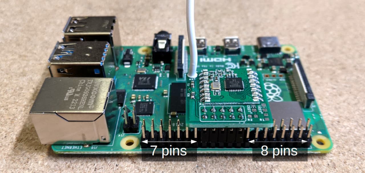

It’s the same chip/module, the difference is in the board that it sits on. It does look like the base board is green which suggests the SPI version, is that correct? Is the pin placement on the RaspberryPi header correct?

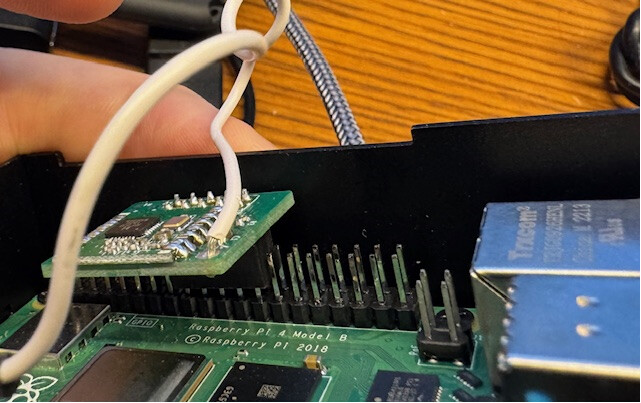

I verified the pin placement, which matches the picture you sent (7 pins back from the ethernet port).
Also, I went back and checked the invoice and purchased the emonBase 433Mhz (RFM69SPI).

@grod55 From the photo and post above, it looks like you are using the RFM69SPI module in your emonbase.

That worked! Changed the pin to 26, the radio connected and all the nodes showed up.
