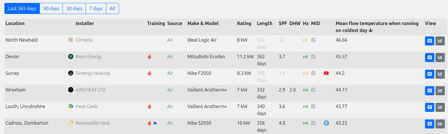

We don’t have any systems yet on HeatpumpMonitor.org with average flow temperatures of 50C on the coldest day, the closest is the Climatix Ideal Logic Air which matches your SPF at a flow temp of 47C (HeatpumpMonitor.org). Would you consider putting full monitoring on your system to highlight your case study, with more detail? @glyn.hudson’s experience of the internal monitoring on this Gen6 samung suggested some fairly large errors Samsung 5kW Gen 6 Air Source Heat Pump Installation with monitoring - #6 by glyn.hudson.
