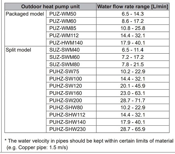

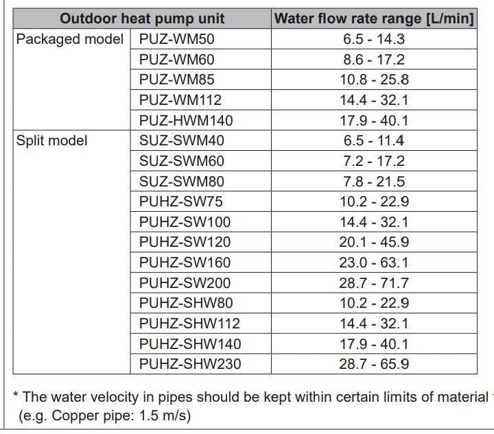

I recently setup the aswesome ESP integration for my Ecodan and noticed that it does use a lot of “Frost Protection” when its around 5 degrees outside. I have a Monobock (i e water to the outdoor unit), the pipes are insulated and no glycol in my water loop. I guess turning off the frost protection is probably stupid. But I seldom have minus degrees where I live, feels like a waste? I Have it set to speed 4 for heating and speed 5 for hot water. I can see that it uses 33w it speed 4 and 55w in speed 5. I have small dimensions on my piping so speed 4 gives 9l/m and speed 5 about 10l/m. Its a bit little for my machine actually but it seems to work, the circulation pump is noisy so i dont want it on speed 5 all the time.

The freeze stat mode is essential for protecting the outside unit from freezing, so long as it always has power. You can select a lower threshold in the settings, if you’re certain that the outside temperature sensor is sufficiently accurate. According to the FTC 6 manual, default setting for this is 5°C, minimum is 3°.
Running the main pump at a lower speed is an option, but does limit the amount of heat that can be delivered into the property. Also be aware of the minimum flow rates for your model.

Yeah I have the PUZ-WM85 so I’m on the low side. I blame my installer for not checking this. In hindsight, I think the weaker WM60 would fit my house a lot better, the WM85 is to powerful and cycles a lot. I only have a Single pipe system (not sure what its called in english, I e, all radiatorers are coupled in series). Its not ideal for this, my old heatpump was an exhaust air heatpump, it bacially only used the air that was ventilated out with a 500w compressor (that could give about 2kw). During winter, it basically run 24/7 and on days colder than -5 outside it had to use its 9kw immerision heater. So our yearly power usage was about 18 000kwh. With the ecodan we now use about 7000kwh per year so a big improvement.
But have measured my delta temperatures for the various settings as well.
Speed 5: 3.5c delta
Speed 4: 6c delta
Speed 3: 10c delta.
Of what I have gathered a delta around 7 is desirable? So I went with 4 for that reason as well. I haven’t gotten any larms for low flow at least after 3 years so it is working at least. But safe to say, after the 5 year guarantee is over, I will get the extended one for sure…

WM60 would not have make any difference since its min output is (virtually) the same as the WM85.
I think your unit has 3.3 kW min output. You need to find the settings such that this equation holds
3.3 =< flow rate / 60 * (feed temp - return temp) * 4.18
Keep in mind that the min output varies, depending on the ambient temp. See databook for the exact values
This way you are always absorbing more that the min output of the heatpump (this will stop it from cycling). You can tweak 2 parameters:
  1. flow rate (via pump setting)
  2. delta T via feed temp

All heatpump have a min output, for recent Ecodan R32 I think it’s always around 3.3kW. R290 can go lower.
tweak the params above to get >= 3.3kW and it should cycle less. For radiators it’s better to have a somewhat lower flowrate and higher delta T.

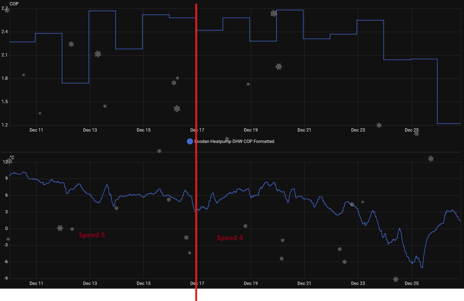

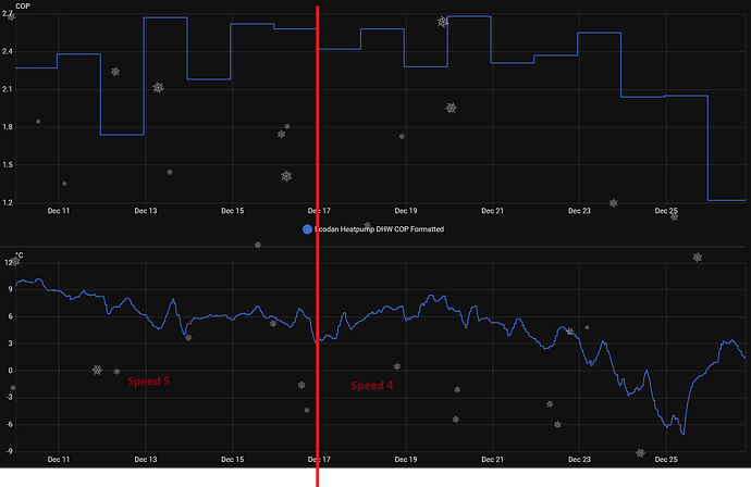

What about the pump speed for hot water production? I have tried a week with speed 5 and then a week with speed 4. Difficult to say if COP was affected since outdoor temp dropped a lot.
