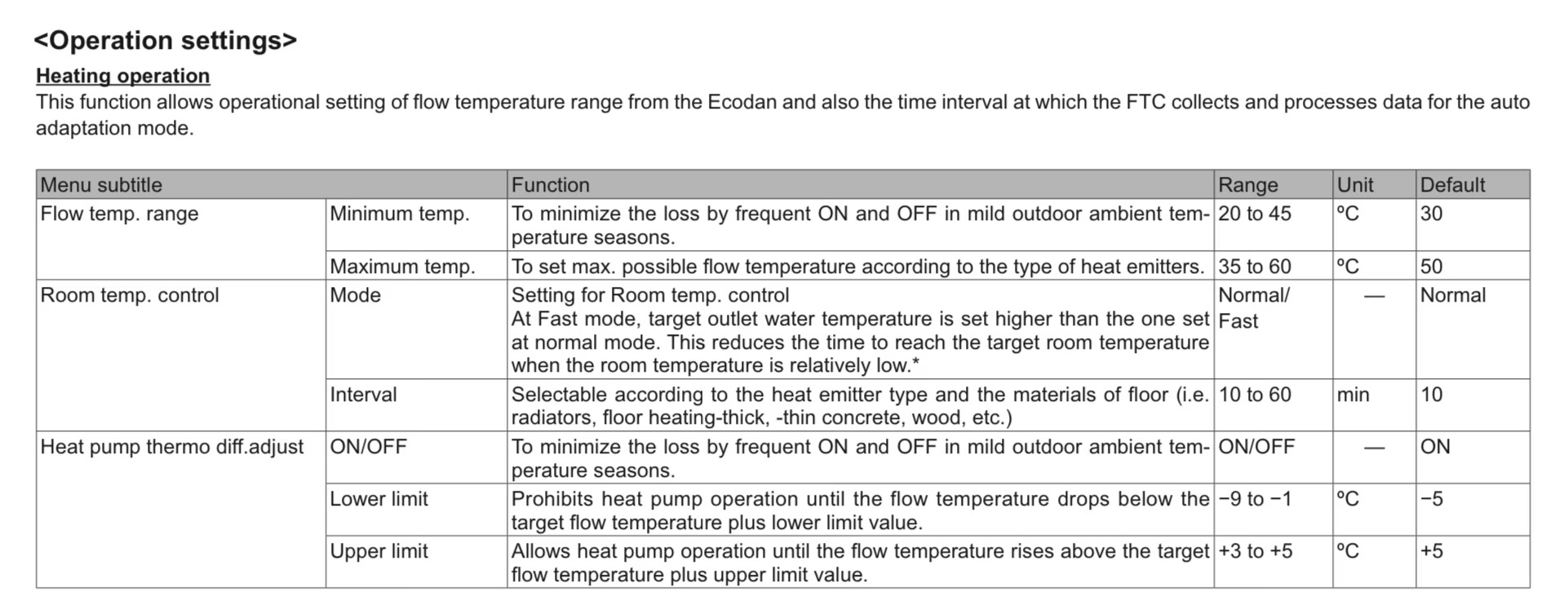

You are using the standard Ecodan auto adaptation mode, correct? What are the settings you use?
Please see: Menu → Service → operation settings → heating operation →
Found it in your first post
Try putting it at 30 minutes instead of 10, or even 60 minutes. It will probably cycle less and have longer runs.

Yes, I am still using Ecodan’s dumb AA (until I can find the time and willpower to try gekkekoe’s flow temp AA). I don’t recall exactly what settings I have atm, but it’s probably flow temp min/max 30/45, room temp mode normal 60 minutes, thermo diff +5/-5.
And then I have home assistant lowering the room setpoint by 0.5C when HP turns off and setting it back to normal when it turns on.
This combination has worked up to -10 outdoor temp to reduce daily cycling to under 2 times on average. However, it would be so much more efficient and comfortable, if the unit didn’t have this minimum frequency on lower temps restriction, and if it also didn’t just start every negative temp cycle at max power…

I just wanted to add what I’ve found lately in order to improve run times and reduce cycling in my system - it’s something I haven’t seen you make reference to. I turned off my thermo diff altogether in AA. It’s lead to my system running continuously until it hits the room temps. I have a fully open loop system so I don’t know what this would do with a buffer as you have. I imagine you would need to turn the secondary flow rate down to ensure max dT to give it the best chance.
For ref I have time set to 10 mins and max flow temp set to 36. It’s still over shoots this but it seems to help limit the system. I’ve also turned on quiet mode level 2 but not clear yet if this has much benefit.
This trial has been 2 weeks now with the average outdoor temp of about 5 so it remains to be seen. What happens at higher or lower temps.
That is interesting, because it is my understanding that the HP thermo diff’s purpose is precisely to allow over/under shoot, and therefore reduce cycling. Though with all that the weird behaviours I’ve seen so far with this unit, I don’t doubt it.
