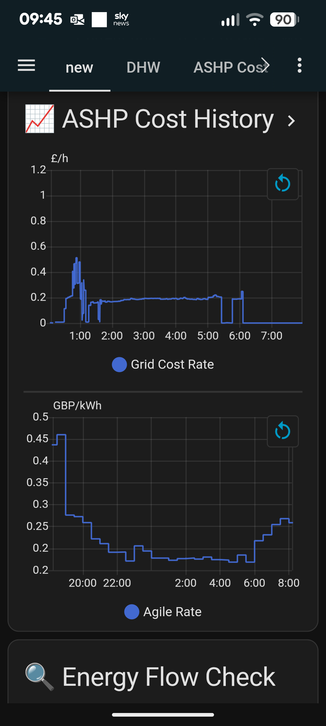

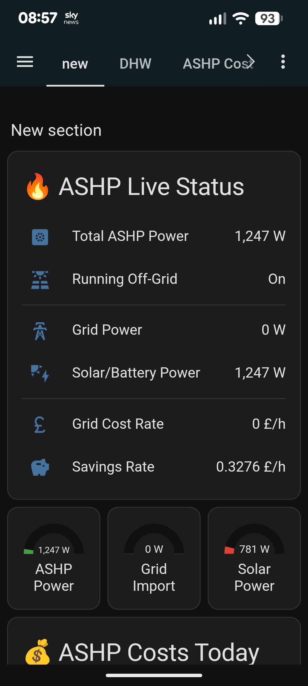

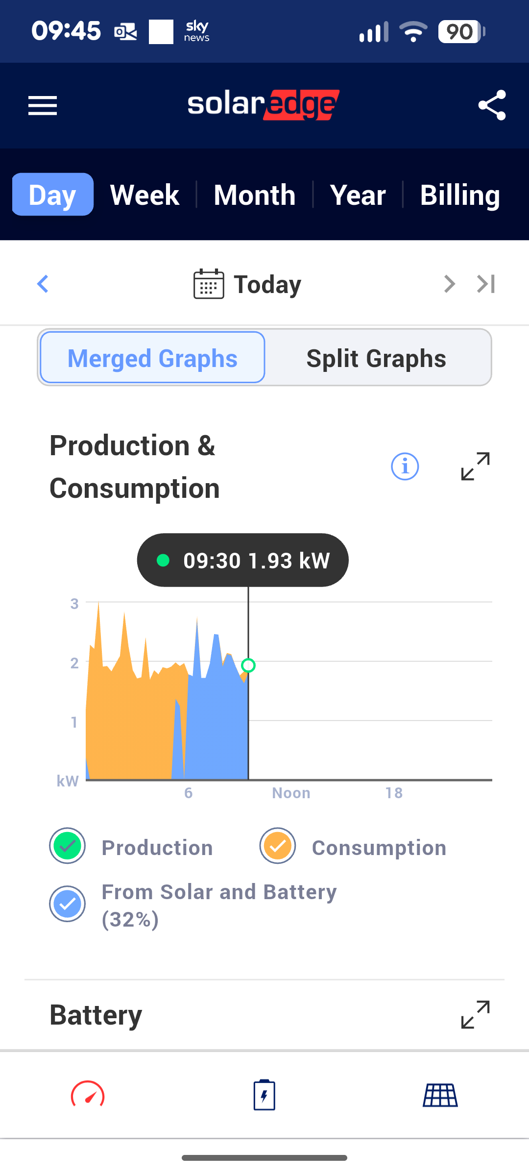

Sorry going a little off topic. Other options if you like to tinker and have solar and battery.
I have a solaredge system. I used predbat to control the battery’s status automatically. Having a cascade system working with Predbat has been great. It’s well worth the effort to install. Give it ago if you don’t mind messing about with home assistant. I’ve found Claude Ai work best with Yaml code.
Predbat has learnt the extra loads of the ASHP and keeps battery available for the exspensive peak over the morning. Then solar takes over. Predbat calculates every 10min for the best cost/return.

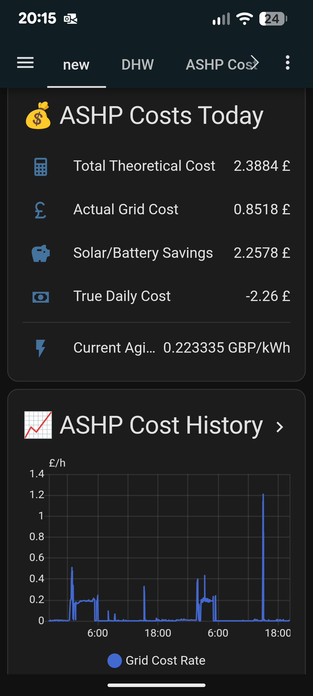

In home assistant I can monitor where the power is coming from for the ASHP. Also cost.

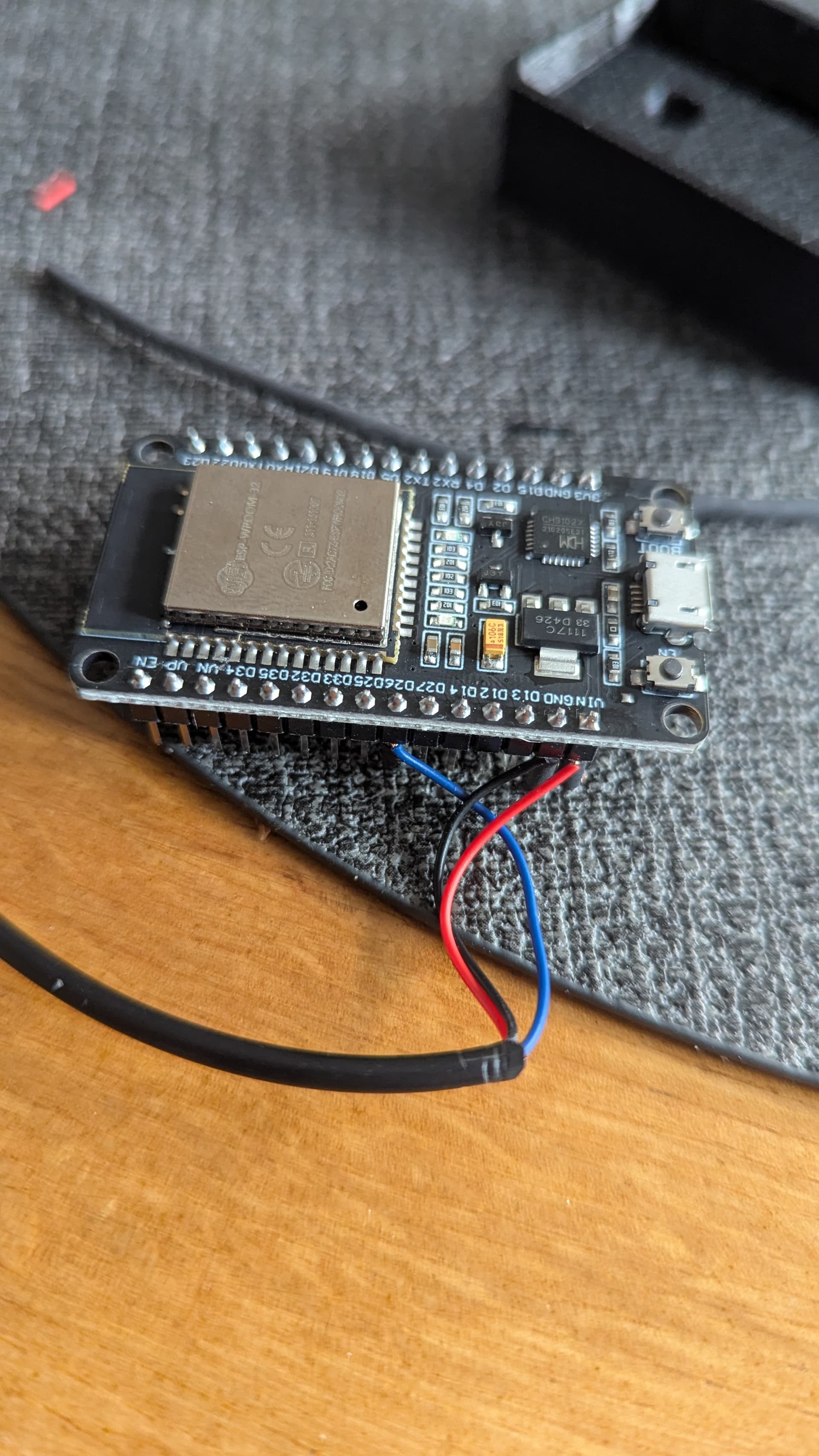

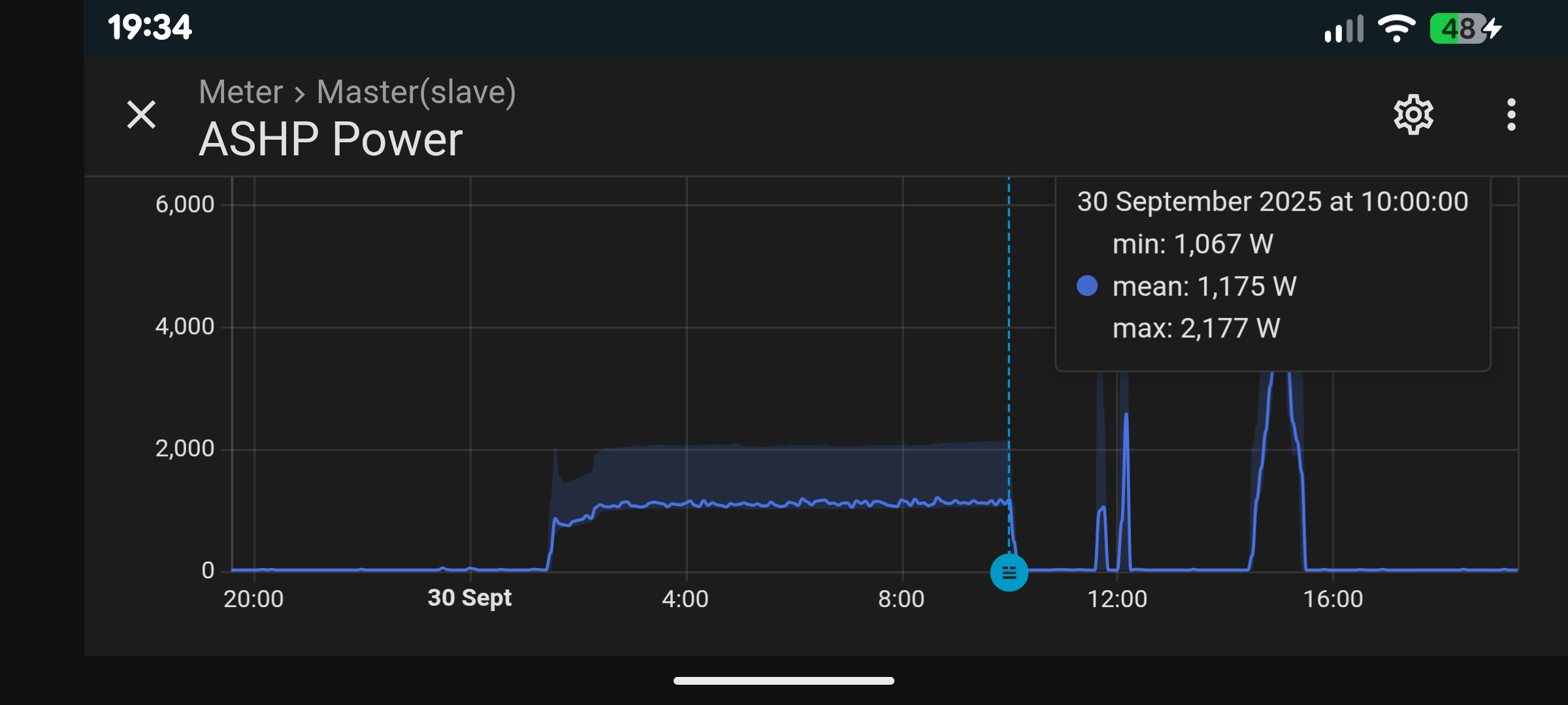

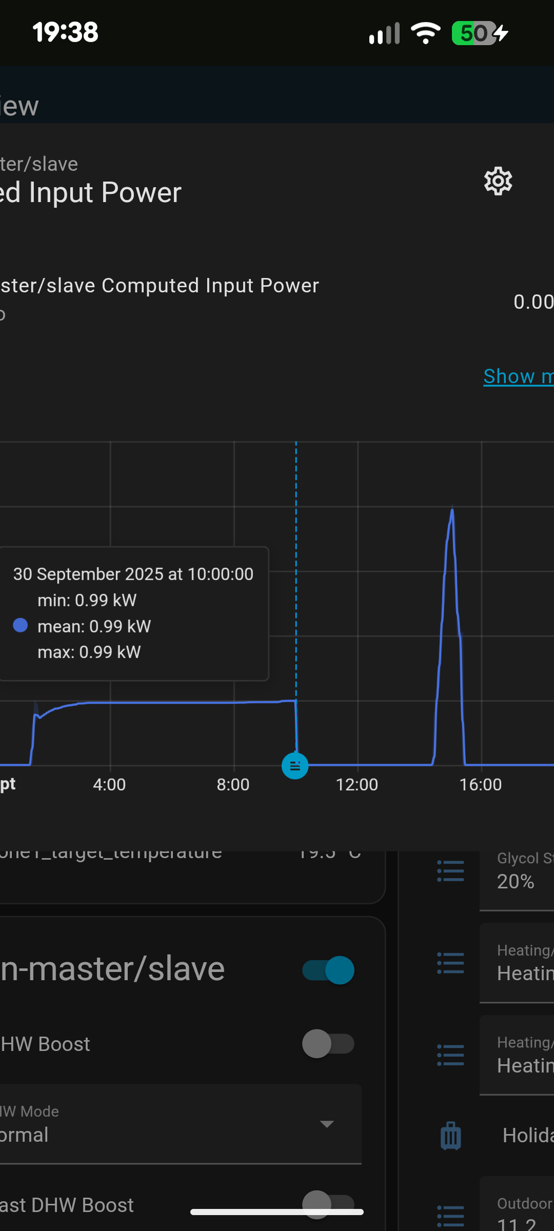

Hi.
I have two utility meters for each ASHP. Optical Utility Meter LED Pulse Sensor - Shop | OpenEnergyMonitor
I’m sending data via esp32 to home assistant.
Power from the CN105 control board does track closely to my live feed. CN105 is normally a little lower. With local data feed on ecomcms of 60s you seen a higher resolution, Emoncms online is 5 min refresh so power looks smoother.
First pic is live. Power spikes was me messing with sensors.

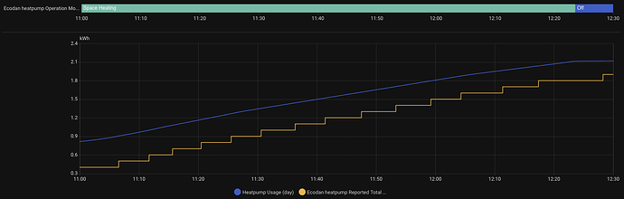

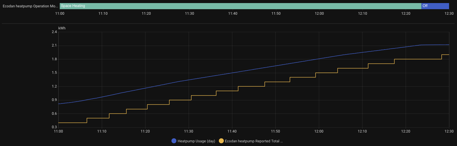

yes I have a certified mid energy meter on the heatpump and compared with
the reported numbers by the ecodan, it can be pretty good, but sometimes it can differ up to 10%.
yellow: reporting numbers from ecodan (not available via melcloud, but via my esp)
blue: certified meter. You can see it’s pretty close. (I probably re-flashed a couple of times this morning, counter probably got reset, that’s why its off in this case, but normally its really close)
If you don’t have a pulse wired to the ecodan, then it estimates the consumption. It does a pretty decent job.
If you wire your energy meter (pulse) then the consumption of the heatpump is very accurate.
