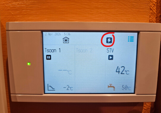

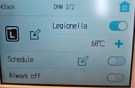

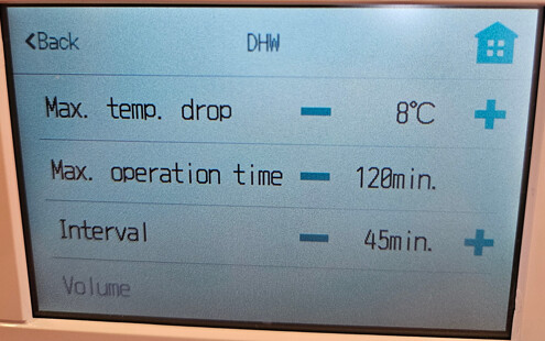

The second problem is when I turn on the ECO mode for the DHW. The noise turned down but the problem is it started using electric heater. For example today is -1 outside and when the DHW 300l tank came from 50c to 42c it heated it ONLY using electric heater. Again the installer is clueless why it happens :frowning: because it is supposed to make COP better not worsen it.

Eco mode DHW on my unit typically uses 60-70hz and it’s just the sound of air movement only. It should not trigger the electric heater (I disabled that for dhw, only legionella uses it). When the electric heater is used, it mostly means that the heatpump cannot deliver the request flow temp. But your unit should be able to handle it easily

Any more ideas guys? Any settings I should also check why is it using electric heater in ECO mode?
normally that’s a ‘bad’ sign. The booster heater assist when the heatpump cannot get to the desired flow temp. But you should get some logging to see what is going on

If I turn off eco mode it uses the inverter so that is weird.
