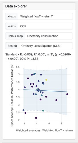

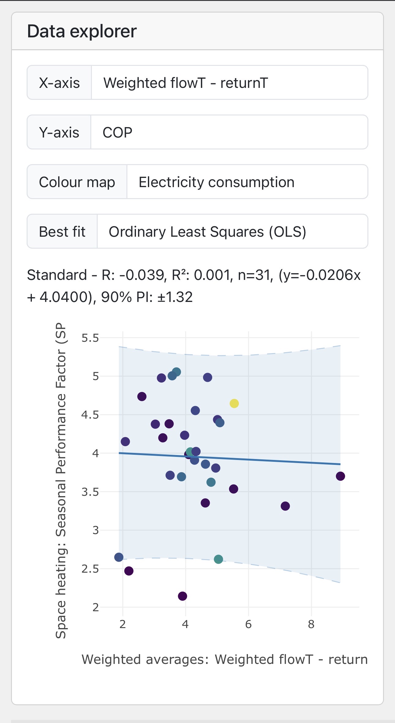

I would really stop stressing about this, getting your delta to 7 instead of 4 will not massively increase your CoP, or even make a measurable difference to it.
There’s an entirely different group of people who fixate on the idea that lowering their DT will increase efficiency, and they’re wrong too.
https://www.reddit.com/r/ukheatpumps/s/Do6tstl9CT
A delta T that is too high or too low is a problem, my understanding is that you want it between 3 and 7 (for UFH at least) and I couldn’t get mine to go above 2 because my installer hadn’t commissioned the system properly. At a delta T of 2, the flow velocities get up to ~0.8m/s on my highest flow rate circuit which is not good for noise or wear and my CoP was going as low as the low 2s and at best the mid 3s.
I have now managed to get the delta T to 3 or 4 which has reduced flow velocities and increased CoP to mid 3s or low 4s. I think the R290 units like a larger delta T compared to previous working fluids too.
Zero evidence that R290 heat pumps have any more of a preference for DT compared to other refrigerants.
I can’t speak to the changes you made previously, but I would suggest that the change in DT was not the cause of the increase in COP and going up to 7 will not give you a greater increase.
