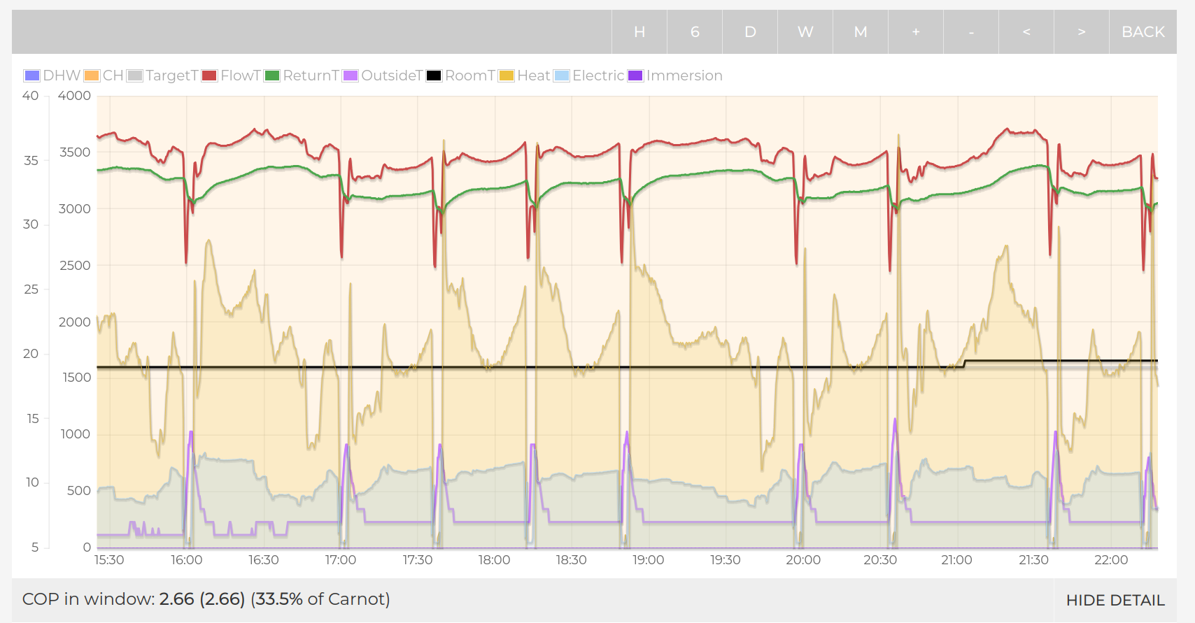

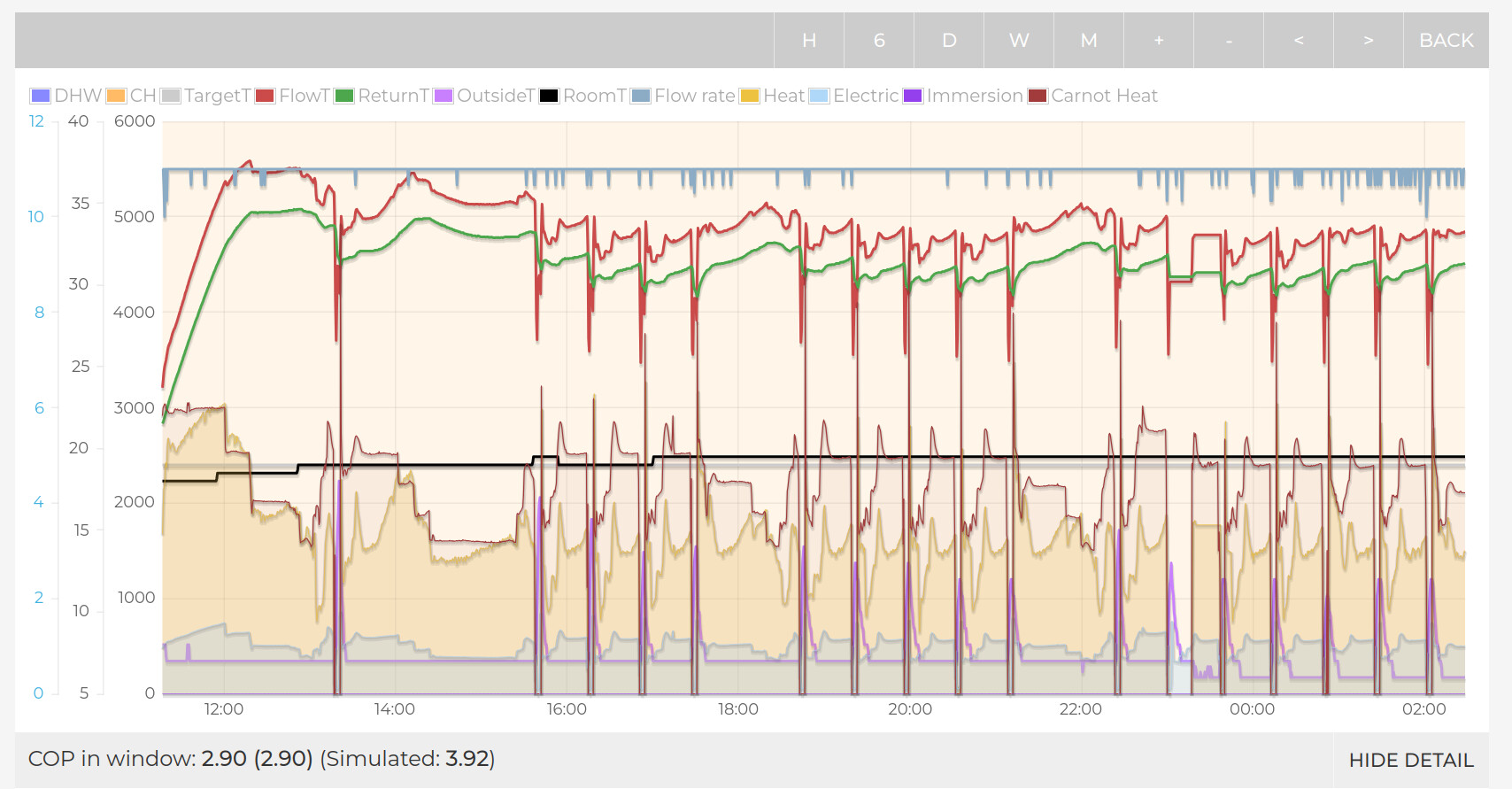

Wondering if anyone can give me any suggestions / tips. We’ve gotten to that point in the year where its cold outside and I’m relying on my heat pump for heating again rather than just hot water and I’m seeing a roughly COP of around 2.5. I am warm and it works ‘well’ but looking if its possible to improve this efficiency.
EmonCMS powered by publishing from home assistant - Emoncms - app view

My delta T is pretty low for flow and return, around 1-2 degrees which I think is where a lot of the ‘issue’ is coming from. During operation where I’m heating up a lot (after a set back) or early on in the DHW cycle the efficiency is actually a good chunk higher (3-4). Is there any way to improve this?
I assume if I do a round of balancing (or close some values a little) it’ll reduce flow rate and increase delta-t?

Hello @JRascagneres
That is a surprisingly low performance for the flow temperatures that you are running! Looks like your running about 40C at -1C, but are mostly running around 33-38c. I’d be expected COP around 3.5-3.8 at those temperatures.
The main thing that jumps out at me looking at the data is that the system is defrosting a lot! even when it’s relatively warm outside, do you have air circulation issues / cold well around the heat pump?

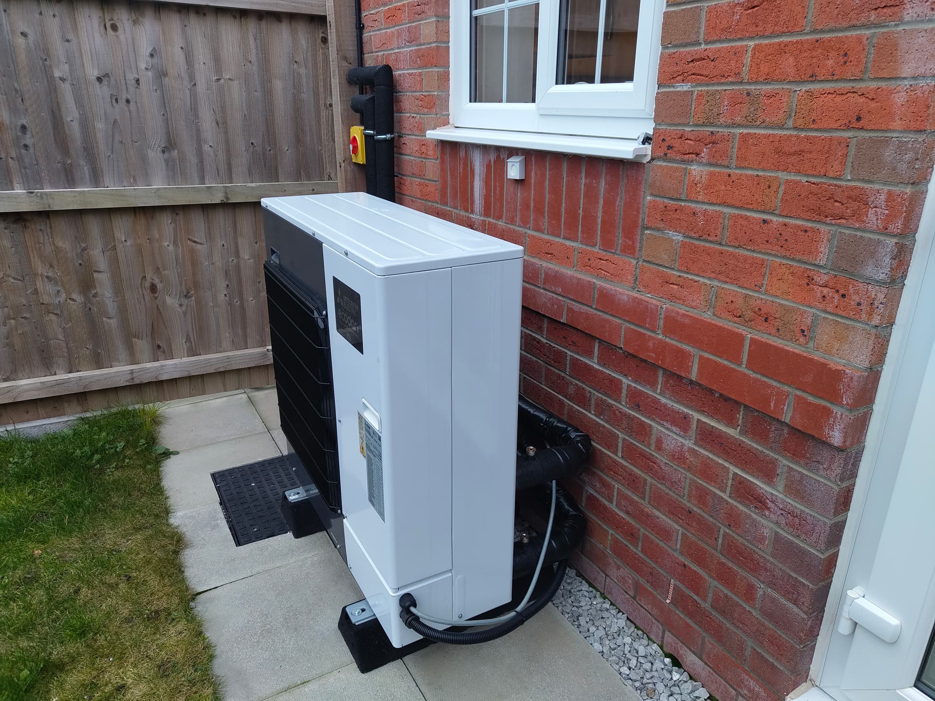

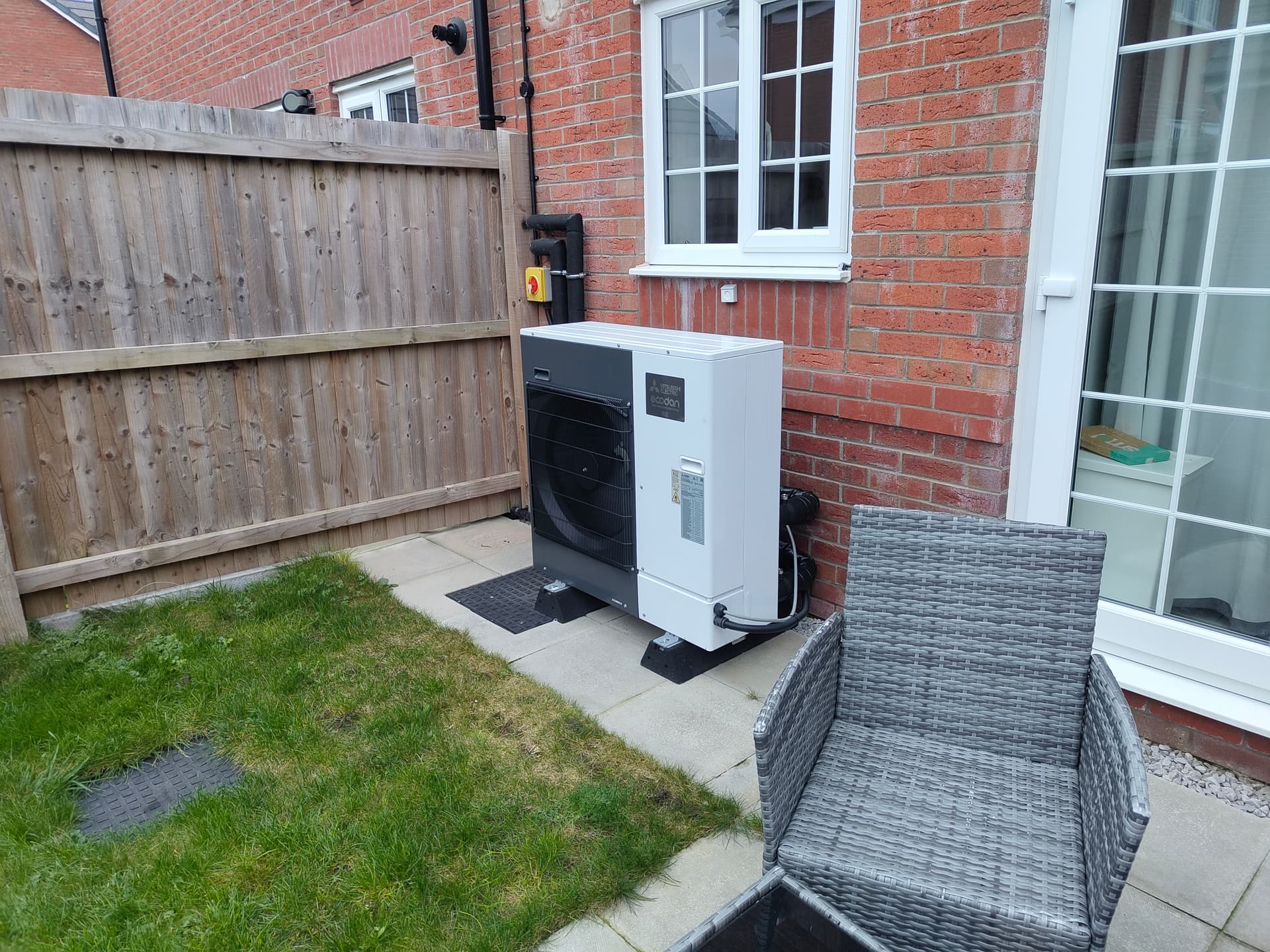

Hey @TrystanLea . I don’t know really. I mean its not in a ditch or anything. Its in a corner but has plenty of space around it:
I also can’t really move it given the location and fixed condensate pipe…
Looks tidy and it doesn’t look unusually obstructed! It is definitely defrosting more than you would expect though, another example, 7C outside, December 23rd: Emoncms - app view

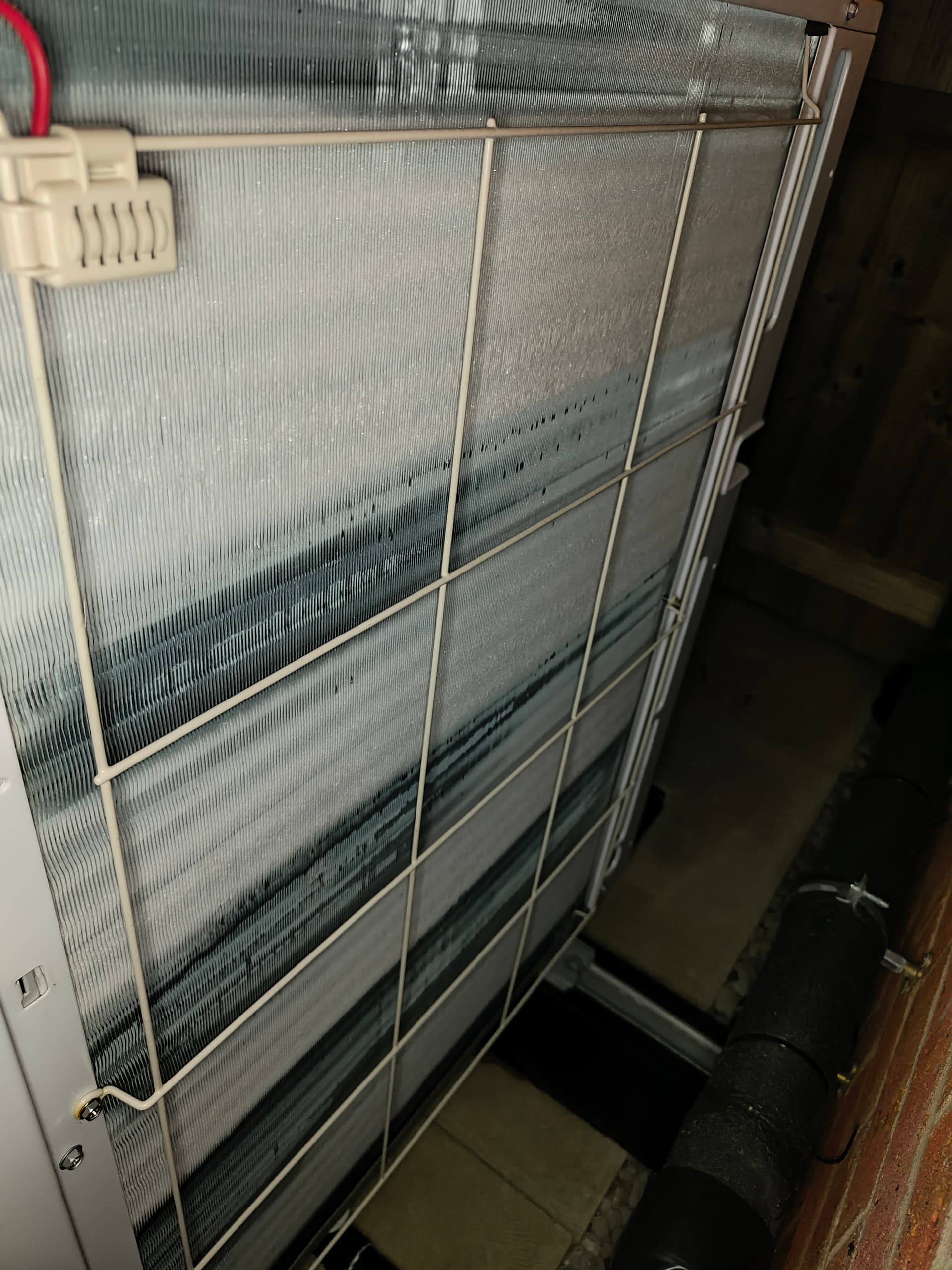

Yeah. I do notice it defrosts quite a bit. I need to setup a camera on it haha so I can catch defrosts. It doesn’t seem to get particularly frosty a lot of the time. When I’ve caught it the majority of the time there is some frost bands but not usually a lot. Although yesterday after I fixed flow at 45 for a bit to do the balancing there was a good amount of frost, I recorded the defrost video too but not sure that’d help anything.
Are there any settings I can mess with to potentially reduce the defrost frequency?

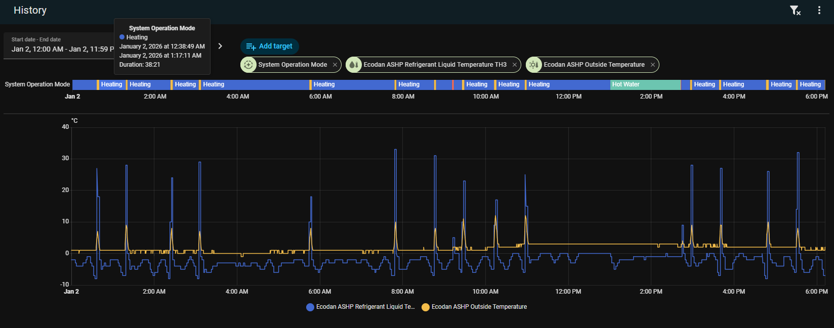

Hey @Jacques,

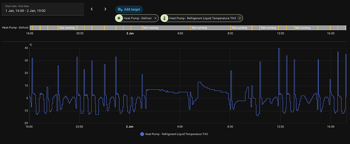

We observed that Outdoor Air Temp - TH3 >= 10 was the “trigger” for the Ecodan defrost sequence to begin
Sometimes the resolution of the TH3 (Liquid temperature thermistor) is a little low from the ESP but you can add an automation to poll faster perhaps on the run-up to a defrost
If you have that data available to share we can see perhaps those defrosts triggering

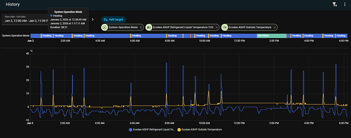

Hey @F1p
Is this correct:
Could you add the Ecodan Outside temperature sensor too please?
Happy to add a different time range too if it’d help align anything from the emoncms dashboard

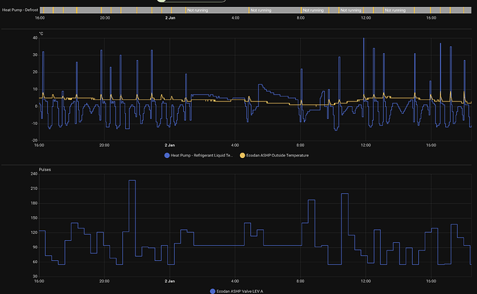

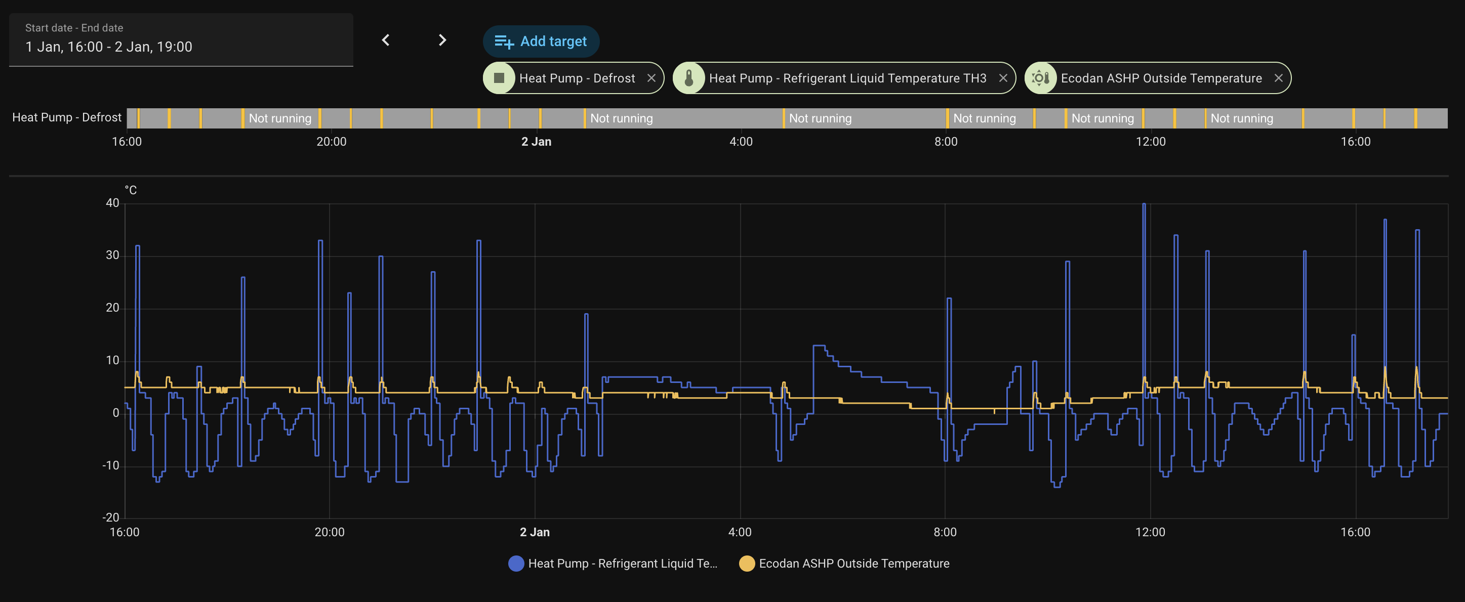

Seems to be defrosting due to a rapid loss in Refrigerant Liquid Temperature,

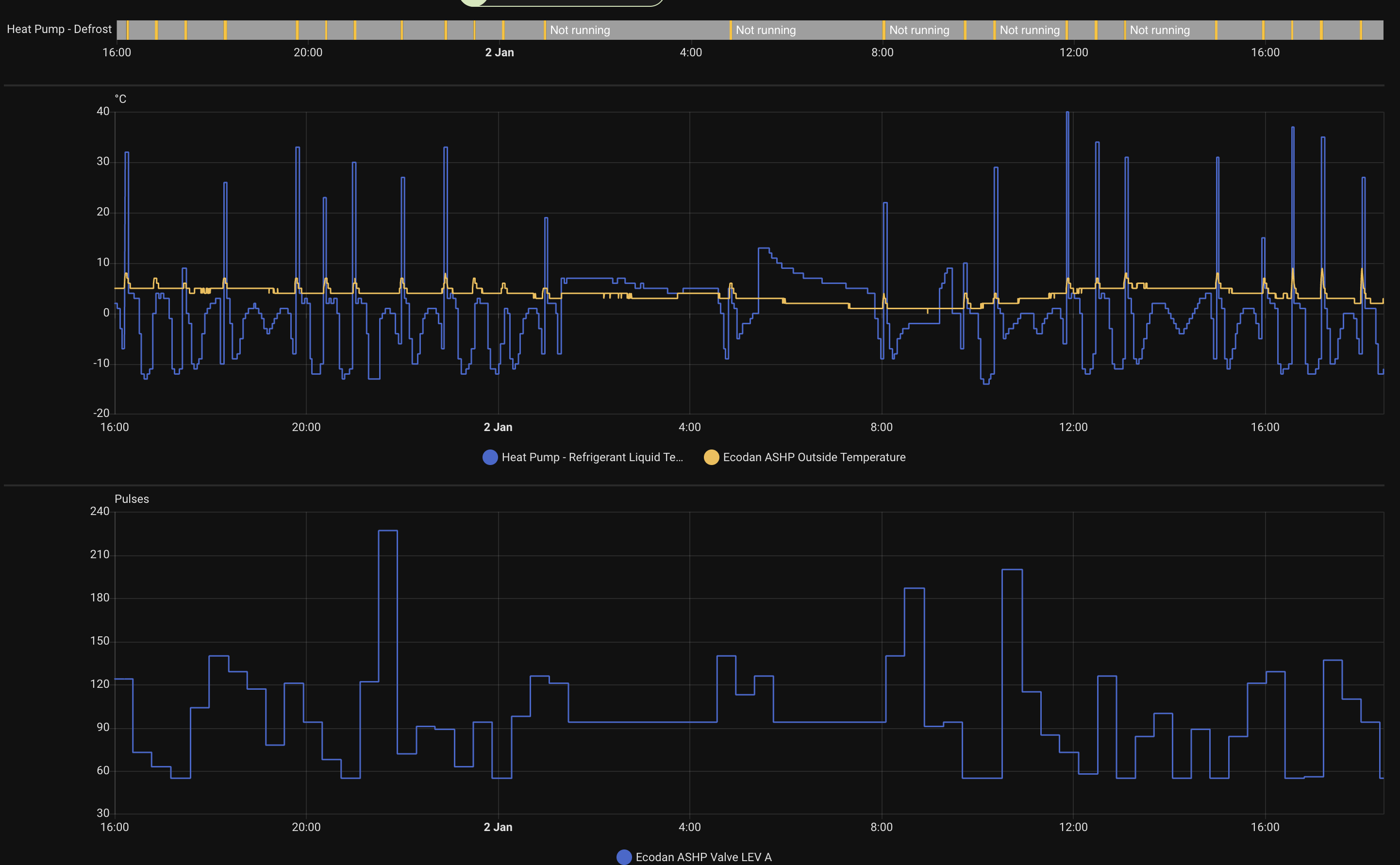

Here is my R410a for comparison today, approx 65% humidity and at worst 40min between defrosts:

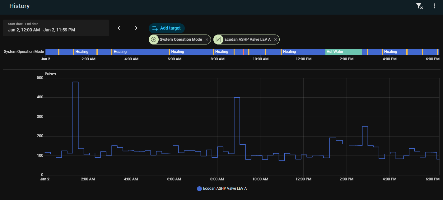

I think it comes back to @johncantor topic of LEV-A movement
My R410a over the same period, quite consistent at 100 pulses:
I don’t even know what LEV A is.
Has any thought/comment been given to aspect of heat pump? Sun in morning when temperatures are often lowest may help with cop and defrost - like my car windscreen in the morning. It could be argued that this evens up during the day as sun moves round but maybe not for all hp placements. You can’t change the siting but maybe it’s a factor that has a measurable effect.
This is point at which I Google it and find it’s well known.
In my case, it does kinda face the sun which I don’t think is typically recommended (but I didn’t have a choice). The temperature sensor is on the back and if it gets in sunlight it can confuse the whole system as it thinks its warmer than it is.
