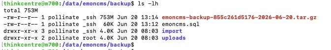

I successfully imported my backup file that was running on an old Pi. The backup file is ~600MB and contains feeds from 2 users/houses.
On the Graph I see the old data with no issue.
I then trying to backup the new emoncms to check that it working as well and without any errors, I get a backup file of only 211 bytes.
Is there something that I am missing?

Did you wait long enough? The last time I did a backup, that was about the size of the file created, before it is filled with data. When the backup is complete, the instruction to refresh the screen to find the file to download appears in the black window - ignore the instruction beneath the black window. (You’ll see a list of files appearing as it copies them, then it GZIPs that file - only then do you get the ‘finished’ message.)
Thanks, I know what you mean but this is not my issue.
Anyway I found out that the download is wrong or something else.
The actual file is correct and I can get it through SCP of Filezilla with no issue. 750MB.
