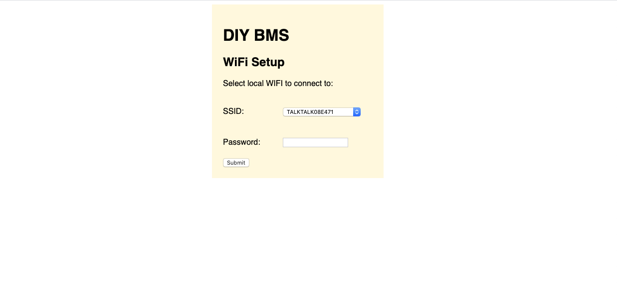

Hi I would like someone to help me
There is a problem with the wifi connection.
  1. I used the precompiled firmware to flash the wemos d1 mini pro and used the NodeMCU-PyFlasher to do the job. It could connect to my router and i could login, but it wasn’t communicating with the modules.
  2. Finally I managed to flash it using platformio (the reason I could not do it before was not changing the port) Now the controller communicates with the module because the green leds are flashing in sequence.
Now the problem is that when I connect to the controller so I can set the connection with my router it doesn’t connect and I still can see it in my WiFi list.
here is a short video
is my router a problem or there is something else

Does your router support wifi on 2GHZ and 5GHZ channels ?

Hi Stuart and thank you for your reply.
My router supports both 2.5Ghz and 5Ghz
And I think the router is not the problem as I checked it at my works WiFi and it’s still not connecting to it.

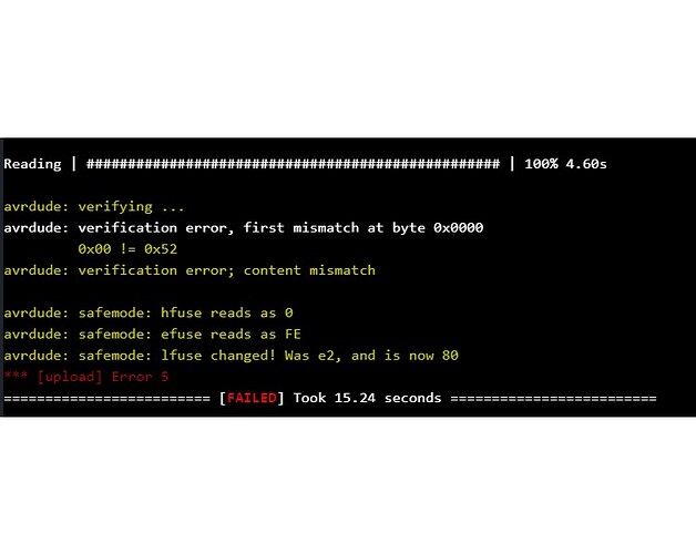

Still unable to program either the controller or module.
latest errors:
Module: last response from PlatformIO:
avrdude: 376 bytes of flash written
avrdude: verifying flash memory against .pio/build/attiny841/firmware.hex:
avrdude: load data flash data from input file .pio/build/attiny841/firmware.hex:
avrdude: input file .pio/build/attiny841/firmware.hex contains 376 bytes
avrdude: reading on-chip flash data:
Reading | ################################################## | 100% 0.22s
avrdude: verifying …
avrdude: verification error, first mismatch at byte 0x0000
0x00 != 0x1d
avrdude: verification error; content mismatch

I think I just programmed 2 modules, need to program controller to be sure.
I compiled the HEX file in platformIO (windows 10) and used Win Terminal to run avrdude command line using ArduinoISP (UNO).
ex: avrdude -F -P com2 -b 19200 -c avrisp -p t84 -v -e -U lfuse:w:0b11100010:m -U hfuse:w:0b11010110:m -U fuse:w:0b11110100:m -U flash:w:firmware.hex

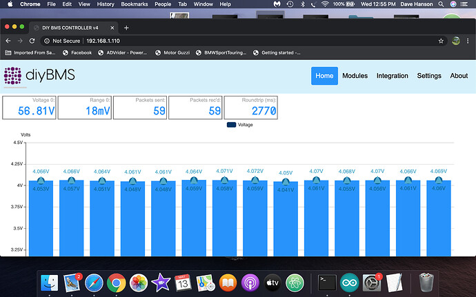

UPDATE: Controller programmed as normal and OK in platformIO. However, no blinking lights on the two modules and I cannot get the controller in browser???
UPDATE2: Changed to 4m on controller, now working (I am connected) but no modules??
PlatformIO from windows:
Yes I did checked it and I thought it would not be the problem because I purchased the wemos d1 mini pro which has 16Mb. But I think I have been tricked and it is 4Mb.
So now I flashed it again and it works perfectly
Thank GOD!!! I’m on the way up. Changed the USBasp programmer (jumper) from 3.3v to 5volts.
Bingo, loading modules no problem. First one is up! Yee Haaaaa!!!
What I did to recover:
  1. Program Arduino with ISP sketch
  2. connect to module and choose attiny841 for board without boot loader
  3. Programmer → choose arduino as ISP (attinycore)
  4. Set eeprom to delete
  5. Burn boot loader
  6. disconnect 6 pin and arduino from module board
  7. Connect module board to USBasp programmer
  8. PlatformIO to build (I had to use windows, mac with catalina would not work)
    P.S. Not sure the arduinoISP thing is needed, I programed the last few modules just with USBasp programmer (5v).
I was going to suggest that the 4M d1 might be the problem but then when I saw
in the message I thought, “it can’t be that then”.
