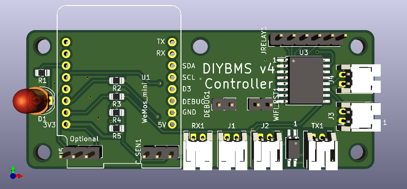

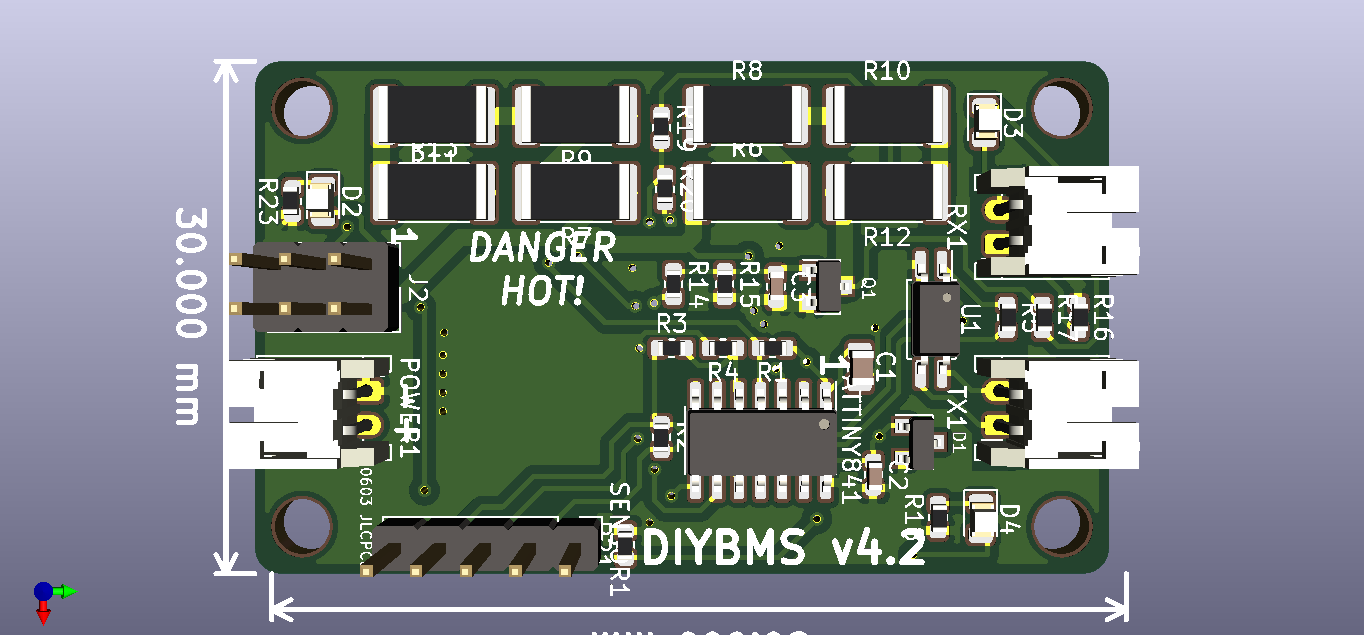

Hi,
I just finished to update my repository.
Now we have the possibility to order directly from JCLPcb and LCSC in a simple way … I did not test but I hope…
I took the opportunity to update the footprints used on the components in KiCad in order to use only libraries available with KiCad 5.1.5 (except for the Wemos D1 footprint), and now here is what we have:
Controller:
Module:
@rolfbartels
Does anyone have the BOM and CPL files for JLCPCB. files that are in the correct format. I am not savy enough to select components, I will for sure get it wrong.
You can find this in my repository you have a BOM and CPL for each card (1 controller and 1 module) but if you use KiCad and Eeschema BOM Tools, you can generate BOM and CPL for the number of cards desired.
All the material not being available at JLcPcb, Eeschema generates 3 BOMs: one for JLCPcb, one at LCSC and then a last one at Farnell for the module (ATTINY841)

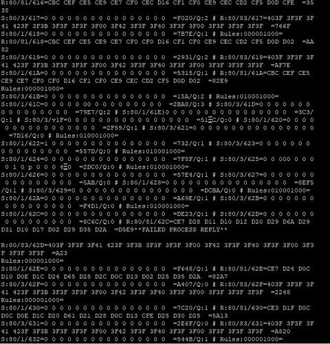

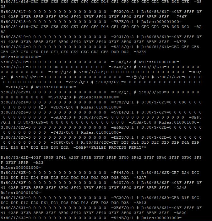

Stuart: Does this log give you any insight to why monitoring stops during charging?

That looks like it.
Its difficult to diagnose, but it looks like a timeout issue, you are receiving replies from the modules (for instance the line with 62C in it) after we have already timed out and requested another packet.
Take a look at the controller code and find the line
if (receiveProc.commsError> (mysettings.totalNumberOfBanks* 10)) {
change this to
if (receiveProc.commsError> 100) {
and see if that helps narrow down the problem - this may also cause strange behaviour so feel free to put it back to what it was after testing.
