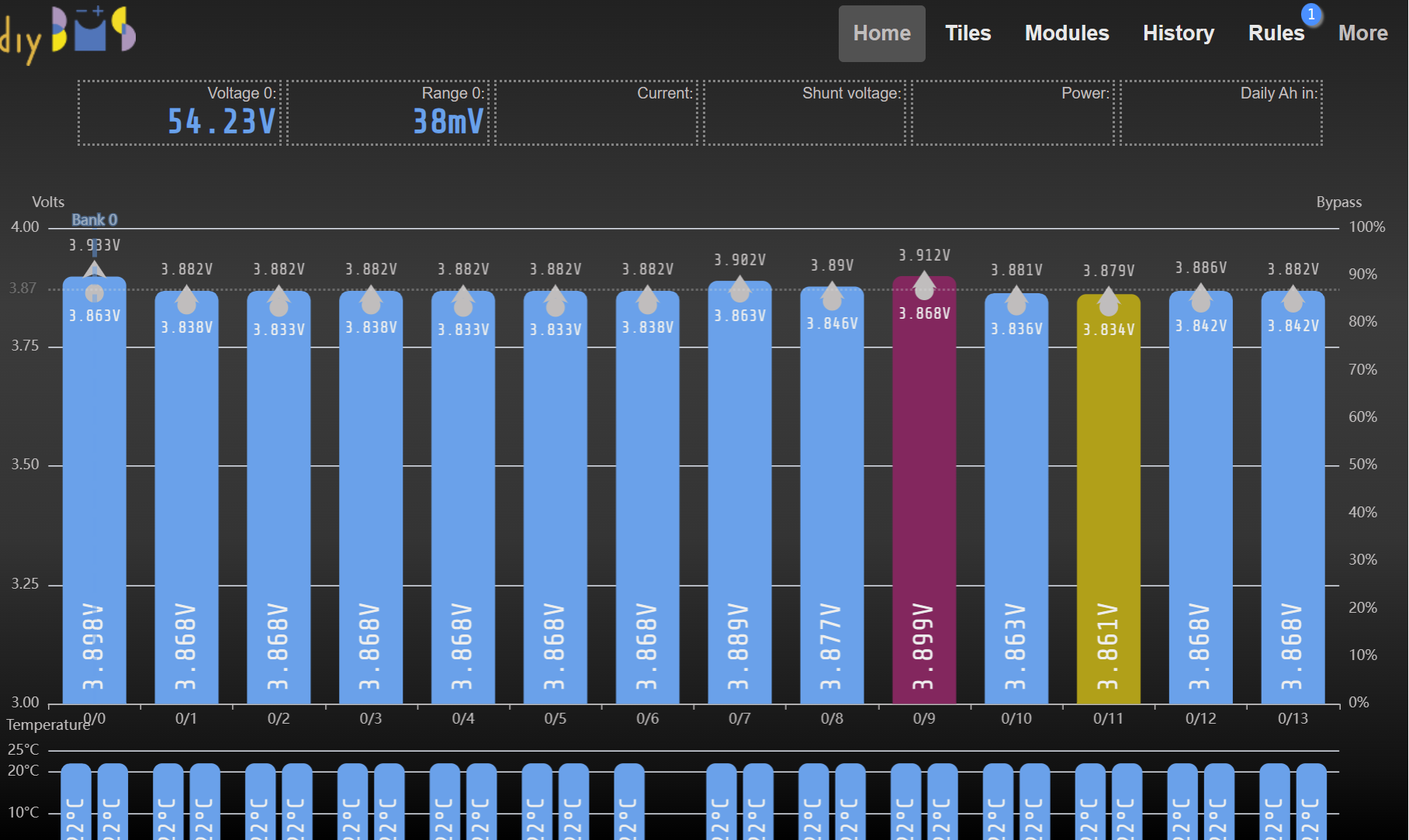

ok, this explains the low readings i thought they are only two sensors on the balance board.
i am using one external temp sensor on t1 (showing 35C in my picture, this is a resistor dummy) without this my canbus does prevent charge or discarge.

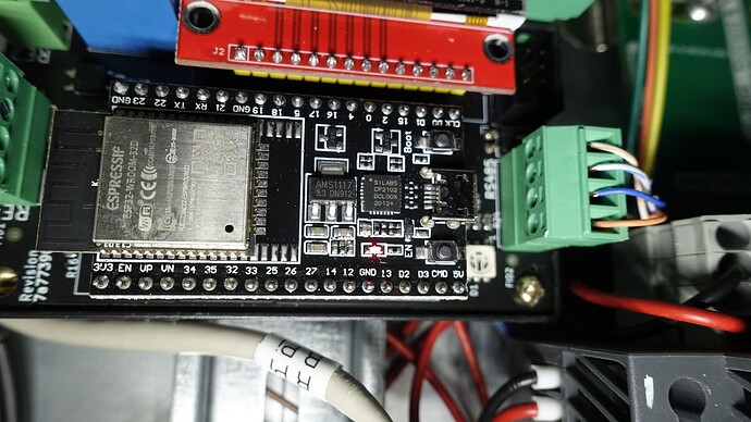

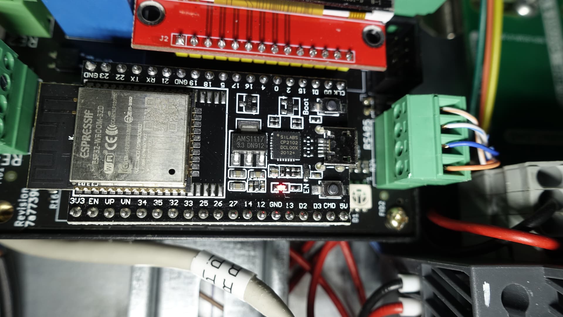

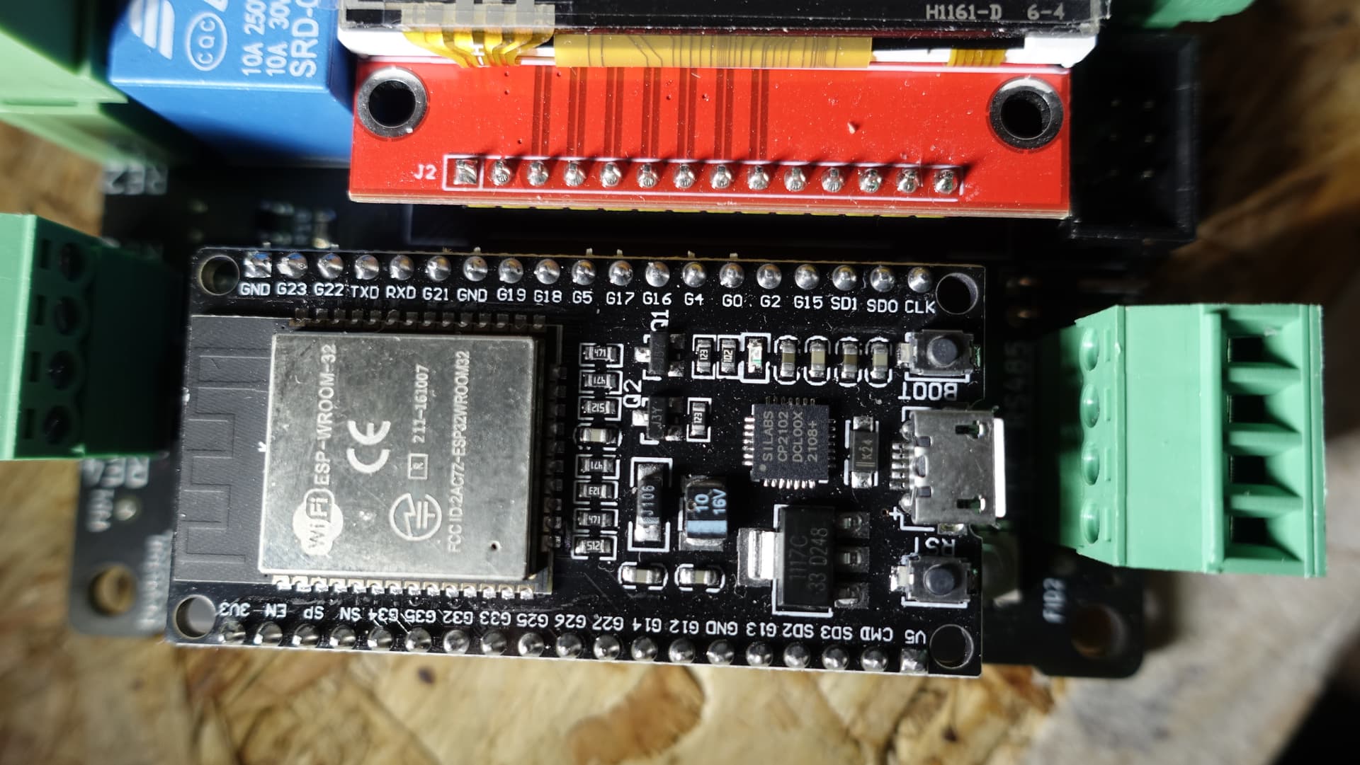

Can you get a high resolution photo of the esp32 board. Some of these have incorrectly rated 3.3V converters which only support 1A.
Im expecting that the esp22 is experiencing brown out when trying to find the WiFi point which has just vanished.
Do you have any fancy mesh network routers or anything like that?
i will make the pictures of the esp tomorrow.

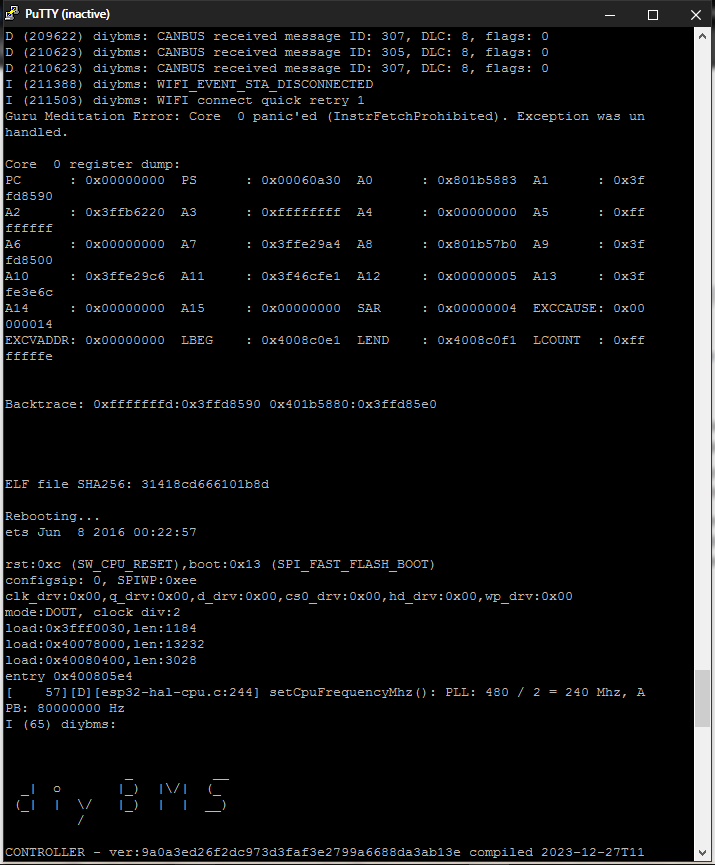

Can you get a copy of the USB serial output of the ESP32 when the WIFI crash happens?
@stuart

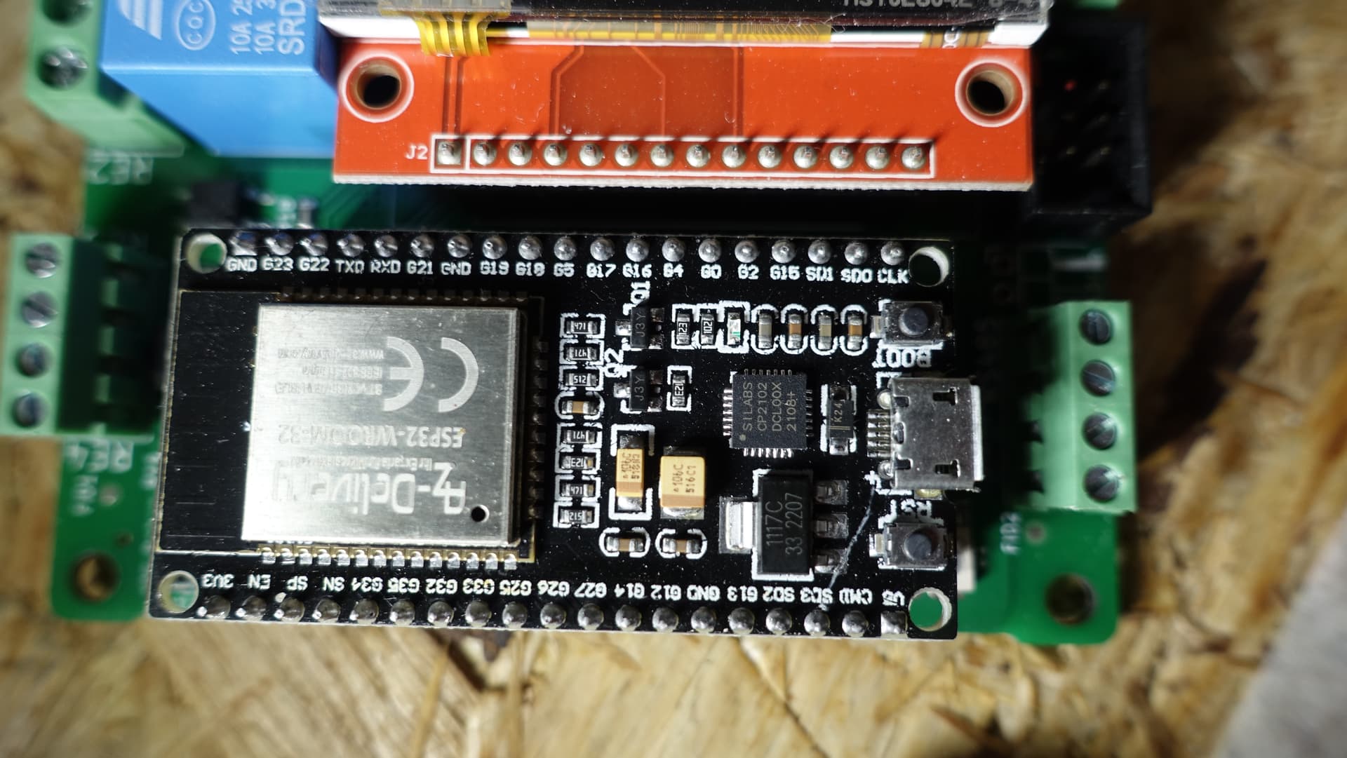

ok here the hardware images and the serial log i have a textfile too
bms wifi crash.txt (1.7 KB)
Which one of the three different ESP32 devkits produces the crash? The crash log looks like something is accessing / using one of the flash pins of the ESP32, but I’d expect that to crash much earlier during startup. @stuart are you doing any operations from the WiFi event callback beyond a call to esp_wifi_connect()?
I’ve seen some people reporting odd issues with the AZ-Delivery ones at times. I’m not 100% certain what brand that first one is but it’s not an Espressif made modules on it. The third one kinda looks like a DevKit rev 4 PCB (it’s made to fit both WROOM-32 and WROVER-32 modules), I don’t think it is from Espressif but I could be wrong.
all of them, same problems. reboot if wifi signal lost

In the code, I’m capturing the WIFI_EVENT_STA_DISCONNECTED event, which then stops the web server (httpd_stop), MQTT and MDNS services on the ESP32.
I’m also calling esp_wifi_connect() at this point which is where the WIFI connect quick retry message comes from. There is a retry counter so I timeout after 25 attempts to connect. I re-wrote this code about a year ago due to problems with crashing wifi.
I’m struggling to debug this problem because my ESP32 devices don’t behave the same as @voltmeter but I do have other users reporting very similar problems.
I (211388) diybms: WIFI_EVENT_STA_DISCONNECTED
I (211503) diybms: WIFI connect quick retry 1
Guru Meditation Error: Core  0 panic'ed (InstrFetchProhibited). Exception was un      handled.
Perhaps instead of stopping / destroying of mqtt and other parts a test could be done to see if commenting line 1637 could help? I know I don’t restart all services that you are today and not seeing any reboots on loss of connection to AP.
It may be sufficient to call esp_mqtt_client_disconnect and call esp_mqtt_client_reconnect in the connected handler to force recycle connections. The http server and mDNS should both automatically recover upon reconnect.
The previous problem I was trying to solve was in relation to the MQTT library - that was crashing if the wifi connection disappeared, it would still try and connect and after a few attempts trigger a ā€œguruā€

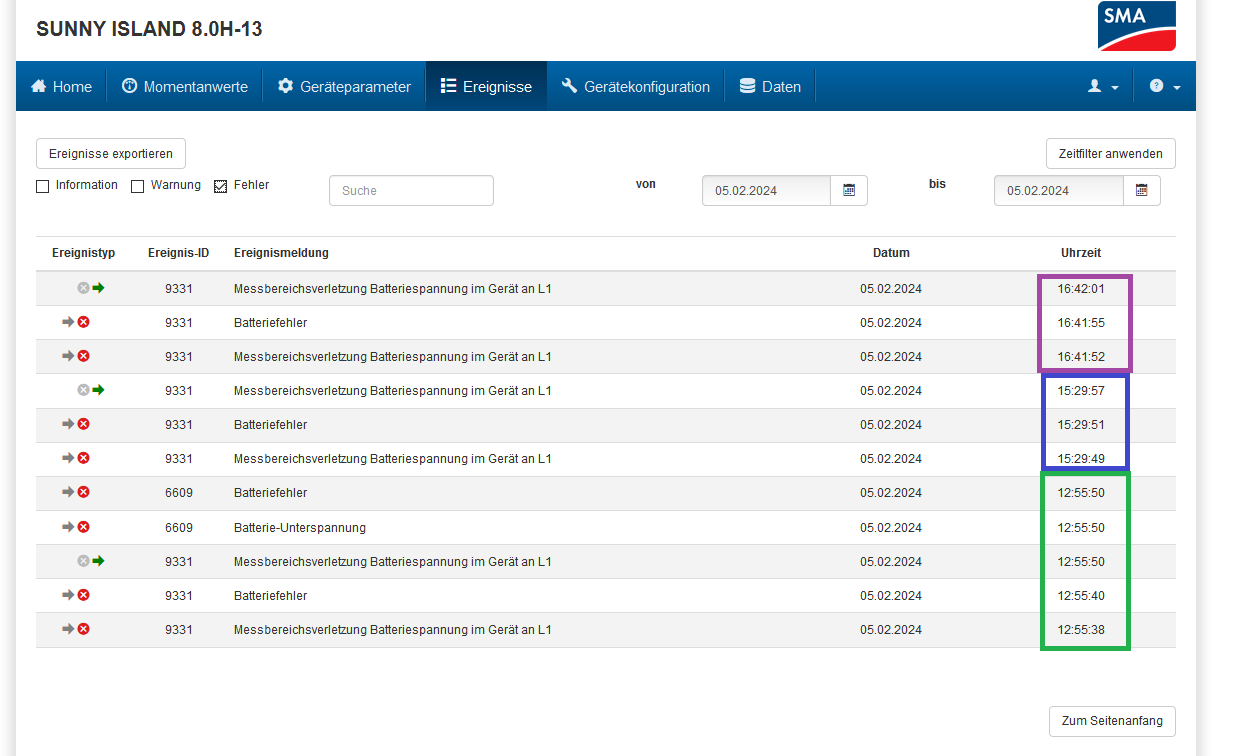

today i had 3 inverter shutdowns and one was with under voltage warning, so the inverter has not started again. i have not touched my wifi, looks like it reboots random.
thankfully my diy victron ups saved my fridge, of course i was not at home when this happened…
all with Firmware_2023-12-27-12-02
i switched to my old dumb seplos bms till this reboot issue is solved.

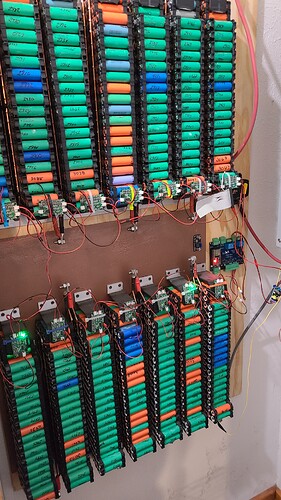

Just checking in to see how long since my last post. I have been running very balanced with my 14s100p 18650 battery on v4.2? Attiny841 boards. Just upgraded to v4.61 controller (very nice upgrade!).
I have just received my new eve LifeP04 280ah batteries (16s) and in process of putting them together.
PLan to run the LifeP04s with VOLTAGE on Sol-Ark 8k at least to start (might go canbus later) with settings to accommodate the 18650 battery in parallel to bus bars. 60amp fuse on 18650 bank, 80amp on lifeP04, think the Sol-Ark is limited to 185amps charging/discharging, don’t plan on going over 100amps.
Waiting on shunt to come in so I can populate more tiles!
