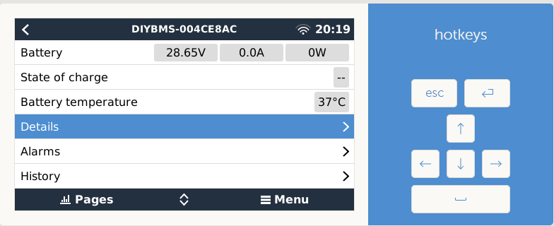

hello all,
potentially silly question (I also asked in victron forum…)
testing my proper lifepo4 bank of 304Ah, however my victron kit still thinks it’s a 8Ah bank as I had it configured when I was testing with 4S2P 18650 cells.
Now for the life of me, I cannot find where I’ve put this 8 in the diyBMS interface, could someone please help?
Thought it was in Settings, but there isn’t something there!
and:
cheers
V.
If its the value in diybms, its in the current monitor settings…
