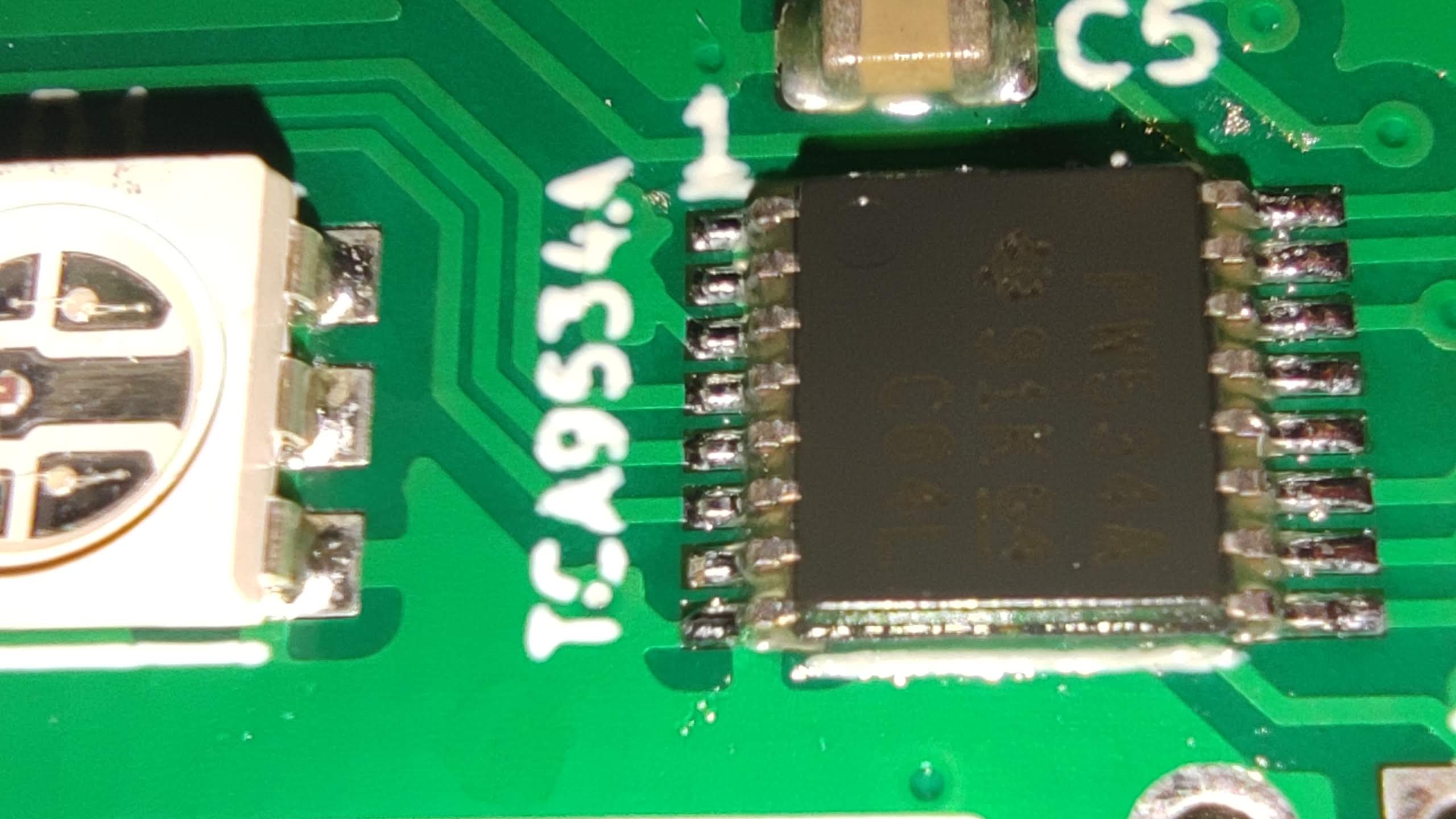

how does the function of the controller with this fake chip manifest itself?
In my case, the TCA9534 chip somehow identifies itself.
[I] [HAL_ESP32.cpp: 232] ConfigureI2C (): Configure I2C
[I] [HAL_ESP32.cpp: 291] ConfigureI2C (): Found TCA9534A
[I] [HAL_ESP32.cpp: 321] ConfigureI2C (): Found TCA6408
But the LED (D1) does not light up in any way, even though everything else seems to be working.
Do not think that problem is in TCA9534A.
Check D1 LED orientation. Check solder joints of D1 and resistors near to it.
Take a picture with D1 LED, resistors, and TCA9534A clearly visible.

I soldered another 4 PCB controllers and everything is fine here.
It is not yet washed after soldering…
TCA9534A from Aliexpress with designation PW534A (NEW 10PCS/LOT TCA9534APWR TCA9534APW TCA9534A TCA9534 PW534A TSSOP 16|Battery Accessories & Charger Accessories| - AliExpress)

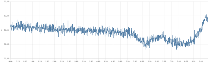

P.S: mi little hardware upgrade: 10n ceramic smd capacitors placed directly to R4 and AZ432 - Its filtered HF interference, voltage measurement curve sended on MQTT is smoothing.
without capacitors:

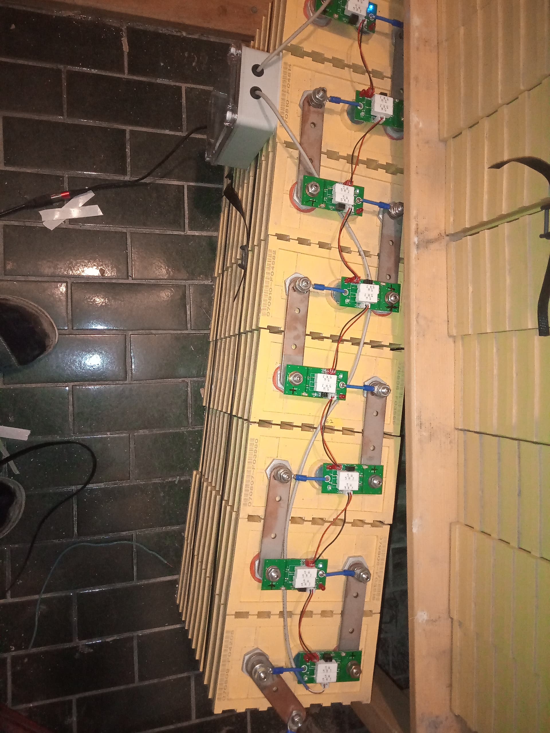

it is two separate 16s lifepo4 akupacks with diybms V4.4

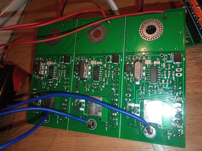

Can you share a picture and parts that you applied?

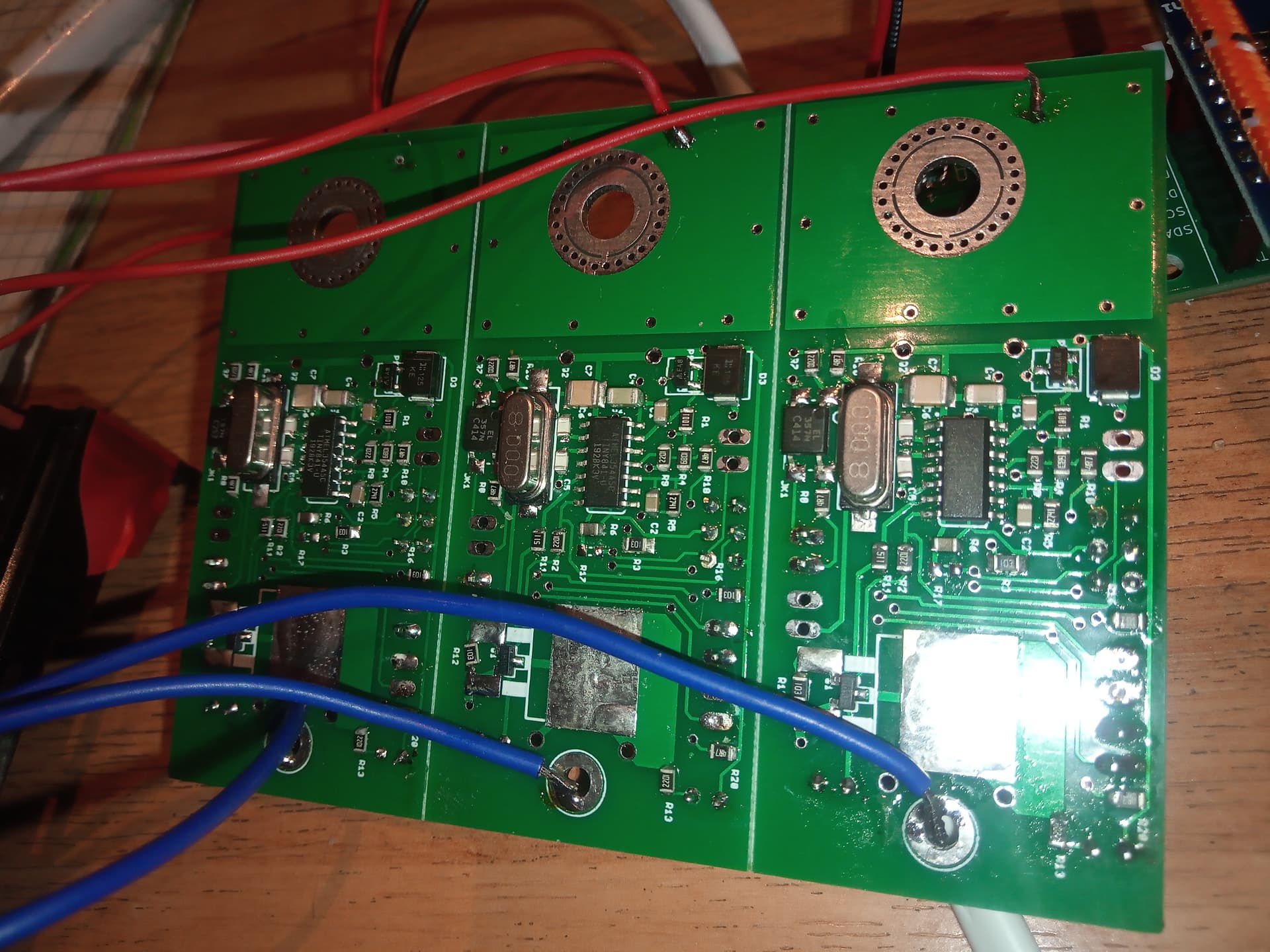

I have specific design board:
C1 and C2 on my board. Numbers parts not correspond with original design…

Thanks everyone involved in the project, especially Stuart. Btw i wonder if the module could turn into bus bar between 2 lifepo4 battery? If so i would love to make 1, thanks

Do not do this. Why? Because bus bars always one less than battery cells. And it is not an only one issue.
