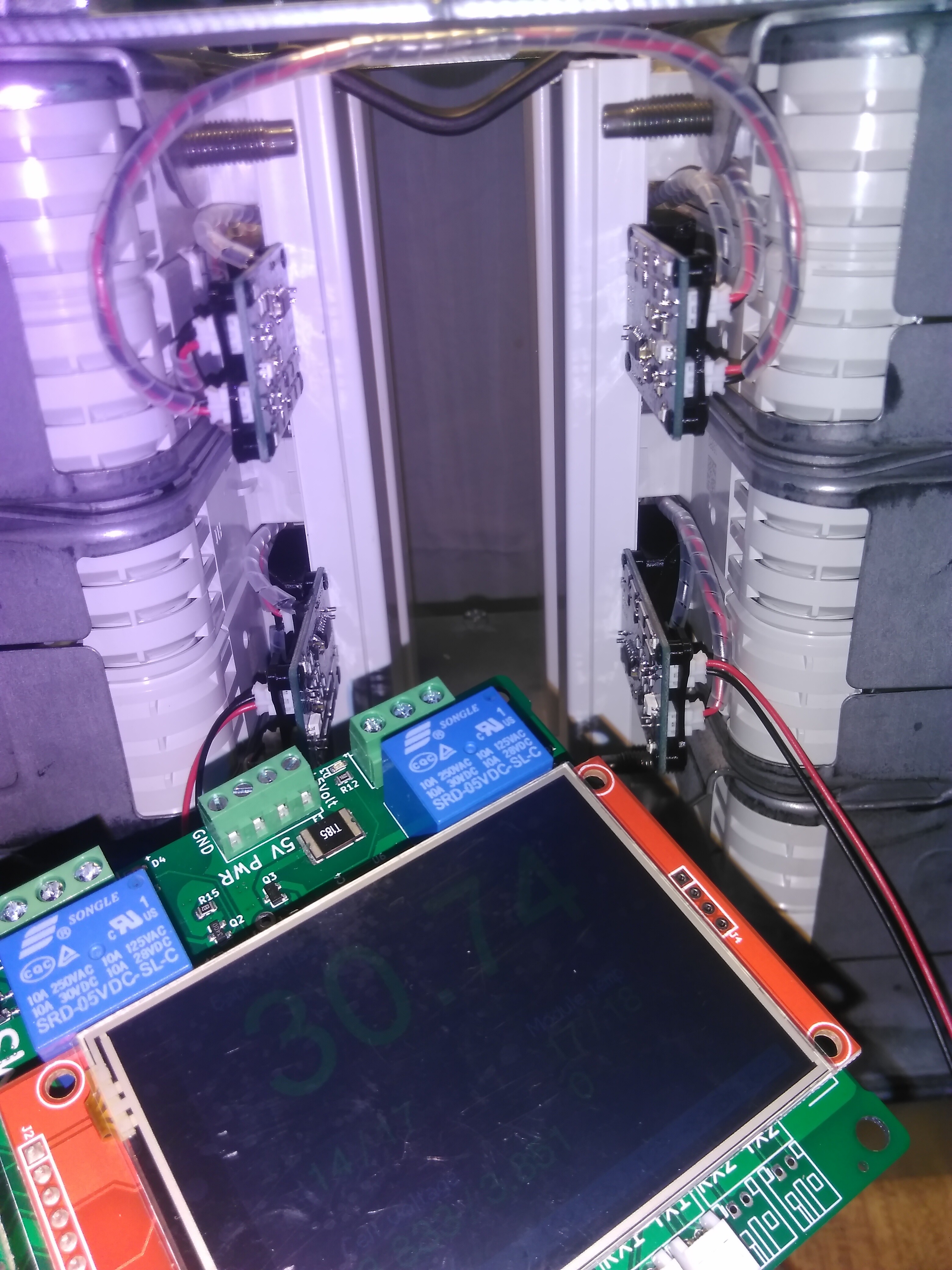

@stuart your work is great addition to DIY world, thank you for your hardwork. one step closer to my power wall.
quick question: do we have that LCD model number or link ?
i think i can reply to my own question,
It should be in the BOM file on GitHub, it’s a TFT display from Banggood.
Last time I looked it was out of stock.
