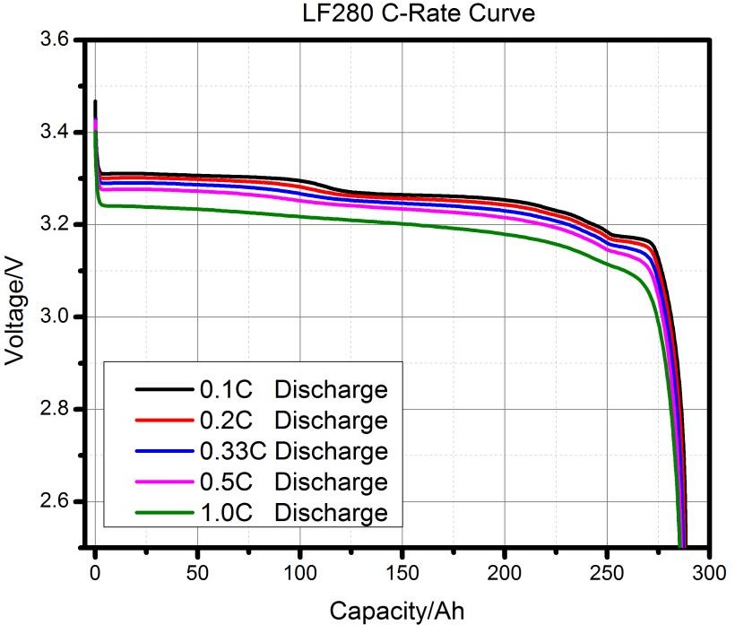

I would raise the cell under voltage to around 3.175. There isn’t a lot of capacity below this voltage with LiFePO4. If you have the battery spec sheet you want to stop discharge right at or before what is called the knee. This is the point where past it the voltage falls off fast, almost straight down.
The cell over voltage looks good. No real capacity gain above that voltage. LiFePO4 batteries stay pretty well balanced once the initial balancing is done so the bypass voltage looks good. Once the packs age you may need to drop it down so the packs stay balanced.

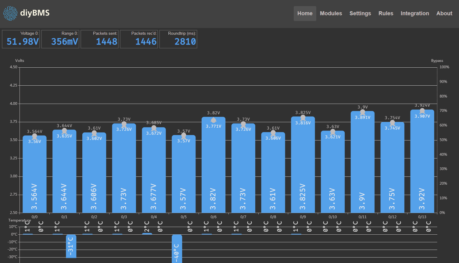

Have i killed a cell module?
Reverse wired, now its giving incorrect readings?
It may of just cleared out the EEPROM memory of the module/attiny processor. Try reprogramming it again and see if that helps.
Thank you Stuart, i think its ok now, i just re calibrated all packs to my multimeter and it now looks like this
2 modules are giving incorrect temps, but i shall worry about those another day.
Ok, that is strange though! Are these V4.21 boards from JLCPCB ?
yeah but i had to fit the thermisters, im guessing that i screwed up the thermy soldering on pack 2, and pack 6 was ok until i cross wired it, suspect that board needs replacing now, but will monitor it and see how it goes.
Ah, ok, explains it, those parts are TINY !

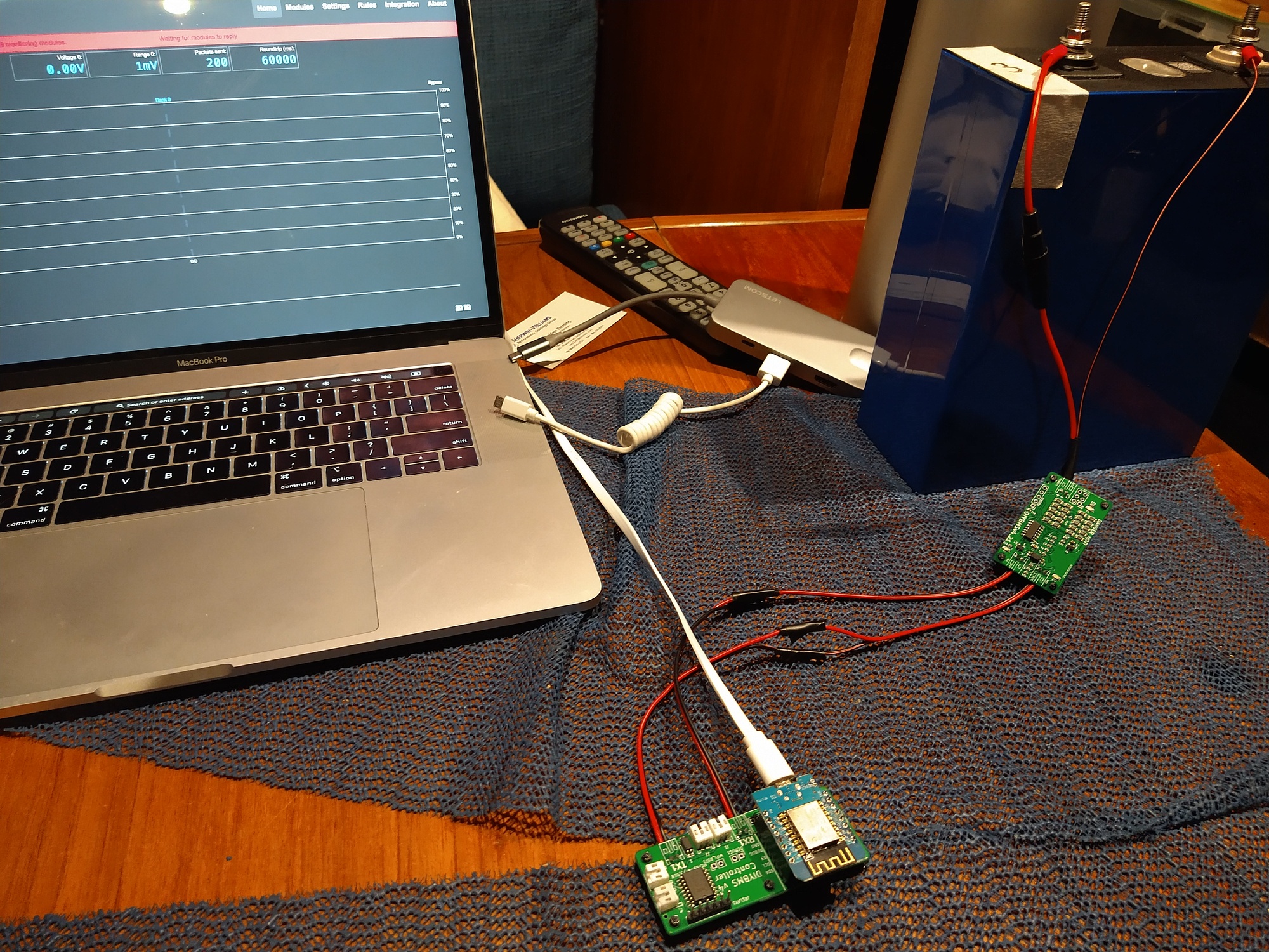

Hello, I missed something and probably it is something stupid. But last year I made a proof of concept with “white” controller software and everything was working fine with Lion
This time I updated to latest software (even moved from PlatfromIO to suggested ways on GitHub - stuartpittaway/diyBMSv4Code: Software for diyBMS v4, especially as couldn’t figure out how to do hard reset on Wemos to forget old wifi pass). It is Lifepo4 battery now and thicker ~22awg cables.
On boot controller led lights up a bit and then goes off, Wemos blinks once in 4s or so. Module’s blue light blinks twice though goes interchangibly with green when connecting and disconnecting from the battery. Module is v4.21. And it is receiving 3.29V from the battery.
Controller is 7 June 2019. RX on controller is getting 2.972V and TX is just jumpy from 0.5mV to nearly 1V (it is hard to catch it on voltmeter).
Please help, because I am starting to loose my mind as have started with 4 modules and batteries and ended up with one, also changed controllers and wemos and it is still not working…
