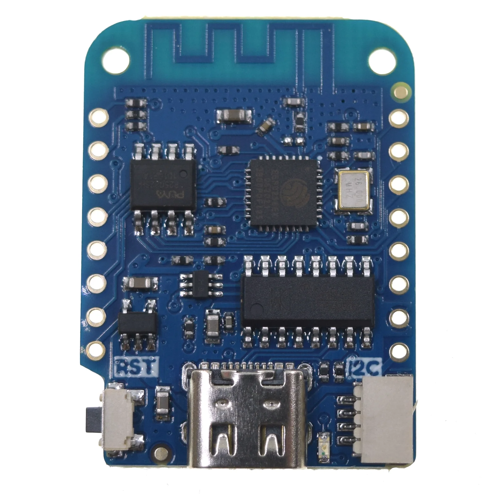

Just in time, ordered, any recommendations for WeMos D1 mini Pro ?
Its a bit of a wild west on those, if you are lucky Amazon have them, but a lot of people have ended up with clones with incorrect power supply chips (too low current).

Only safe place is direct D1 mini Pro — WEMOS documentation
I buy a few at a time.
@TrystanLea @glyn.hudson could the shop stock genuine ones?
Interesting the version on the website (v2) now comes with a “Lithium battery interface, 500mA Max charging current”
Sure, we could stock a few, Just to double-check is this the correct one:
@stuart is this the right one?
No - thats the 4MB version not the “pro” one.
This one appears to be the official one…
