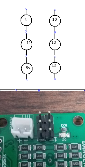

I tried moving the jumper and using the external antenna, but no change. Just for fun, I built a second controller board and tried that, but also no change. The new 8266 should be here in the next day or two.
If you’re using the D1 mini pro with optional external antenna you need to move a resistor or remove it and put a solder blob between the two points to enable the external antenna header. Just gets a 90 degree switch.

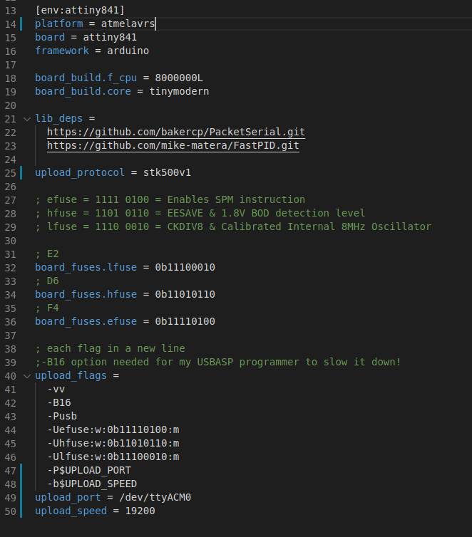

Once you flash your Arduino to use for arduino isp the port isn’t /dev/ttyUSB*. It will be /dev/ttyACM*. “dmesg |grep tty” should show that.
Thanks. I was able to rotate the jumper, but it didn’t fix my WiFi issue. I didn’t think it would, but it was something to test.
usb 1-3.3: ch341-uart converter now attached to ttyUSB0
legend!
now to get figure out why avrdude.conf or .avrduderc isnt seeing it.
Once I put my Uno clone in isp mode then uploading from platformio was a piece of cake. I could sit there and flash one, wait for it to boot, disconnect, repeat. Worst case you hit upload a second time and off it goes. Never edited a config file. Always use Linux. If you get nowhere let me know. I’ll record the process and see if it helps.
I’ve been at it a couple days now and dont seem to be getting anywhere soon. I would greatly appreciate it if I could either see the process or have a gander at your .config as that seems to be the issue. Even the man page doesn’t show an example .conf so I’m really looking for that atm.
Maybe I need to start again from scratch on an rpi with a direct port…
But yes, a recording would probably work wonders.

The new 8266 arrived today and it works. I don’t know why the old one wouldn’t create an AP or connect to my WiFi, but the new one does. Thanks for the help!

IIRC I had to edit the upload protocol and specify the port was all. See the images and hope they help! There is a typo in there. I hit a key before the screenshot. platform = atmelavr (no ‘s’).
Legendary! But, other than your beautiful syntax :wink: I got about that far as well.
So what programmer board are you using? I have an attmega2560pro and have connected the bms board to the icsp header. I used arduino ide to set it up as an arduiono isp. No joy there.
Otherwise I’ve tried using an esp programmer hw305, it should work…its recognised as ch341-uart, but also no joy.
One thing I did figure out is the EEPROM.h, originally I was using the esp/EEPROM.h and what I really needed was avr/EEPROM.h, maybe that deserves some documentation…

I’m using an Uno clone that I’ve had for years. It has all worked flawlessly once I made the couple changes shown above. protocol is where I was initially hung up but Goog showed me the way. Then just port and I set the speed to something I knew should work without issues.
