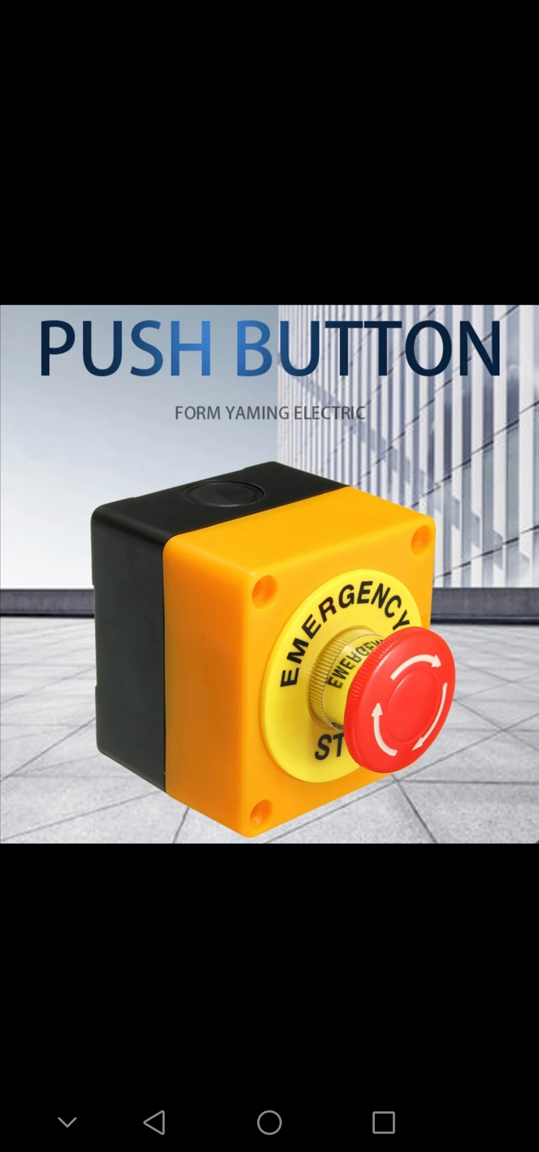

I indeed have mushroom emergency stop button.
J1 will course the relays to disconnect?
(I will have contactors on 2 of them, for charge and discharge)

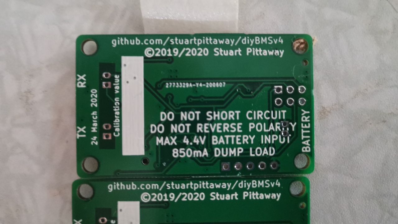

I have an other question, it’s about the dump load.
Standard the small BMS PCB can do already 850mA.
I remember reading about that cool block will increase this capacity.
I’m curious how much it can burn off with the dump load with small cool block and active cooling fan
Most BMS can do +/- 200mA, Daly BMS 35mA.
The 850mA is already a lot more then ā€œcompetitionā€.
I didn’t have the pleasure yet of burning extra charge during top balance.
And have no idea how high this in theory can get.

It just triggers the rule - so the relays would do whatever you program them do to in that situation.
