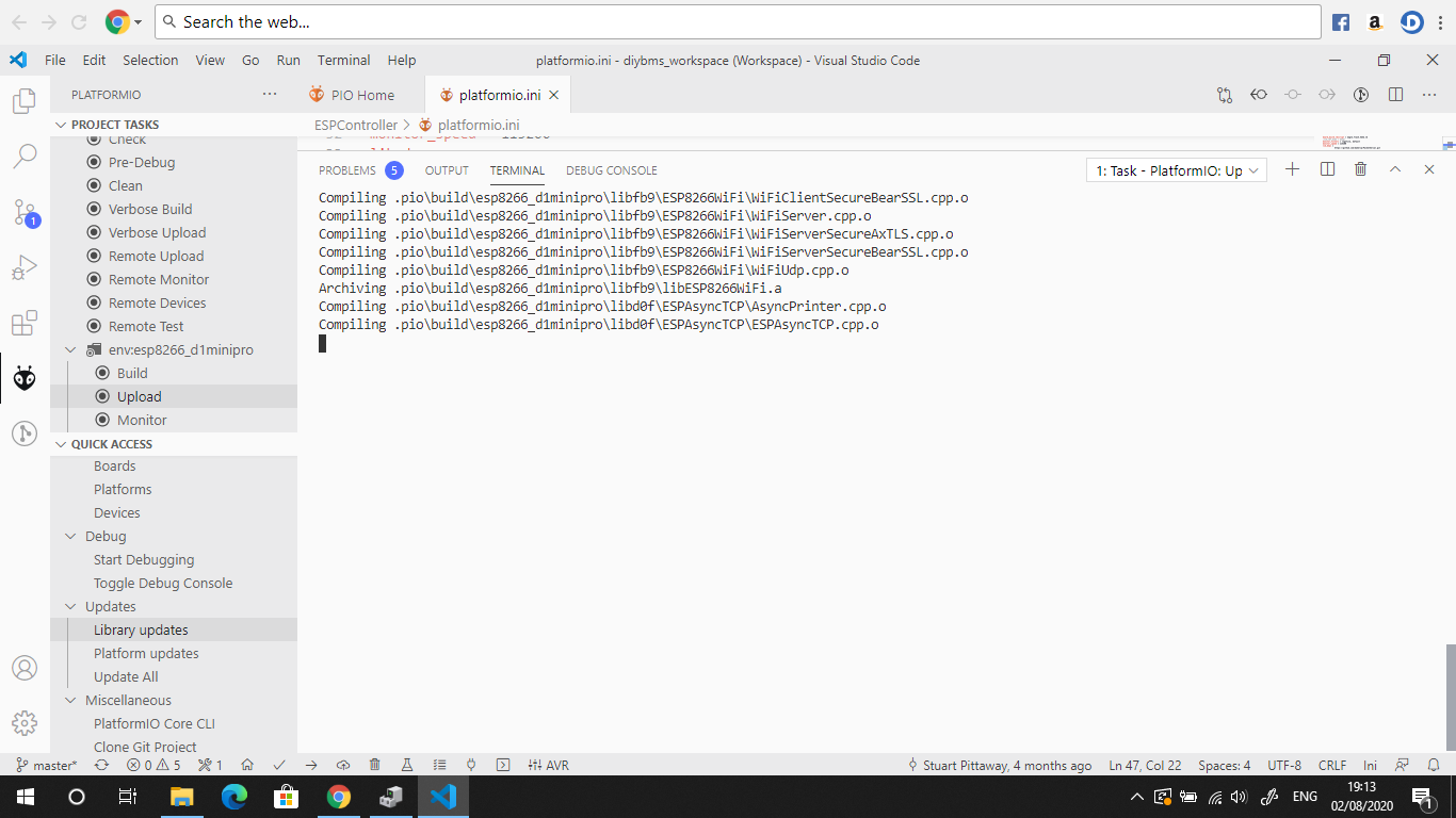

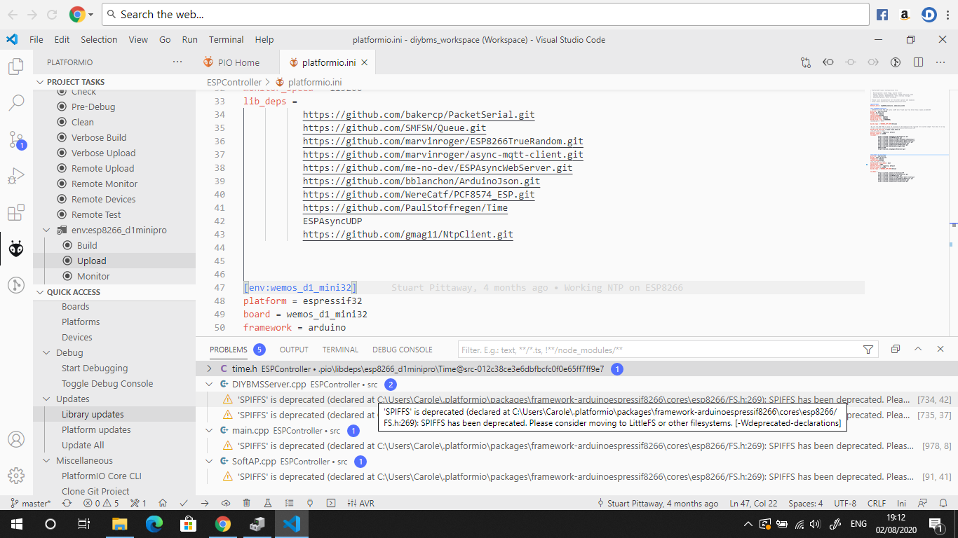

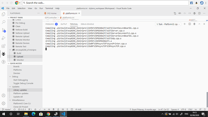

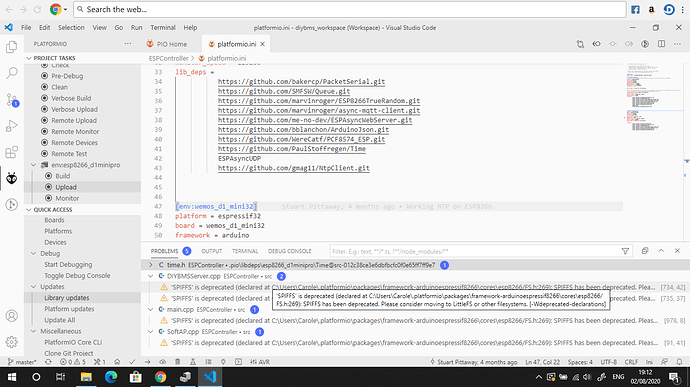

I am getting the following problem when i upload in platformio.
I doesnt finish the compile.
Many thanks
Mike
The SPIFF warning can be ignored. If there is an error it will be further down the page.
Hi Stuart
The compile doesn’t go any further than that for some strange reason. Doesn’t say completed.
