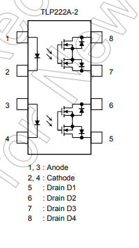

Sorry should have given a bit more context to them. Using a 3.3v supply, 560Ohm R, LED Vf of 1.3 (max from TLP222 datasheet) it results in 3.57mA current through the LED using LED Resistor Calculator. From the TLP222 datasheet it lists 5mA as the minimum recommended current for the LED. To hit the 7.5mA typical/recommended target it would need to be ~266Ohm R. A 240Ohm R yields slightly higher at 8.33mA.
Normally Watts are tracked for thermal dissipation purposes, as an example the TLP222 devices can dissipate up to 400mW per detector and 50mW per LED (there are two LEDs and two detectors in the package I believe).

Oh no, I have no clue what that Vf means. I saw it but couldn’t make sense of it and decided ignoring it was my best option (yes, this is pathetic, but I am a novice and can’t absorb everything at once). How are they getting 1.3v across the LED? Am I being an idiot for assuming the diagram is showing me that there is just an LED between 1 and 2? Is there some sort of voltage divider? Untitled

Vf is the forward voltage - V for voltage, subscript f for forward. It’s the voltage that appears across the LED when it is passing a current, i.e. lit. On low voltage supplies like 3.3 V, you most definitely cannot ignore it, because it amounts to a sizeable proportion of the circuit voltage.

Voltage Forward from the LED it is used for calculating resistor values.
The LED itself has that rating, many SMD LEDs are between 1.1v and 2.0v.
There is an LED between 1 and 2 and a second on 3 and 4.
Nope, that is why you need to have an external current limiting resistor.
