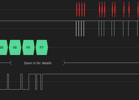

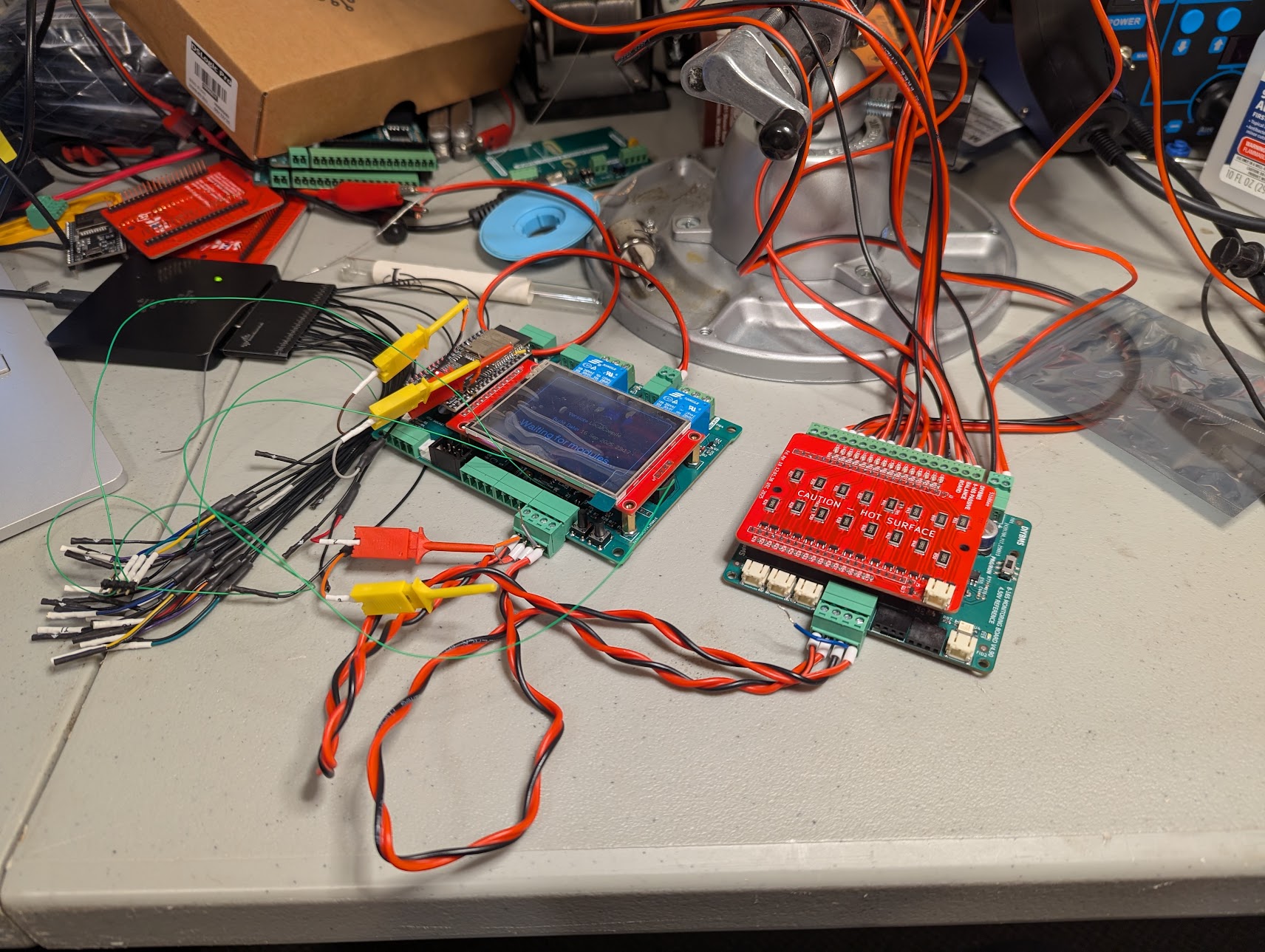

I am currently trying to put together an all in one 16s board and controller for a battery project I have going on. I have the controller and 16s boards built. When I connect the 16s module to the controller the two do not seem to communicate. The controller says waiting for modules. After verifying that the cables were connected correctly I hooked a logic analyzer to the comm cable. I could see both the output to the module and the response back.
After I verified that there is data flowing between the controller and the module I checked the ESP32, pins IO32 (TX) and IO2 (RX). Both pins had data on them. I took a look at the controller code and enabled some printouts, I can see in the serial output of the ESP32 that the module is sending messages and the LED on the module board is blinking in time to those sends. And I know data is flowing back to the controller but I am not seeing any receives in the console log. I am guessing that something is not configured right but am not sure what.

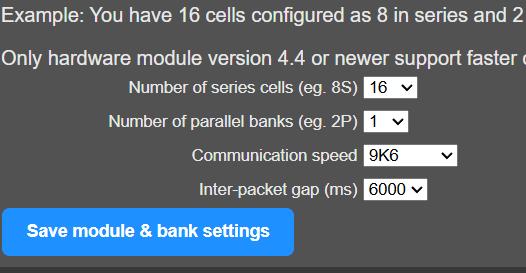

have you changed the settings?

I was trouble shooting the board looking at the data that was coming back on IO2 trying to decode the message to the module and the response from the module. I noticed that the data on IO2 did not look as nice as the data on IO32
It wouldn’t decode with my Logic analyzer either, not nicely anyway. So I checked the data coming into the controller board and it looked fine. So the problem was between the data connector and the ESP32, I soldered in some hookup wire and checked the signal on the other components to the communication circuit and the output of Q4 was where the signal went bad.
Replaced Q4 and everything worked. I don’t think that I could have found the problem without some sort O-scope/Logic Analyzer. Now on to the next step of hooking up the current shunt and setting up a test system to play around with.
