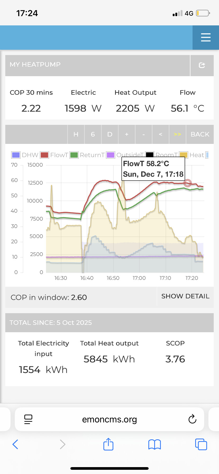

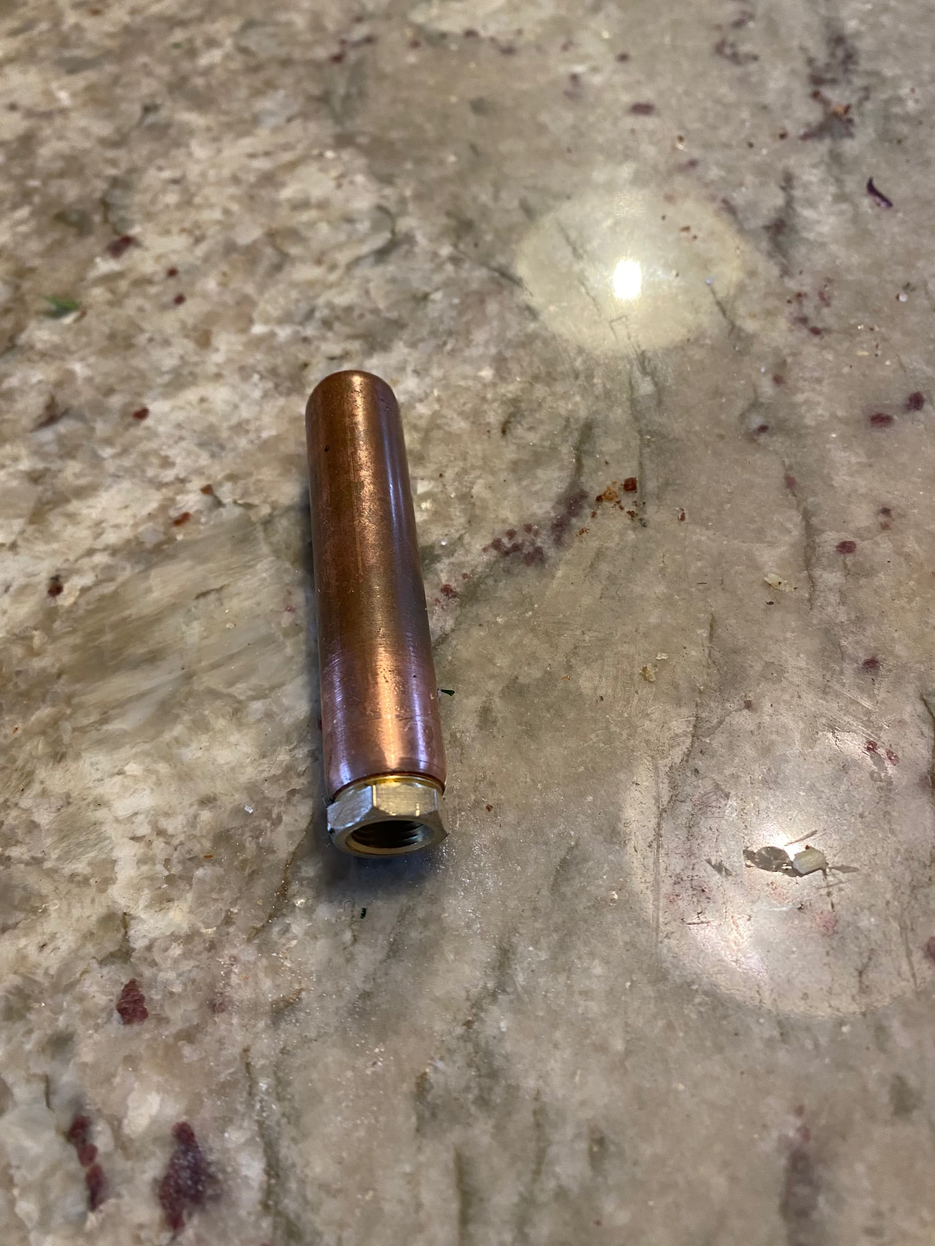

After a week or so with no heat meter errors I am starting to get air problems again. Presumably there must be a section of pipe holding some trapped air which is gradually re absorbed into the water.

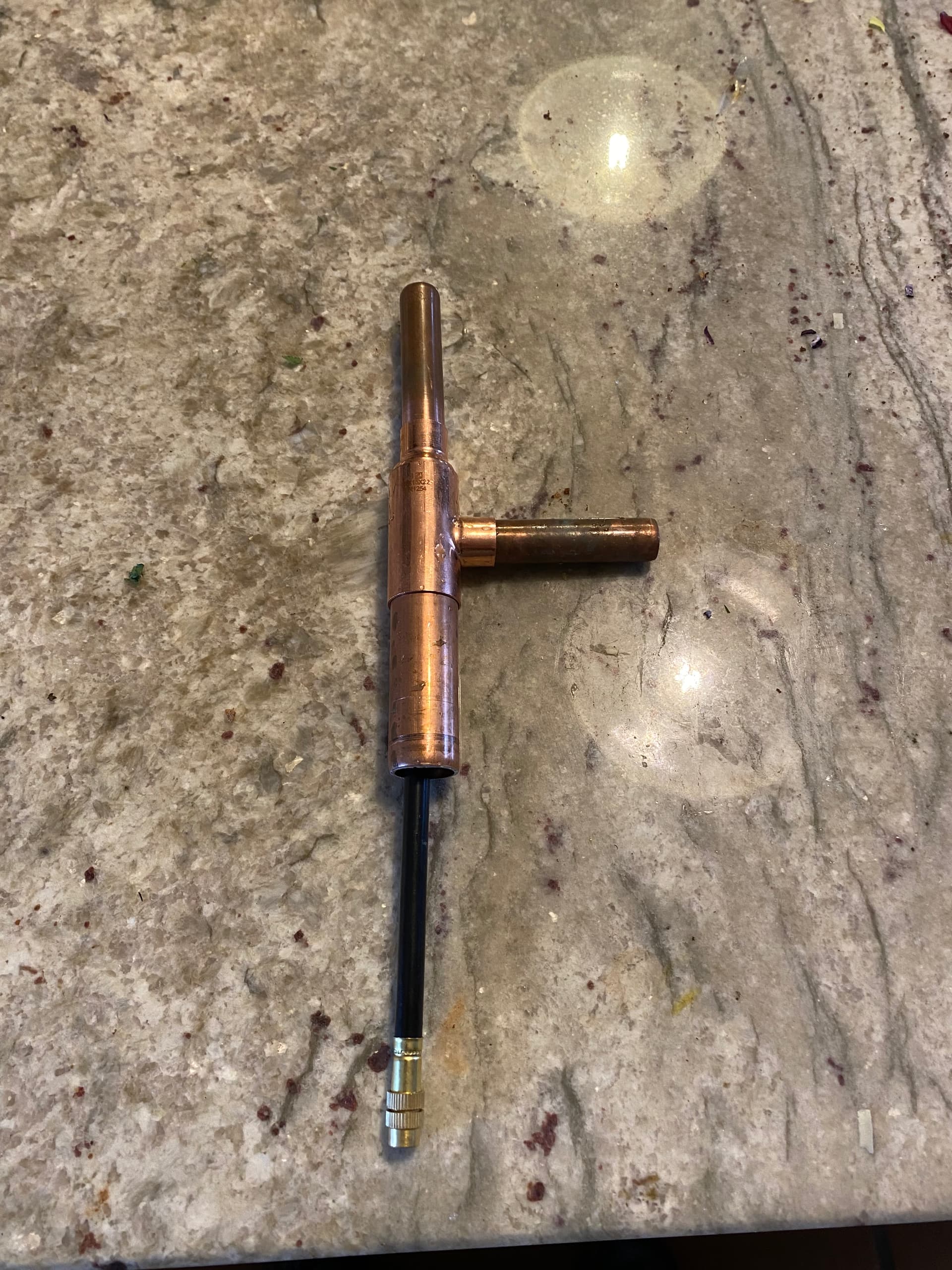

So plan is to try mk2 version - I got some spray nozzles so can try spraying the water through the vacuum tube.
So I rigged up the new version where the water is sprayed in at the top of the degassing tube. Lots of froth going on and gas can be vented by switching the pump off and letting the tube fill up to push the gas out. Doing it all manually at the moment. I have fitted a vacuum gauge so I can see how good a vacuum I can pull. When testing with cold tap water the pump can pull down to -0.8 bar , When fed with water from the heating circuit it is less effective , I assume due to the gas in the water, will be interesting to see if the vacuum gets better as the gas is drawn out. A larger vacuum chamber would certainly be better I feel to give more time for bubbles to rise.

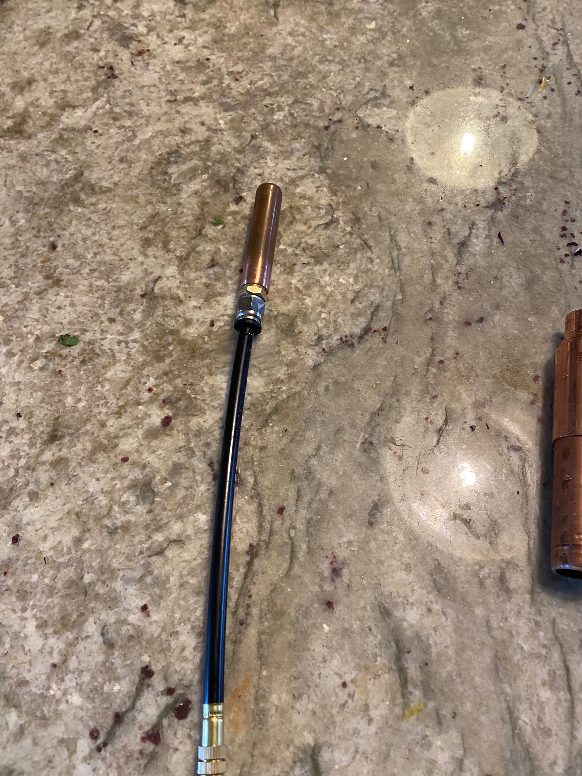

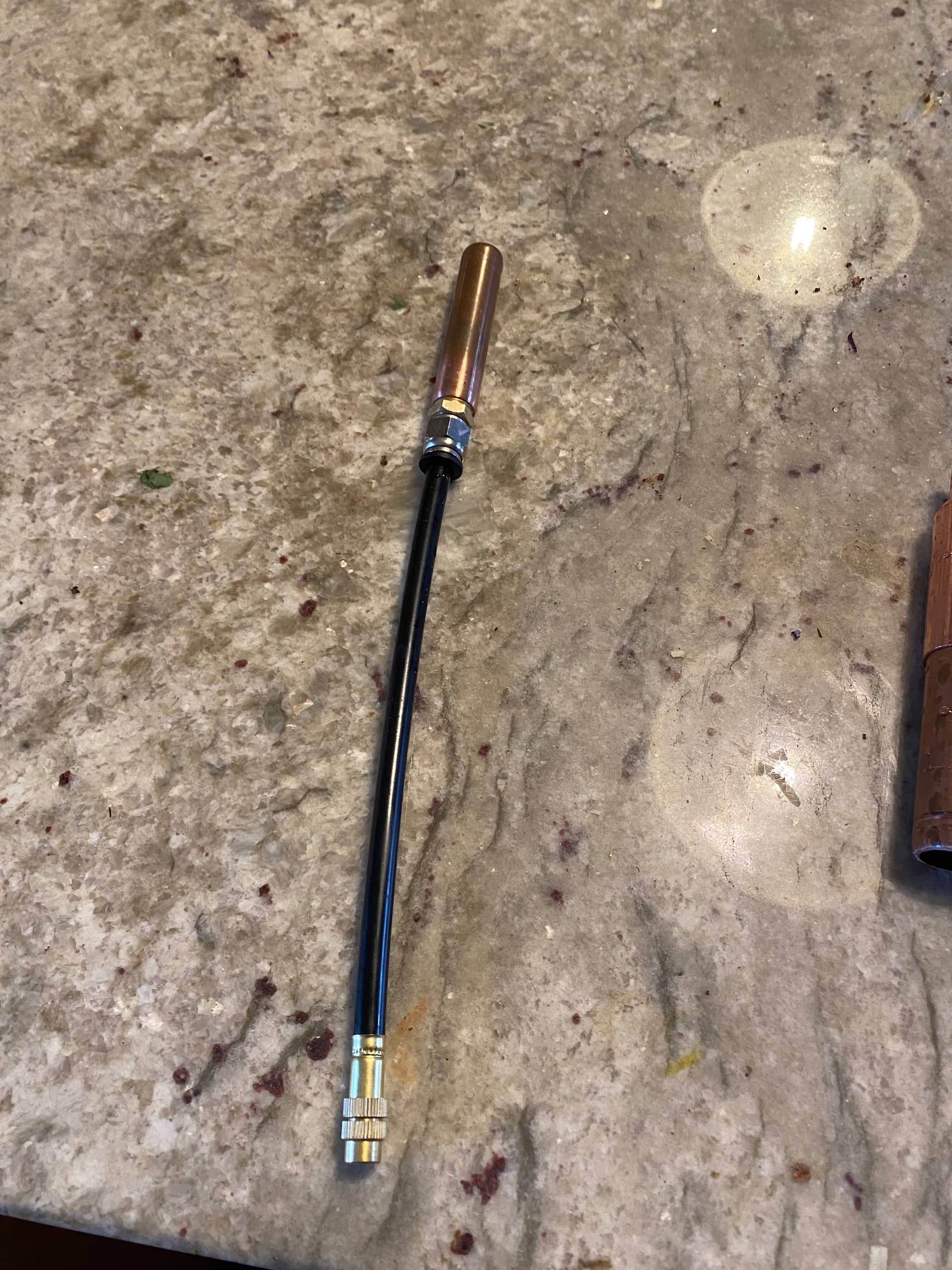

Here is the spray nozzle assembly. In fact I ran with the atomiser removed as the throughput would be very low, so the nozzle just directs two jets of water onto the side of the tube too form a thin film on the surface of the tube.
The side tube forms the vent
Link to YouTube video - sorry too big to upload directly to this site.

And the good news - after even just a short session of degassing - about an hour, my latest hot water run was heat meter error free😀. I think there is more to get out still.
Now I have the vacuum gauge I can check for vacuum tightness. After an hour with the pump switched off I still had -200 Mbar of vacuum.
Latest hot water run, got it good and hot and drew some water so quite a long run

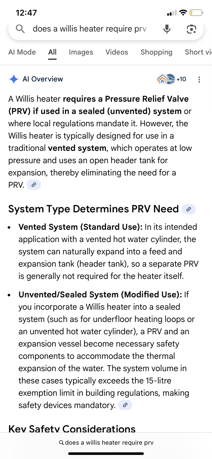

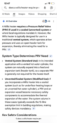

  2. Just safety - I guess Willis has built in thermostat and high temp trip out, main heating system should have pressure relief but if there are isolation valves to the Willis then I don’t think this can be relied upon , so do we need a seperate prv and it had to have a safe place to vent. Maybe Willis had such low volume it is not an issue??? Any G3 qualified plumbers out there?.
https://assets.publishing.service.gov.uk/media/5a81a884e5274a2e8ab552a5/160321_Part_G_FAQ.pdf
All in here, just needs interpretation
