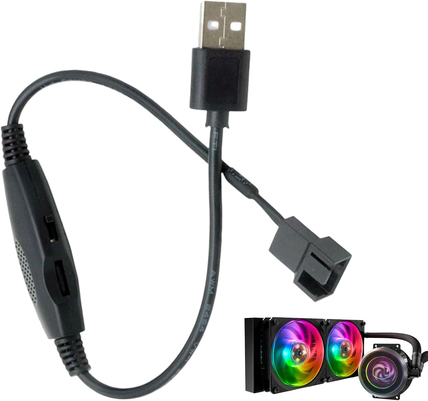

So I went ahead and bought the X5 Arctic fans from Amazon.
Also bought an adjustable controller…

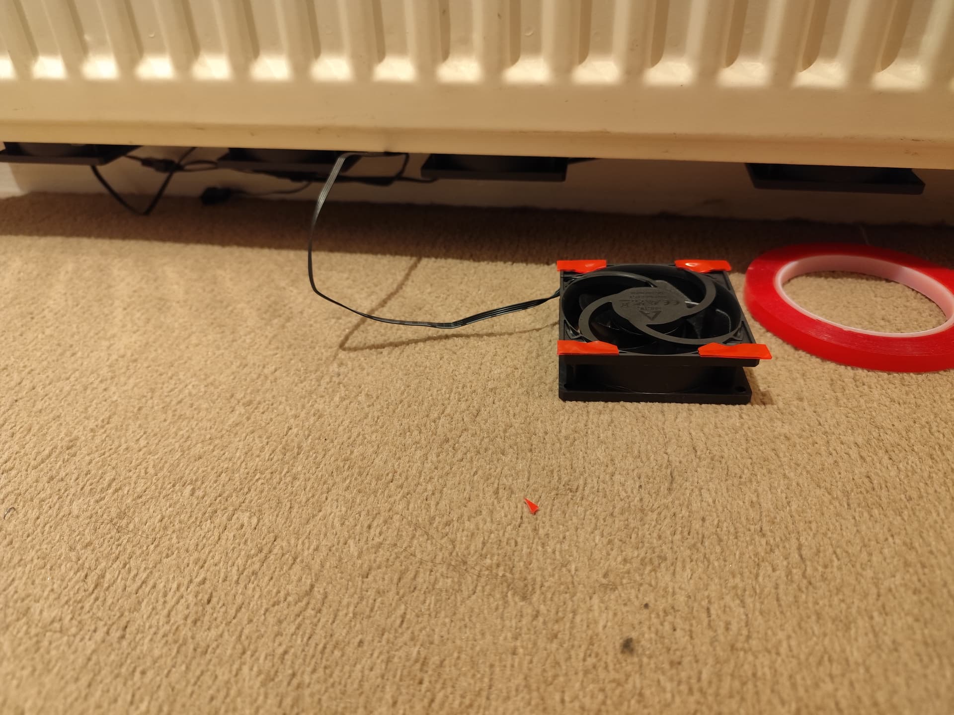

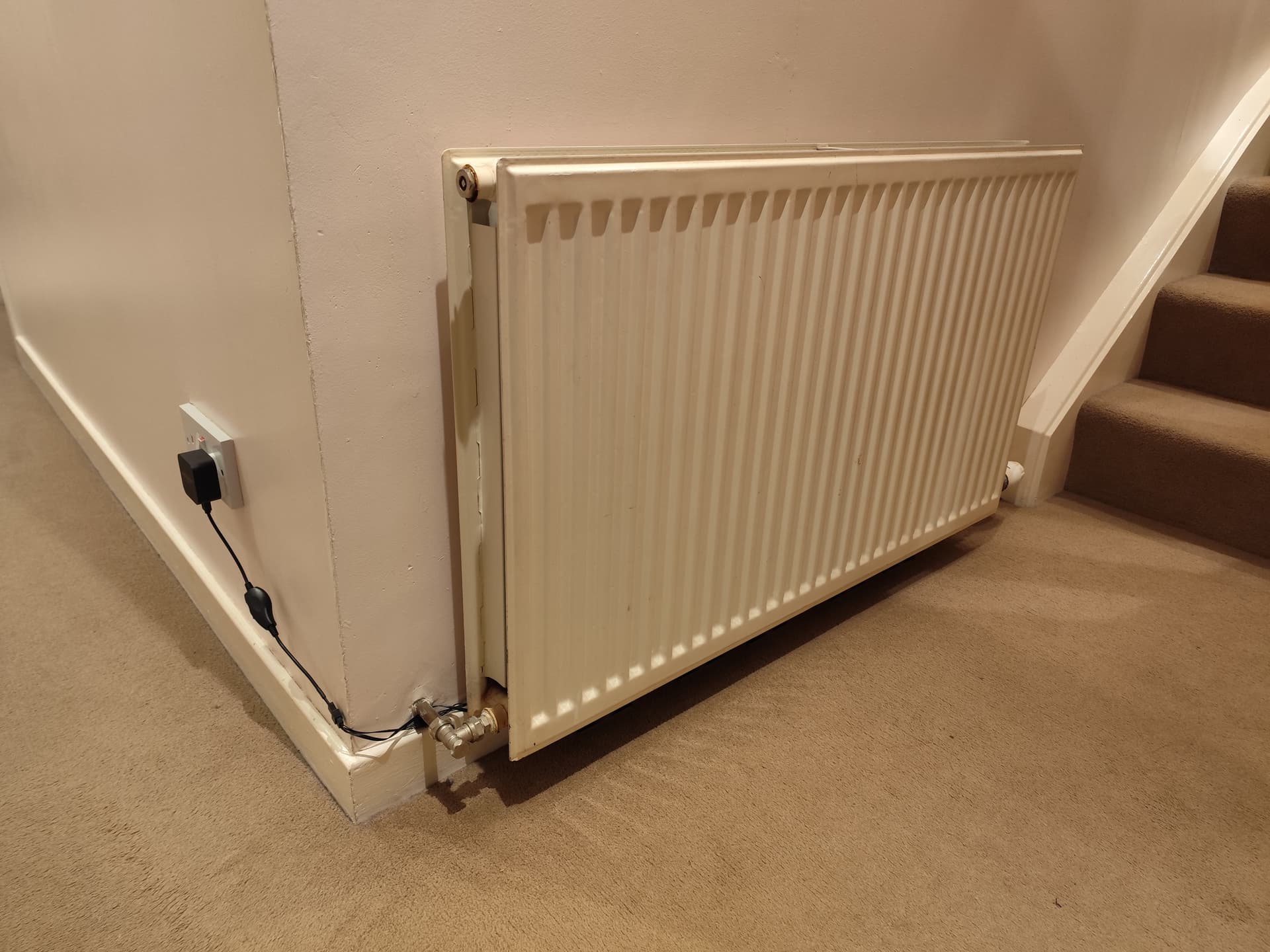

All hooked up under a big K2 radiator with an old 10W usb plug and working perfectly. The adjustable controller is handy as the fan speed can be lowered until the noise is at a reasonable level. Even after reducing there’s still a noticeable draft of warm air coming out the top so happy days.
Possibly doubled the output of the radiator for £27.
Fans fitted snugly in bottom gap in the radiator and stuck in with thick double sided tape.

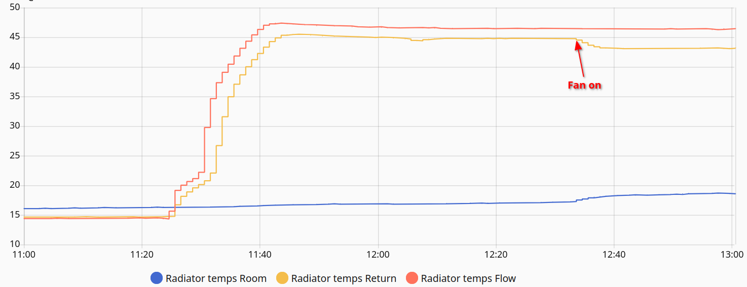

In case anyone was doubting whether radiator fans are worthwhile, I can comfortably say that they are:
Even with the crudest of setups!:
The “Room” temperature probe is 2m away on a different wall, but some way above the radiator.

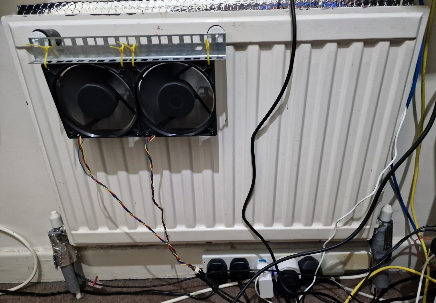

I released a new version of the code. v1.3 finally supports the LED: On boot it is red and turns green once connected to Wifi.
And just to keep the ball rolling - another new feature by request: Nighttime scheduling, which allows you to turn the fans automatically on and off at specific times.
Also a nasty bug with the web interface was fixed - thanks @ectoplasmosis for the diligent bug reporting :slight_smile: .
