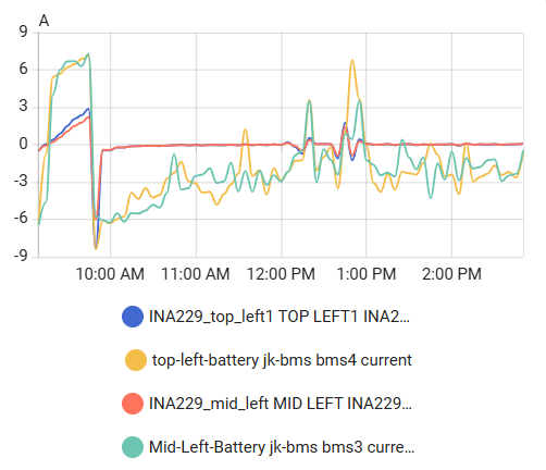

Each JK-BMS reports charging/discharging currents accurately when the system is idle or lightly loaded (±20–30A). However, I encounter a strange issue under high PV load:
When I start charging my EV (7.2kW), and the MPPTs are covering the entire load (float voltage is correctly maintained), each JK-BMS shows a discharge current of around –20A, even though the Victron SmartShunt reports near-zero battery current (±1A), which is confirmed via clamp meter measurements both on each battery and on the common busbar.
In summary:
  • VRM & clamp meters show correct current: ~0A (float maintained, PVs power the EV directly)
  • Each JK-BMS falsely reports ~–20A discharge
  • PV production and voltage regulation are normal
  • The discrepancy appears only when all loads are PV-powered and system is in float
  • All BMSs are paralleled with common positive and negative busbars
  • JK-BMS shunts are on the negative line (default)
I’m wondering:
  1. What could be causing this false discharge reading on each JK-BMS?
  2. Could this be due to ground loops, shared GND between MPPTs, MultiPlus and BMSs, or some interference?
  3. Has anyone else experienced this behavior with JK-BMS in multi-pack setups?
Any suggestions or insights would be greatly appreciated!
Thanks in advance.
I’ve recently designed a smart shunt based on the ESP-WROOM-32 module and the Texas Instruments INA229 with HA integration. I’ve just connected it to my battery banks(2), and below is a comparison between the current measurements from the JK BMS and the INA229.
