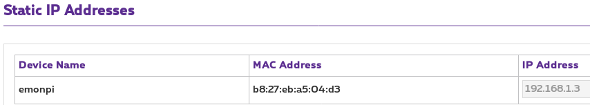

Contrary to what I said earlier, the router does allow to configure predefined IP address assignments. So just to be double sure, I reserved the IP address for the emonpi.
Router is from ISP Scarlet.
Thank you for your help!
