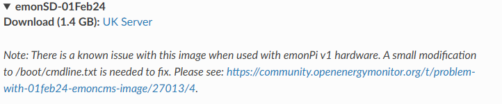

I think you are likely to have to modify your installation. Things have moved on in 10 years.
Re the emonPi V1, there is a note on the downloads page and I think therefore you should be able to get the emoncms part working again. However, as you say, the minimum feed time is not as short as you would like (I think it is now 10s).

A lot has changed since 2016, wondering if this file is mostly the same:
Nope. What I can’t understand is I sent the fistful of hashes (both the zip file and the extracted image) and he said
So the big question is why does what should be exactly the same version fail to update for me (as it should) but invoke the update for him?
Thanks, Gwil, for picking this up. I’d never have thought to look there for that. Here is the same file from the 2016 SD
