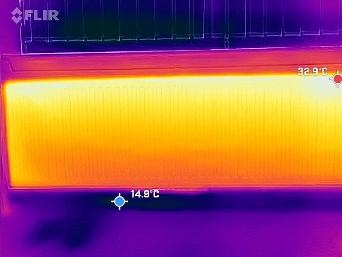

Hi Kieron,
I can’t really make sense of your radiator pictures - could you take one from further away and maybe somehow mark the rad if it isn’t self-evident where it is?
They will be warmer at the top but definitely should not be cold at the bottom, especially when flow and return are so close together in temperature. Per se the 1K difference is not a problem and my first thought would be that flow rate is very high, so with the high volume of warm water coming in it can only cool down by 1K. However, as your radiators are not fully hot, another reason would be that the water is not properly distributed through the radiators - hence my request for a wide angle IR picture of your rads.
You could also try taking an IR video if your hardware supports it to record how the warm water distributes through the rad as it comes in, i.e. close the TRV, wait for the rad to cool then open it and record. A time series of images would also do the trick.

Took the close photo initially so the colour scale highlighted the cold bottom of the rad more clearly.
Attached are wide angle. Difference between the top and bottom of the rad is around 10+ degrees
Flow rates are as folk expected (question asked to the forum earlier)
I will have a bash at the time lapse photo and get back to you.
Those look quite ok to me to be honest. There is cooling to be expected from top to bottom as the water releases its heat energy into the room. And the warmer water will tend to flow towards the top. I think your measurements of the rad flow and return pipe might be inaccurate - just the heat conduction from the radiator will make it difficult to externally measure the temperature there. I think the radiator balancing might help - you probably need more flow to that big radiator so the temperature drop across it is only 5K and hence its average temperature a bit higher, leading to more heat output. However take this with a grain of salt, my radiators are attached to a UFH manifold and the balancing works differently there.

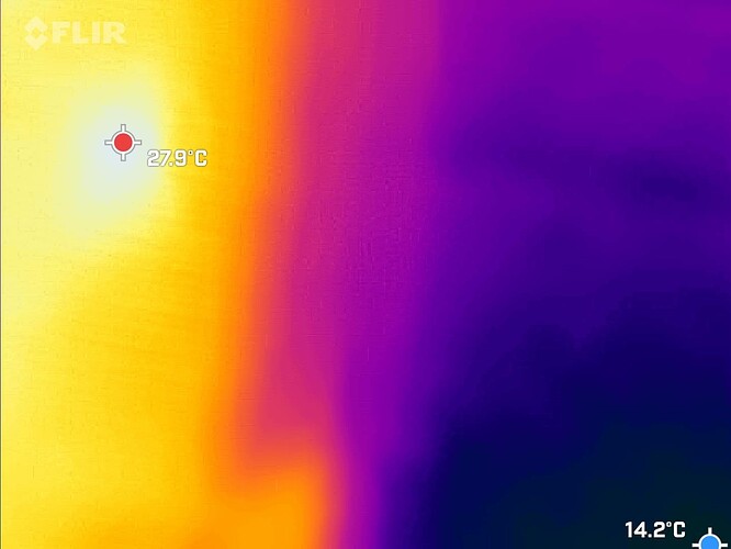

So a 10 degree difference between the top of the radiator and the bottom is normal? (Not a leading question, I have no idea/background knowledge but thought it would be closer than that.)
It’s difficult with heat cameras as the colour gradient goes from the lowest to the highest. This is why I go close up, so the full colour gradient is just for the rad, not the cooler surroundings.
Couldn’t upload a video, so took 3 photos as I move in closer. First has a pair of boots hopefully showing that the height is only around 1.5 feet. For the last bit as I move in you can see that the top of the rad is around 32, the bottom around 23 Deg.
Is that normal and in fact the rad does not need a power flush? The temp difference is obvious even when just using your hand.
The 10°C difference across the radiator sounds rather large and suggests limited flow across this radiator.
My understanding was that your unit was a 5kW Arotherm which is running at 860 l/hr. This unit will modulate down to 2kW and up to 7kW.
When running at 2kW (using specific heat formula) the unit will increase the temperature of the water flowing through it by ~2°C. In a system where you are emitting all this heat through the radiators and all rooms are balanced, the temperature loss through each radiator will be ~2°C.
Why the difference between 10°C you’re seeing and this ~2°C? Several possibilities which boil down to restrictions to this radiator or excess flow stealing the flow elsewhere on your system.
The restriction to the radiator is not necessarily something which might be removed by flushing; it might be cause by long pipe runs to this radiator or valves shut in on the radiator.
Hope this provides some help?!
I would agree with @JimR . This to me just points to lower flow across the rad. If there was sludge buildup, the cold spot would be far more pronounced in the bottom.
So you need to open up the LOCKSHIELD VALVE a bit on this, or close others elsewhere on the circuit.
To absolutely prove the point, close all other TRV’s meaning that this is the only open rad on the system, and watch it heat fully (albeit ensuring the lockshield valve is decently open)
I have to say, the FLIR is the right job. I have one myself and I have used it more with my solar system and batteries, but has been invaluable for balancing.
I fully agree with @JimR and @championc - probably you have to increase flow to the radiator. However, probably the coldest rad temperature is not equal to what comes out the return. Also, youve got quite some cold spots below the radiator. The cold air from there could well cool down the rad more. It looks somewhat similar to what my fans under the radiators do - locally cool it down quite a bit.

I closed off the trv’s in all the other rads and the temp differential on the rad reduced to 5 degrees.
So thought to open the rads lock valve but none on the ground floor, including the problem rad seem to have one…
Do I assume by this that the ground floor rads are all wide open, so I have to restrict the rads in the first floor to increase the flow on the problem rad?
