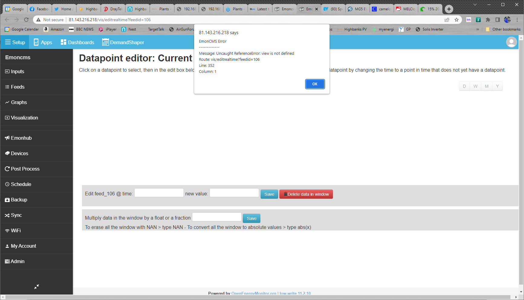

My modbus feed / heat meter values went weird when I moved my new tx4 across from rf to usb connection; no idea why but a reboot of the emon base fixed it.
However I now have 30 minutes of all the feeds from that showing 1949 (again, no idea why) which has royally screwed up my graphs.
Found various posts about using visulisation/editrealtime to fix/delete the values but it doesn’t work - when I select the feed and try to view, it pops up an error (shown below) and the data view is empty (and hence uneditable).
Any ideas?
borpin
(Brian Orpin)
2
I’m the same, looks like a bug @TrystanLea.
Reported 2 months ago.
