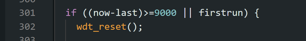

After 5 years, i finally spent the time to debug this.
Still using the original kit: https://github.com/openenergymonitor/HeatpumpMonitor/tree/master/HeatpumpMonitorTH

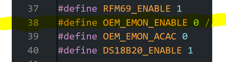

Conclusion, I had to disable the OEM_EMON_ENABLE.
Im not using the CT sensors, having it enabled was causing random delays in the script of 4+ seconds in the few mins i watched it, causing the transmissions to be delayed and missing the slots at the EMONCMS end i assume.
I had also previously reduced this from 9800 to 9000. Didnt help but left it set at this.

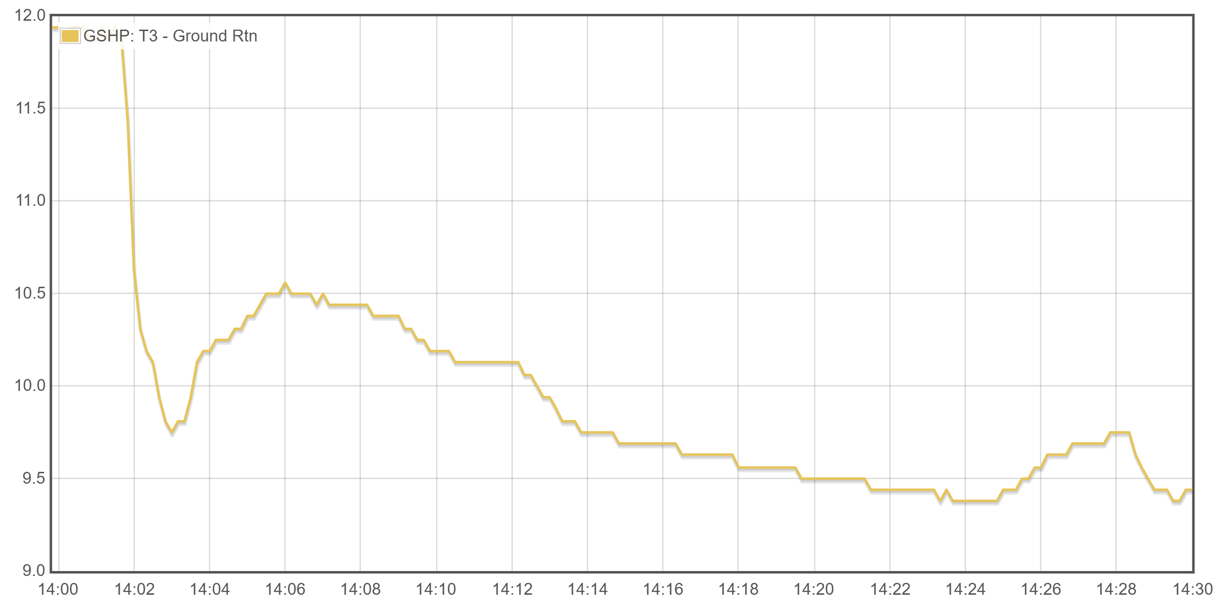

Before:

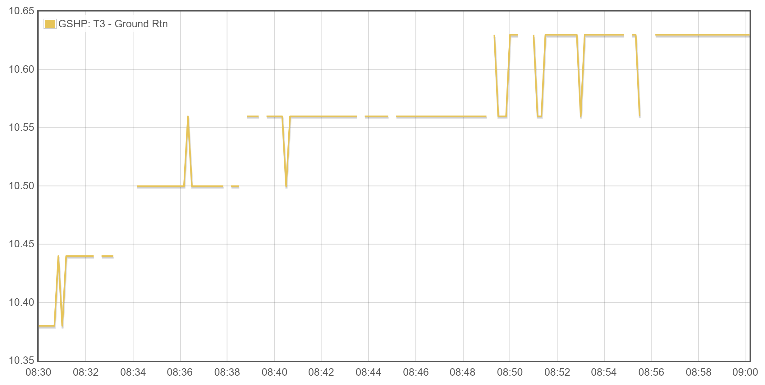

After:
