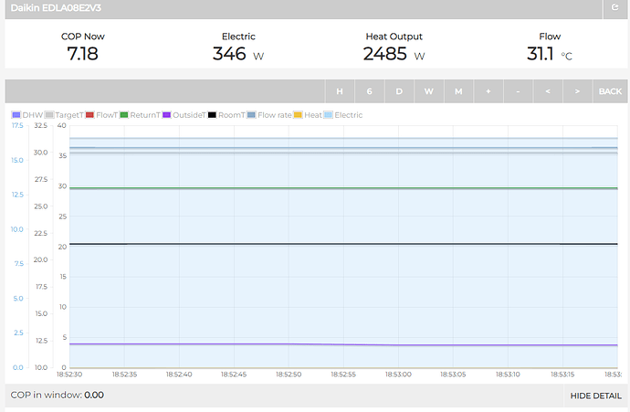

Here is the start of one of my heating cycles
And this is yours
There is no preheat in yours, it produces heat as soon as electricity is applied, even before.
All the others in this range of heat pumps are like mine.
And here is your pump running at 16lpm consuming 38w of electricity
And mine doing the same uses 75w
So if I assume you have a maximum of 20kW of radiators you are currently running at 31c flow and 26c return with a room temperature of 21.5c
That is a mean flow temperature of 28.5c and a dT between radiators and room of 7c.
But it will be less because of your pipe run, the flow at the house will be lower than at the heat pump.
At a dT of around 5c your radiators will put out 1,000w of heat.
You are producing about 2,500w of heat according to your data.
I suspect less than half of it, if it is even true, is going into your house.
That might explain why the heat pump can run when it is warm outside, why your house doesn’t overheat and how the return temperature remains under control.
I’m guessing you are heating your garden!
Looks to me like there’s some lag in the heat measurements of your system, as electrical power starts before heat and also stops earlier. Perhaps due to the distance between the compressor and the flow temp sensor, and the flow rate.
I.e. the heat power graph is shifted to the right.
This probably won’t affect overall COP.

Looking at last nights heating run, it appears to have pre-heated:
Hi Ali,
If your dT is set at 3c on the MMI then there is only one way the heat pump could be running at a dT of 5c and that would be if the circulation pump was running flat out and the radiators were still losing more than 3c.
I can’t think of any other way it could happen other than data issues.
How long is the pipe run and where does it go?
In simple terms this is what I think might be happening.
The water is leaving the heat pump at 31c and arrives at your house at 30c. It goes around your radiators at 30c and leaves the house at 27c but by the time it gets back to the heat pump the return has lost another 1c so arrives back at the heat pump at 26c.
You see a dT of 5c at the heat pump but in the house it is only actually 3c.
If you are producing 2,500w of heat at the time then something like 1,500w is going to the house and 1,000w is lost to the air outside.
It doesn’t take to much of a temperature loss on your pipe run on both the flow and return to make a massive difference.
Apart from any other issues, this is one of my problems with EspAltherma, it is not guaranteed to be measuring heat actually delivered to the home because the flow and return are not measured at the point of entry to the home.
Your actual temperature sensors look fine as they converge together with the pump running, the absolute values may not be 100% accurate but they are matched nicely it seems.
I also don’t see any issue with electricity most of the time. On the occasions when I have looked and seen similar conditions between your heat pump and mine, the electricity consumption for the heat produced at the same flow and outside temperature agree.
I think there is some issue with the electricity meter as the consumption with just the pump running is too low compared to all of the others.
But I think your big issue is losing temperature in the external pipe runs, the outside is acting like a big radiator and you are not delivering the heat to your house the data suggests.
It explains pretty much everything and fits with you radiator sizes.
