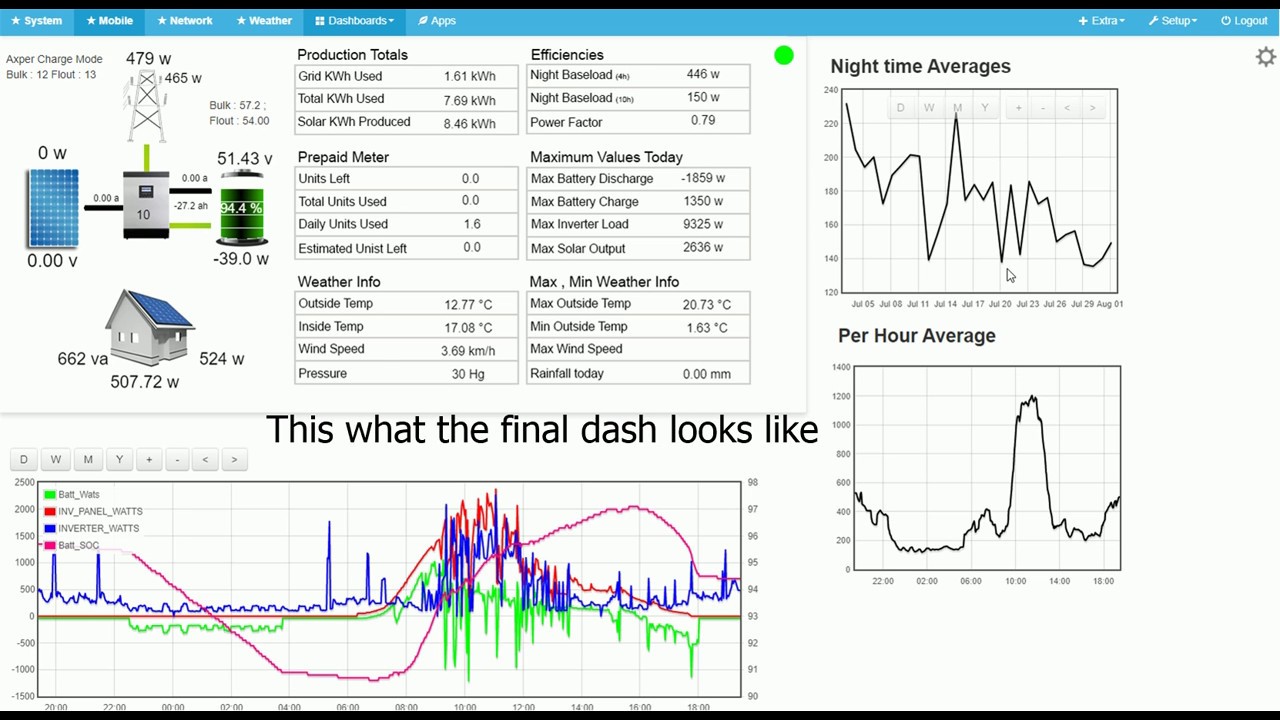

I used to have a couple of dashboards reporting PV power produced / Power used in house and surplus fed back into the grid.
So I wanted to make sure all is up to date in the administration Menu option and decided it is probably good to run an update on “emonPi” -
Gone are all my nice dials I used to have.
No matter what I tried after that, I am not able to get them to show up again. Am I just doing something wrong, OR was the dials etc removed in recent update 9.9.3 (The one I updated to)
Below is an example of such a dashboard reading my Axpert inverter and not the emonCMS, illustrating some of the info I would love to have back:
Below is a screenshot of the Toolbox how it used to be before; now the options are not there any more:
Can anyone perhaps give me some pointers how to get the dials and real time values back on the dashboards?

What have you tried? Have you tried clearing the browser cache?
What is listed now?
What is displayed now? (ie does it stay blank after ok’ing that box? and is it the same in “view” as “edit” mode?)
often when there is an issue rendering a single item on the dash, it can prevent all widgets after that point in the dashboard code, so looking at the dashboard code in the dashboard config box, which is the first item/widget missing or at fault? and are any of the widgets after that item displayed?

Allow me to take you step by step as I do it.
I am using chrome 71.0.3578.98 64 Bit.
I cleared ALL Clear history, cookies, cache, and more data.
Open URL “http://192.168.1.105/emoncms/dashboard
Log In with my administrator credentials
Set-up >Dashboards
Create a new Dashboard “Dials”, Alias “Dials”
Click on Eye button:
click OK
click on gear icon:
Click OK
Click on Toolbox gear:
Click save Changes
Click Spanner Icon
Only option that is accepted is Cancel.
That is where I am stuck
Hope this helps.
