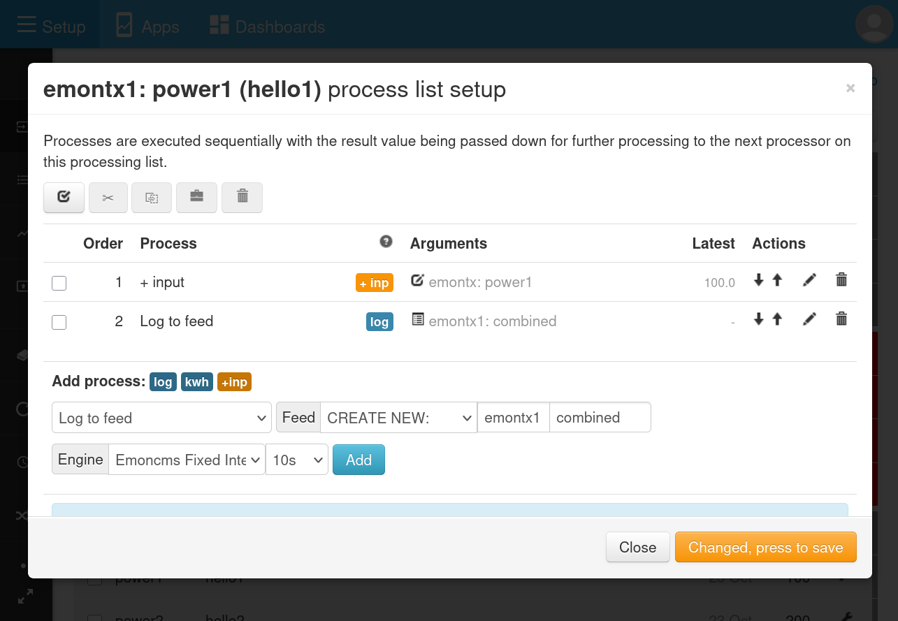

With 2 sets of solar panels each with CT, TX3 and RPi - how to add the solar outputs and present just one total in the Dashoard?
Hello @johnbanks I would usually use input processing for this. Something like:
If you have a lot of existing data, a quick solution is to use virtual feeds, but they have the limitation of not being able to calculate kWh data.
