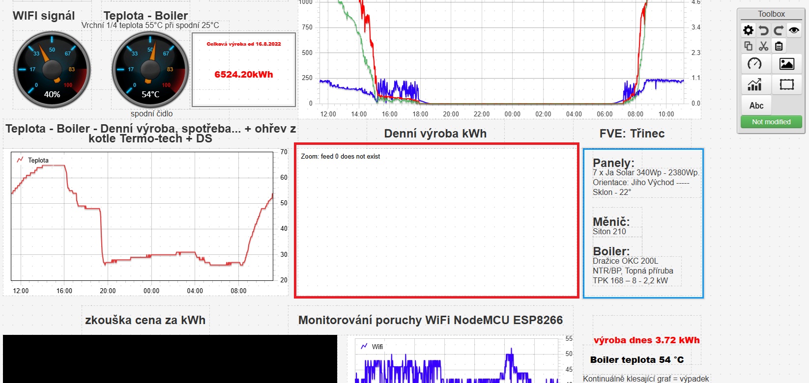

Daily production has stopped displaying.

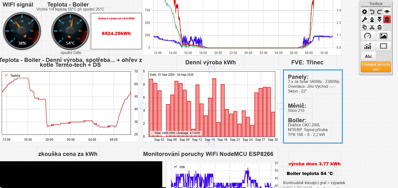

Hi there, I’m having a problem: the daily production data has stopped displaying. It says “FEED 0 does not exist.” If I edit the settings again, the data shows up correctly. It continues to display properly after saving, but once I reload the page, it indicates that the feed is unavailable again. I’m at a loss as to what to do. Has this happened to anyone else? It worked fine for three years, and now suddenly it’s not working.

I use emoncms.org. Thanks for the info about the updates; I thought I had accidentally overwritten something.
Pleased to say that the issue is now resolved. It was a bug in the way the dashboard handled chart feeds stored as tag:name rather than id, now fixed.
