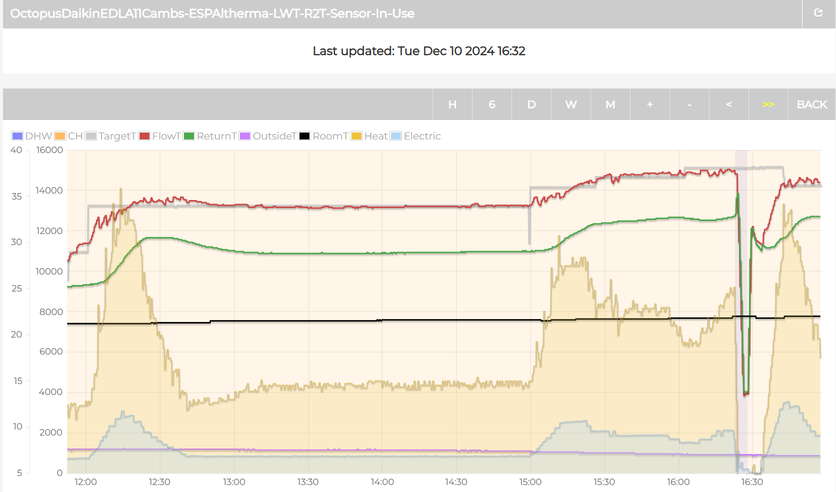

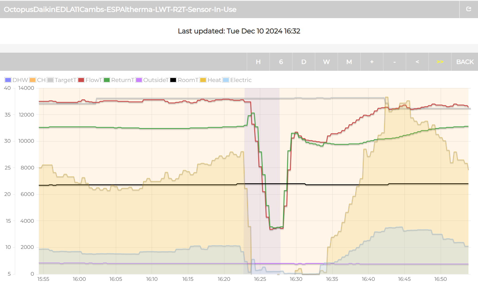

First defrost since changing from underfloor to fancoil emitters, no joy:
I had noticed this from time to time last year, and just noticed it happen as I was by chance, close by the 3 way ESBE valve, and could hear it move across yet I knew the hot water schedule was not set until tonight (set by our Mixergy cyclinder controller).
December 7th 2024 at approx 13:08
https://emoncms.org/app/view?name=9ChurchStreet&readkey=53fbf32311dcafcbf15209adc8e10c7f&mode=power&start=1733573990&end=1733577630
Has anyone figured out why this happens occasionally, and has anyone had a firmware update that resolves it?

Your flow temps are pretty low at the time it happened so I suspect that may be a factor.
For my system, think it uses the tank for the defrost when it is one of the periodic (every 6 hours or so of runtime?) “defrosts”, not a true low-temperature defrost.
It may also require a certain temperature in the tank, but I’m less sure of that.
Still, I’ve never seen a noticeable drop in tank temperature due to this
12 hours of compressor being on afaik looking at my summertime defrosts

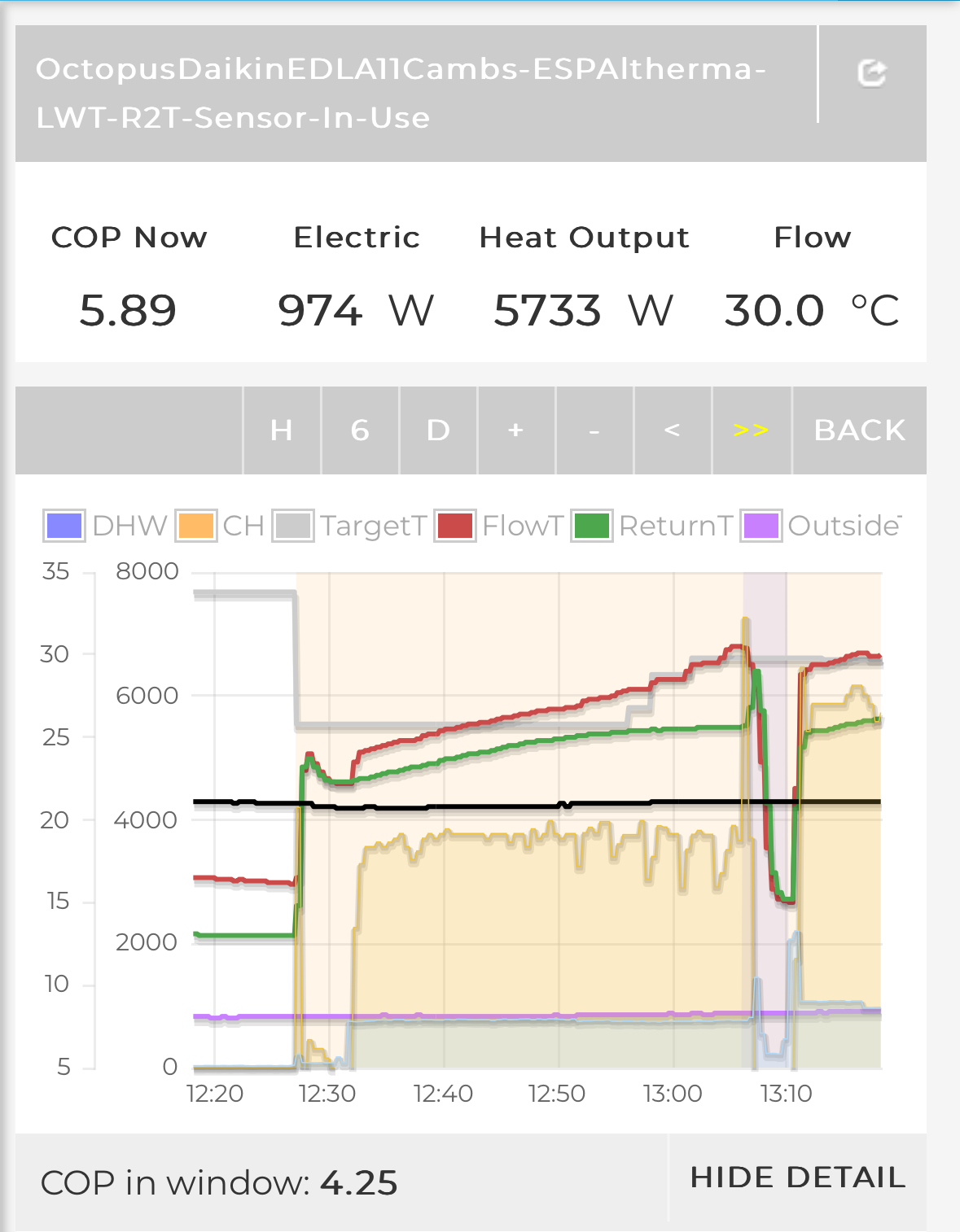

Yep, my system (EDLA11) has a “defrost” every 6 hours on the dot regardless if needed.
I have in the past seen tank temperature and State of Charge drop (I have a Mixergy tank so have a lot of data to show this) when the “defrost” switches source to DHW
@meatballs
I think we can put that hypothesis to bed!
Again, the “6 hour countdown timer based false defrost” switched to DHW mode, and weirdly shuts off for ~5min afterwards before coming back to start Space Heating again.
https://emoncms.org/app/view?name=9ChurchStreet&readkey=53fbf32311dcafcbf15209adc8e10c7f&mode=power&start=1733932510&end=1733936140
And for context, had been running for a fair while after being off from 05:30 to 11:30, and actually running “harder” than normal/needed from ~3pm in preparation for the Octopus Saving Session this evening at 6-7pm

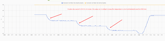

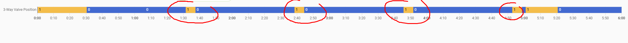

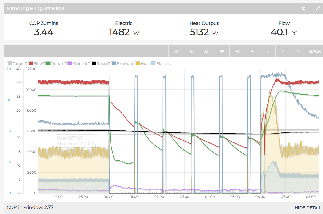

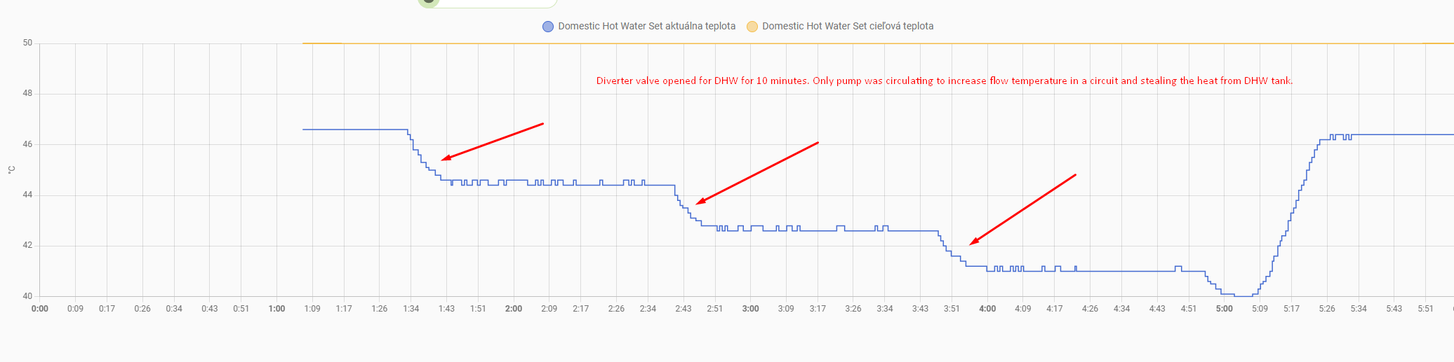

I can confirm this behavior of Samsung HP but it is not doing only at defrost cycles in case you have monoblok. It’s doing it also when the HP needs to increase return temperature e.b. in case there is cold outside around 0C to prevent water freezing outdoor unit.
Recently I’ve installed 280L DHW tank and noticed this behavior. From midnight to 6.a.m I usually turn of the pump with termostat by lowering target temperature by 2C. It usually lasts until morning without single start of a compressor. Before I had a DHW tank you may see that the pump simply run pump for around 5 minutes without starting compressor. What happened was that flow temperature decreases slightly and return increased which ensured the water will not freeze. The flow temperature drop is marginal.
What I’ve noticed with DHW tank installed is simply stupid. When the pump wants to increase return temp to prevent freezing for some unknown reason it explicitly switch 3-way valve to DHW and steal water from a tank !! Why. In my opinion this is not necessary at all. Without DHW tank it didn’t have such possibility and only decrease water in radiators slightly.
With DHW installed this happening. During a night it was 1.6C on average and the pump stole heat from the tank 4x (each run of the pump exactly 6 minutes) until it dropped to 40C and reheat to 50 started. In the morning it took 6.4C from the water tank! The return temperature still dropped by 10C so not sure what is this good for. What is the benefit in comparison with scenario without DHW tank I’ve posted earlier.
It’s pretty strange it is doing this with DHW installed. It’s even not a defrost cycle. I’m yet to observe full defrost cycle with DHW installed but I’m trying to understand this behavior. I would rather keep it as it was to use circulating water from space heating circuit than stealing heat from DHW tank. It’s not made for that lol.
I experience the same problem with the Samsung monoblock AE080RXYDEG. I wish there was a way round it. Samsung technical advised that there were no plans to update the software. They suggested wiring in a 5 minute delay to the divert valve so that the defrost cycle completes before it switches over. I’m not convinced this is the best solution, but it’s an idea.
