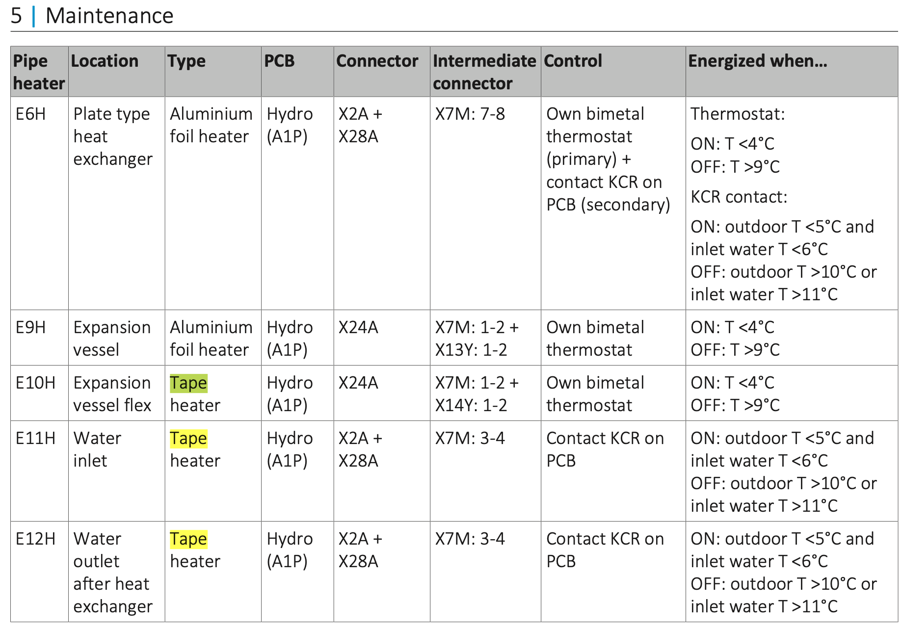

I also have a high standby current from my Altherma 3M Edla09 Monoblock.
Normally it is around 23Watt. Now since a few days around 70 Watt!
Heatpump is off, no hot water production with the heat pump, no heating, no cooling.
I don’t have backup heaters connected to the grid.
Anyone an idea?

It might be worth looking at those tape heaters on the heat exchanger in/out etc. They are about 33W each, and might be triggered by some wacky alignment of settings and ambient values? You can’t really check without taking the cover off unfortunately, I don’t think there’s any instrumentation. And yes, I’m clutching at straws, but there has to be some reason for the change.

The service manual shows the above heaters - it seems unlikely that any of the ON conditions are satisfied, but maybe the W values might be useful clues. Note that the standard setting for the EDLA09-16 is for E11H and E12H to be jumpered ON when the pump is running, so who knows what the side-effects of that might be!
