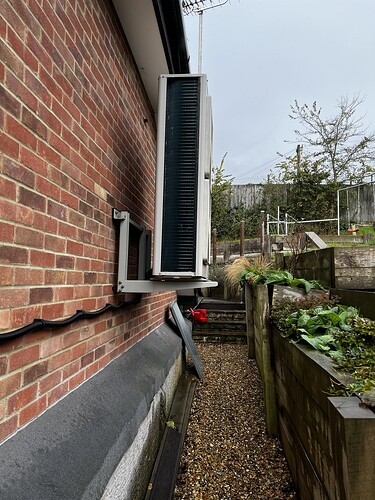

Continuous and sample are a different thing, looking at the leaving water temperature. I am looking at the frost protection settings that run the circulation pump to stop the outdoor pipework and unit freezing if it’s not in operation.
My heat pump wasn’t needed through lots of the day today but because the ambient outside temp was around 9C, the heat pump has been circulating water to stop things freezing up. A little unnecessary at that ambient temp, so I’d prefer to stop this threshold a bit.

If the system is in a state that would be able to turn on the pump in order to avoid freezing pipes, at that same temperature, 99.99% chance the system is in the state where it runs in heating mode 24/7
And if not the anti freeze valves save the plate.
If it were installed eurostyle (high enough off the ground to be clear of leaves and snow) then it would also thermosyhpon hotter water from the house into the outdoor unit and flush the cold back into the house when the pump isn’t running and the outdoor unit is at leas than 20C.

@marko I am definitely clear of leaves and snow!
