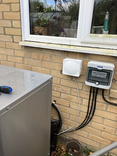

Here is the IP rated enclosure via stranded CAT 5 cable
Nice job! I used a box that the Octopus sparky gave me to clear his van out…
Love the idea of having it outside the main casing but just be careful with the cat5e as that looks like the internal stuff and it will degrade with exposure to UV over time.
Hey, it should last a couple of years at least and it’s not like it’s more than 5V, so minimal risk if it gets a bit brittle, and easy to change.

I got my ESPAltherma connected to Home Assistant at the weekend, with a WiFi repeater in an IP66 enclosure near the heat pump and the M5Stick inside the same box.
